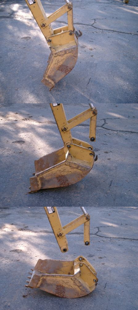

I too have struggled with ripping roots with my backhoe bucket. I considered trying to fabricate a ripper tooth, but since Struck Corp makes one for my Magnatrac tractor I figured it would be easier for me to just buy the one that they make. We got some good weather today so I had a chance to put it together and mount it on the backhoe. Attached are a few pix. I didn't get a chance to play with it yet, but I'll report on how it works after I get to use it some.
Here's the bucket coming off. Its not too heavy (I can pick it up). A couple of minutes.
John

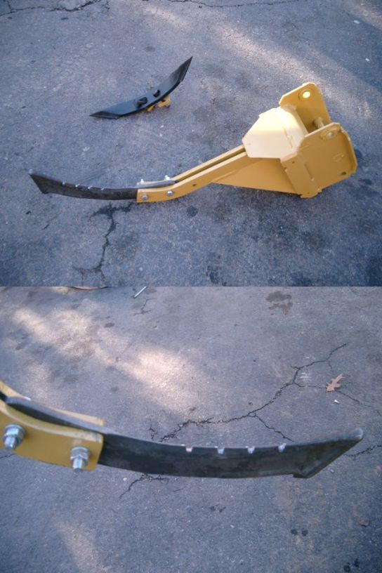

Here's a pic of the ripper tooth. You can see that it is basically a holder that mounts on the backhoe and a bolt on tooth. Actually it comes with two teeth one is a serrated slicer type of plow tooth and the other is a curved plow ripper. I've selected the serrated blade for my first tests of the new "weapon" /forums/images/graemlins/wink.gif
John

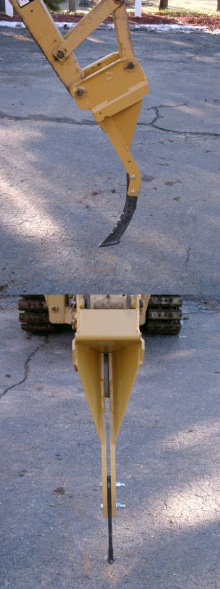

Here is a pic of the ripper tooth going on the backhoe. Its lighter than the bucket so its pretty easy to get it up and pinned on. Again only took a couple of minutes.
Ready for action /forums/images/graemlins/smile.gif
