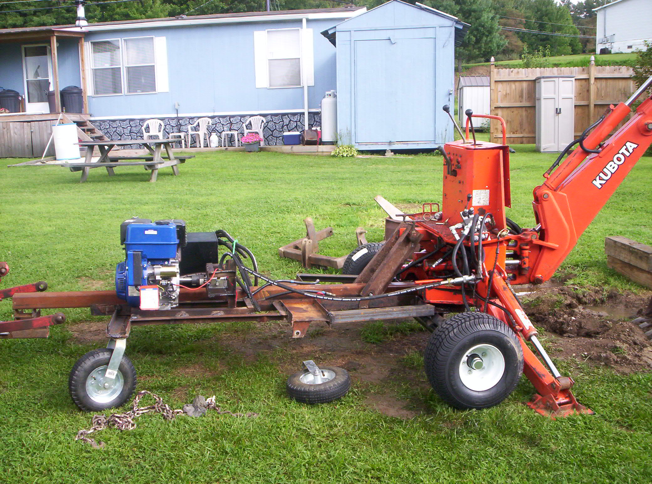

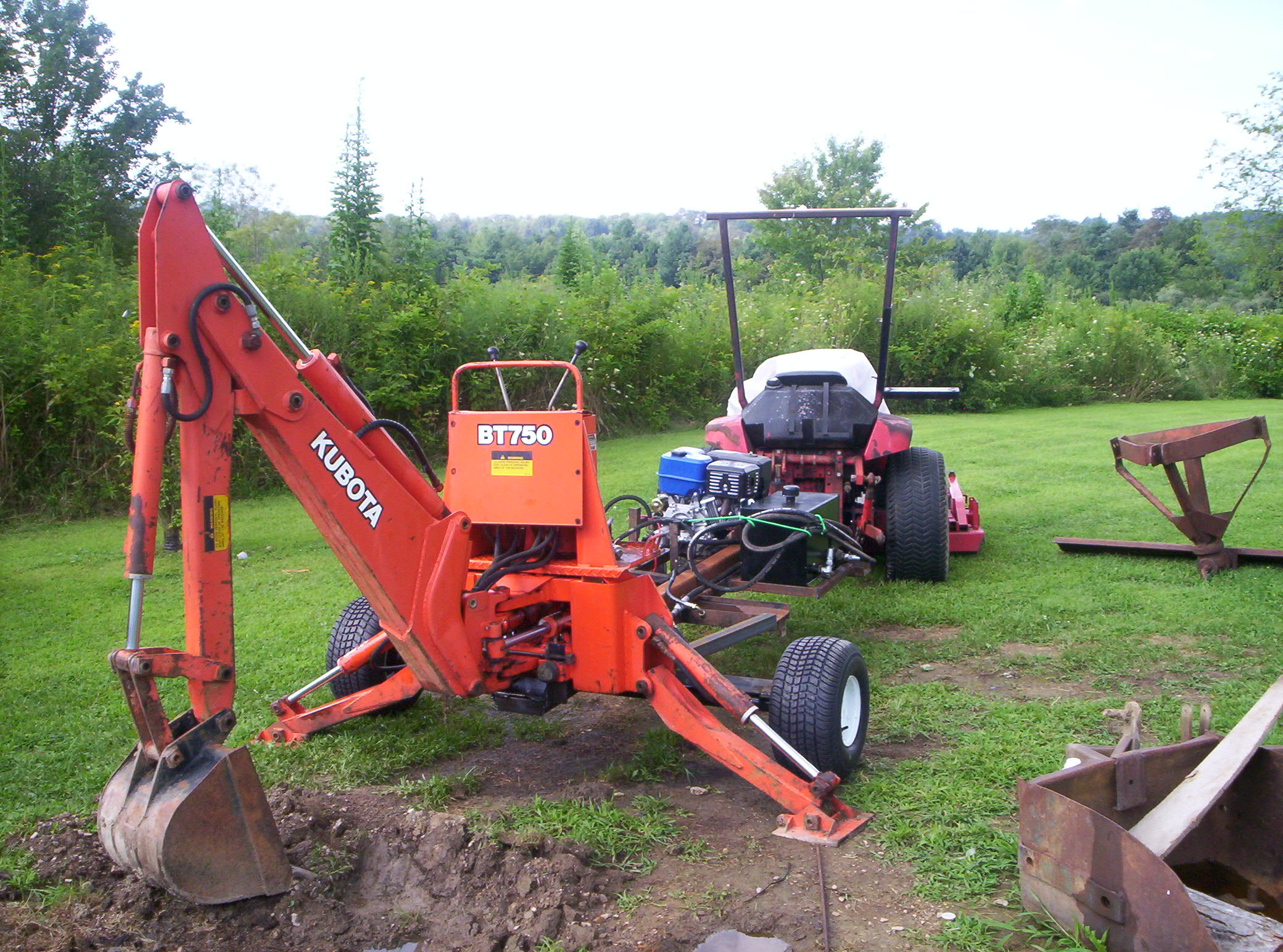

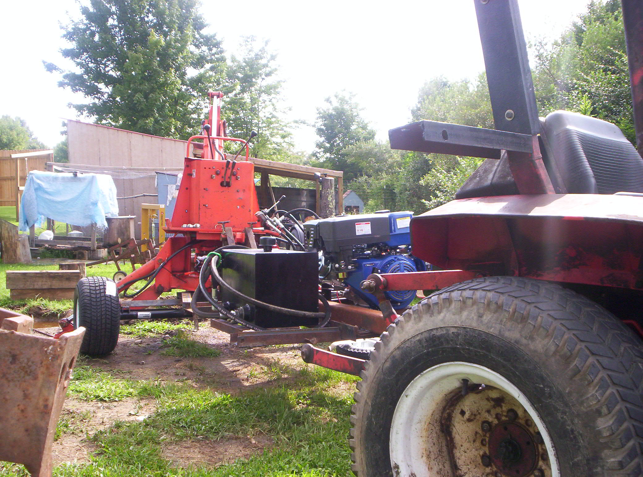

I have been working on a towable back hoe project myself for the last month or so, in my spare time which I have less and less. I will try and attach some pics I took today. But, your exactly right about the cost and time. I spent the last 3 saturdays putting this thing togather and it is no where close to finished. Right now I am trying to get all the hydraulics working good, then I'll have to make some adjustments on the rear wheels, seat frame, floor, re route hoses, make engine cover when not in use, then grind, paint.

Ok, this is my first try at adding the pics, so if they do not show go easy on me.

They sent just fine!:thumbsup: Nice adaptation of an existing backhoe to a tow-able setup.

I have an old Kubota backhoe that fits neither of my tractors' three-points. I was considering setting up a frame mount and not liking the idea of all the work it was looking like. That towable rig was all the inspiration I needed. That's the ticket for me. I'm doing that right after my next visit to the Spare Time Locker.
