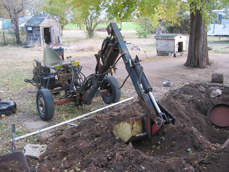

Thanks everyone for the encouragement. After getting it tore down and thinking about it some more. I decided to keep going with this project. But I'm not gonna work on it probably until spring, I should be able to purchase the necessary material by then.
I'm gonna also get me a chop saw so I can cut the material a lot easier. And a better drill press.
The renting of a mini ex is out of the question now. Seeing as the rental place went out of business just a few days ago. And the rest of the places to rent from require a credit card which I don't have.
So it's either dig the trench by hand, or get this backhoe built and going. And I choose the backhoe over digging by hand.
I figured up the cost and should be able to get it built right with the proper material for at least another $1,000.00 which would bring the project to $2,000.00 which is still cheaper than purchasing one already made.
So as I get the money, I'll probably order the materials a little at a time and put them back until I have everything to start the build with.

I don't have any plans bought yet. Not sure if I will buy any plans or just wing it. "Probably just wing it".
The cylinders I currently have won't work on any smaller tubing for the boom and stick. And seeing as I already have the stick and boom made up. I think I'll just use them and build the frame strong enough to support it.
I'm gonna shorten the boom and stick just a bit and maybe even curve the boom.
Hopefully by next summer I'll have all the materials gathered and can go to work on it.
For now, I've stored the hoses, cylinders and valve in the shop.

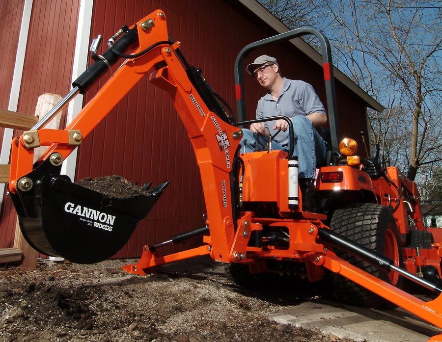

Here is a picture for you chad. Study it well and follow its design and you will have a great backhoe.
Just remember in order to shorten the boom you need to overlap the cylinders mounting point . Look at the picture and the boom mounting casting on it is about 1/2" to 5/8" thick in places and its boom is about 4'. So if you leave yours 6' just think how thick that would have to be!!!
