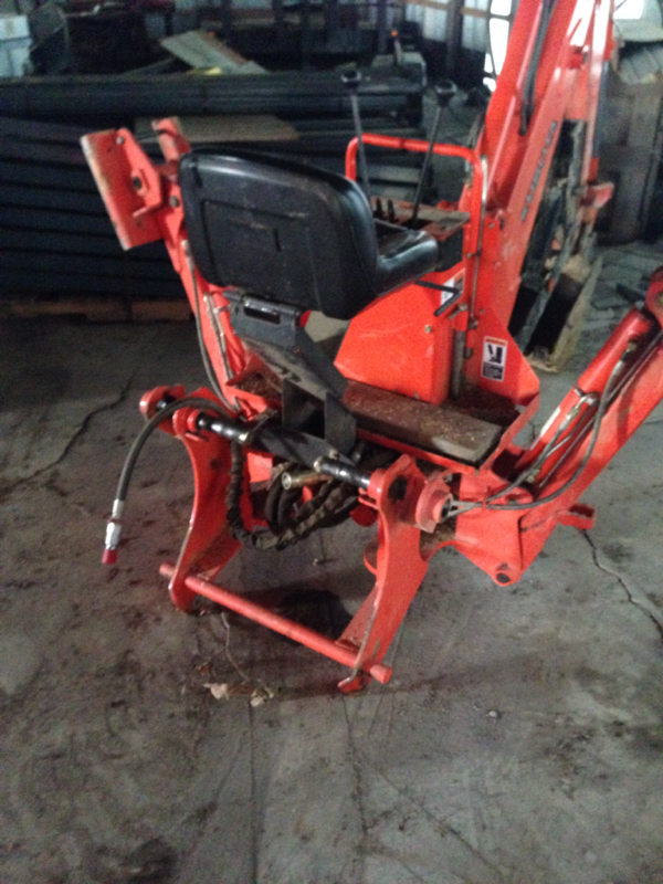

I am looking into put a 3 pt hitch backhoe with pto hydraulic pump on a Kubota L2501 but my dealer said i need a subframe is there anyway around putting a subframe on cause once i am finished 1 part i want to hook up box scrape to level up the ground. What type of backhoe could i used so i don't tear up anything and still be able to unhook quickly and get back to scraping the ground thanks
/ Backhoe #2
A subframe is by far the better of the two. The make 3point backhoes or at least they used to. I can unhook my backhoe and re hook it in under 10 minutes. When I timed it it was closer to 7 minutes. That was without hooking and unhooking the 3 point arms. Add in another 10 minutes to do that and the time still isn't that bad.

I would think the subframe would be easier to take on and off than the 3 point. I can drop mine in 2 to 3 min and install in about 10 -15 min. The 3 points normally have extra bracing and pump hookup to to deal with.
/ Backhoe #6
My opinion is sub frame or nothing!! I searched a lot before I bought my backhoe and saw plenty of broken tractors. Had the privilege of seeing a JD 790 broken in half at the bell housing with a Woods BH 7500 mounted on 3pt. You have the same frame tractor as mine (L3700SU) and dad's L3800HST) we both have the sub frames and one BH77. I agree with the others 10 minutes flat you can change from hoe to lift arms.
/ Backhoe #7
Why do you want a 3pt backhoe instead of a sub frame mount?
/ Backhoe #8
As the others say, having the subframe type backhoe does not prevent you from dropping the backhoe and putting a 3 point implement on the tractor; it is a pretty straightforward changeover that doesn't take a lot of time or work. I regularly switch between backhoe and box blade for dirt work on my tractor.
The thing is, the 3 point mounts are intended for implements that are pulled and are designed to raise and lower. You don't want to do any of those things with a backhoe... you want it mounted as securely as possible to the tractor and you want to keep the extreme forces from the backhoe from bending or breaking the tractor. So trying to use the 3 point linkages to hold a backhoe is basically a patch job. A 3 point backhoe is fine for light duty work, but it's far from a perfect (or even good), way to mount a backhoe. Kubota stopped offering a 3 point type backhoe for that reason.
Your dealer is right, but you needn't worry about not being able to use other attachments just because of the subframe.

I have a regular backhoe (Case Super E) but from what I have seen, the 3pt hoes are more for bigger tractors with heavy lift arms. The Kubota subframe system is very nice and does come off/ on in a few minutes.

I had an old Woods 3 pt mount backhoe on my L3010. It took FAR longer to remove it than the sub frame mounted BH92 on my MX5800. The pin alignment would shift on the bracing after each use and make installation / removal difficult. After several bent pins and twisted linkage, I discovered what others here have said. A 3 pt hoe is NOT for heavy duty work. My advice is get a subframe mounted hoe. The time factor doesn't exist.

My 9' Woods BH w/ subframe mount connects to the rear axle using a mounting piece that replaces the 3pt arms, changing from BH to 3pt requires putting the 3pt arms back in place. That IS the least of the worries when putting on or taking off the backhoe (or "doing the nasty", as I call it). Don't know about the newer ones - they seem to have been re-engineered to be much less of a nightmare to mount/dismount sometime over the past 20 years.
That being said, my backhoe can fling my L4200 around like so much tissue paper. I can't imagine that it would survive very long with a 3pt mount.

That's bad information. The subframe type of BH is actually easier to hook up than the 3 point type.
/ Backhoe #17
I heard that it takes a long time to hook up and i want to be able to change from backhoe to landscape rake to box blade rather quickly to clean up my land where i want to build a home on
Well, whomever you heard it from didn't know what they were talking about, 99.9% of sub frame backhoes can be removed in under 5 min., then all you have to do is put the 3pt arms on and go.
