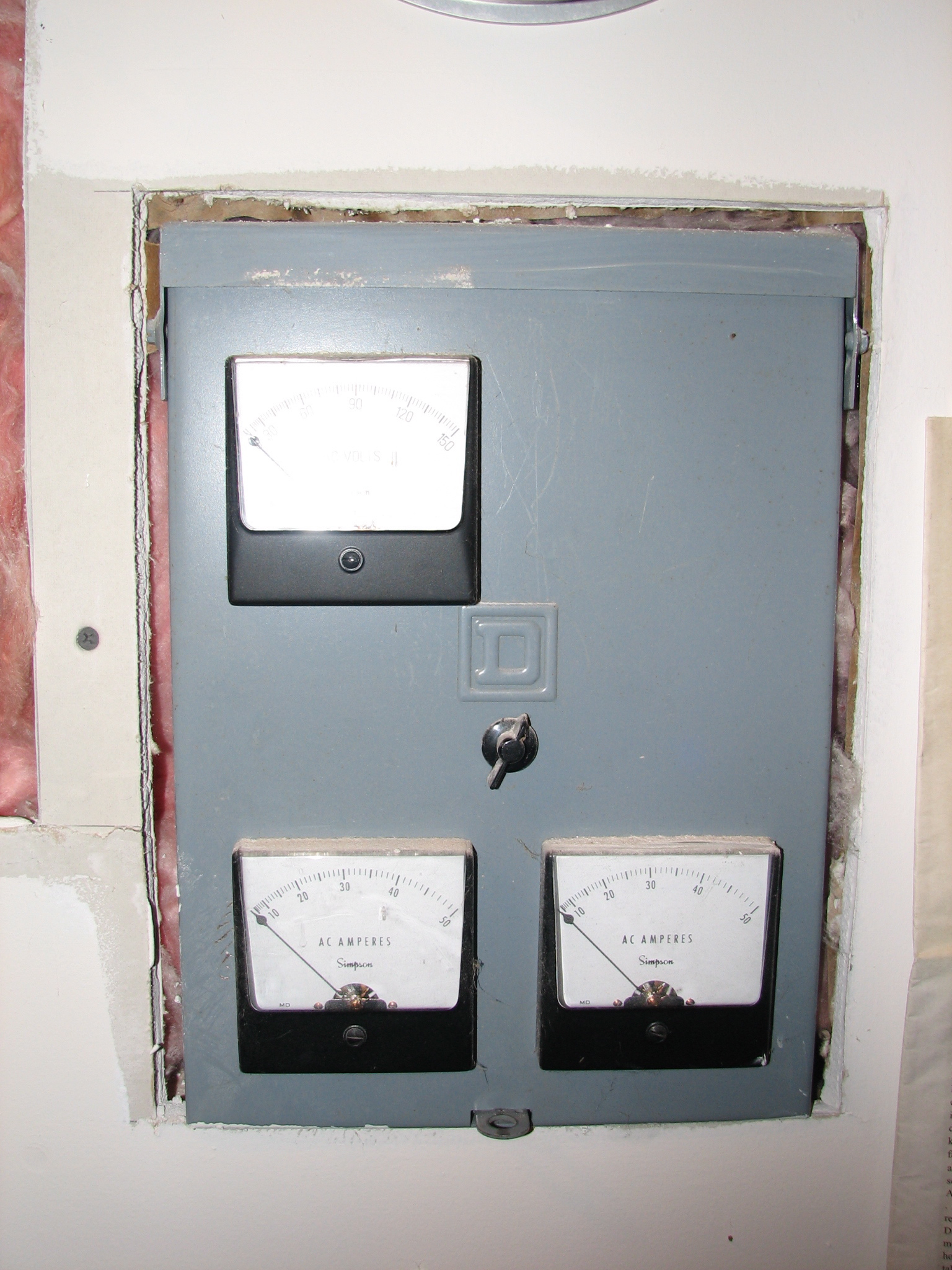

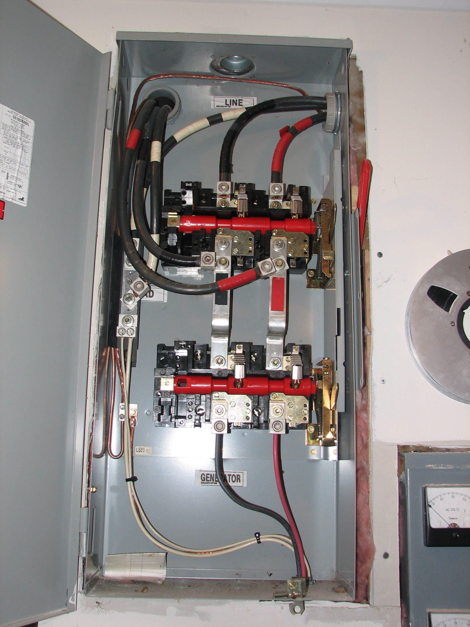

I read up on the Dynagen and Deep Sea genset controllers. Have to have a degree in computer science and another in electrical engineering. Plus another bucket of money. I plan to stick with the manual transfer I already have, and maybe add analog gauges for oil pressure, water temperature, RPM.
Am also giving some thought to configuration of a breaker and outlet panel for the alternator.

Here's my set up.....
shop - 116.jpgshop - 120.jpgshop - 122.jpgshop - 125.jpgshop - 116.jpgshop - 120.jpgshop - 122.jpgshop - 125.jpg
