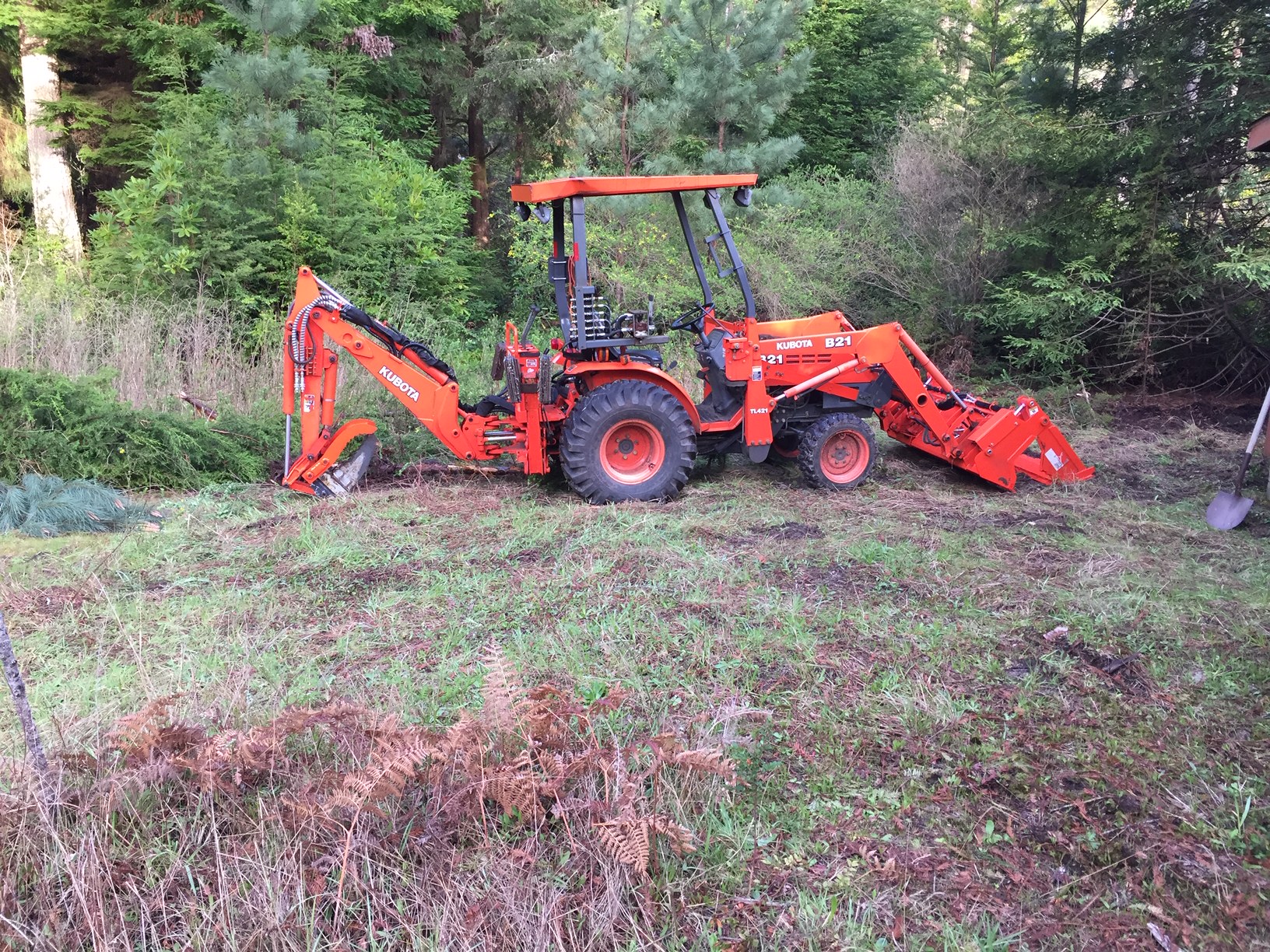

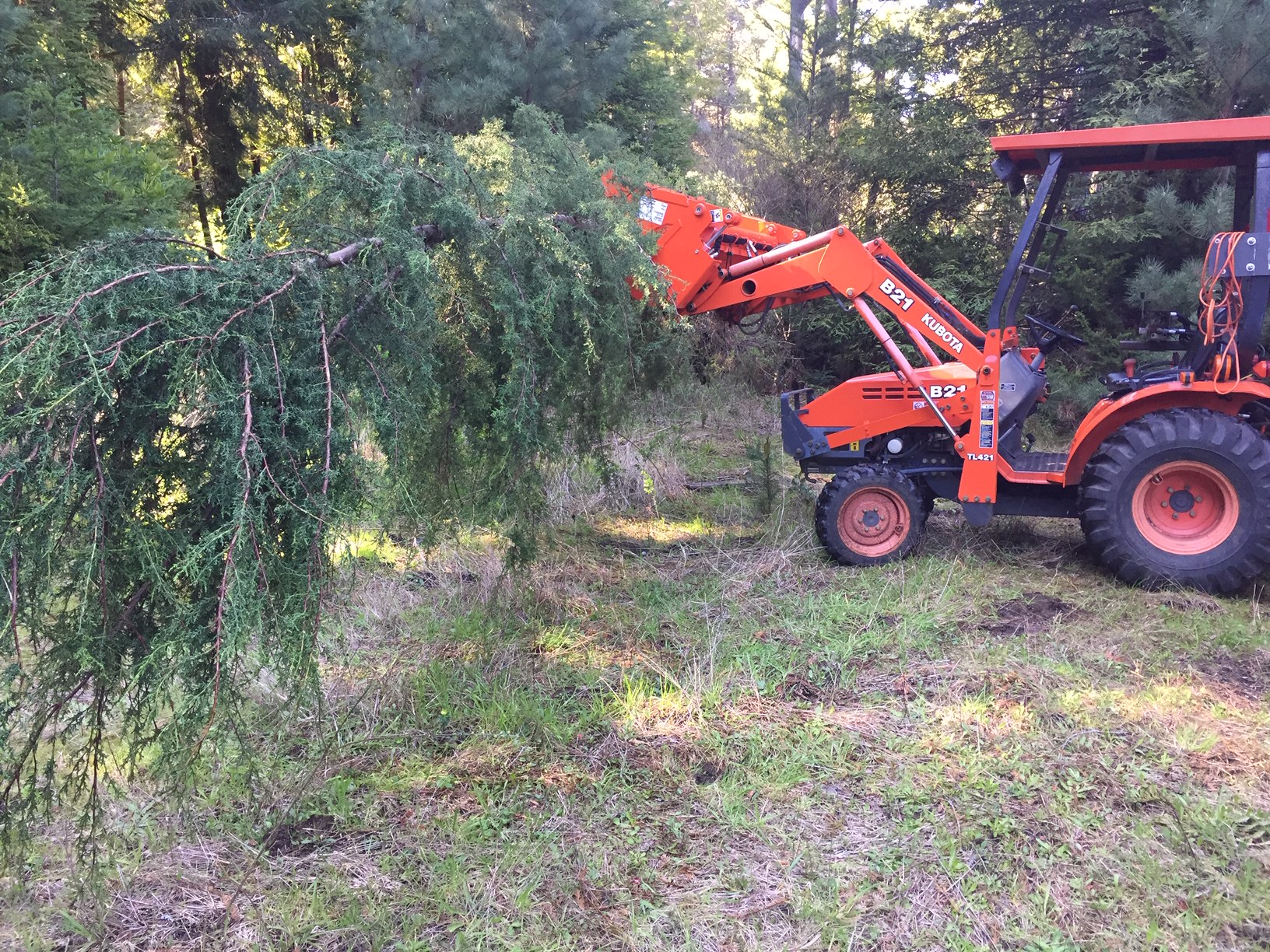

The rain finally stopped. At least for a couple days. I am putting the generator shed in place of some forest that was about to take over the workshop anyway.
When done I will do a post on the generator shed.
