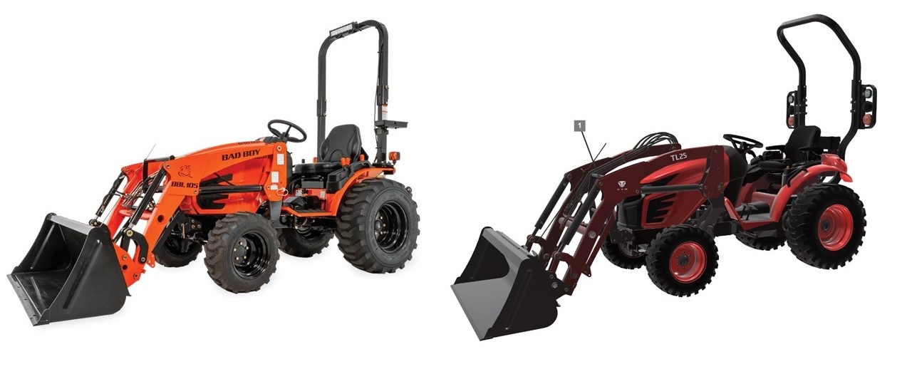

I see. Never knew some other brands had SO many models and still calling them subcompacts. As you guys have stated, looks like the Bad Boy 1025 and the TYM T25 are similar. I would think that Yanmar engine would be more desirable.
/ Bad Boy Tractors.... #19
Look at specs, not so much pictures...
A couple of quick differences that tell me they are not the same... HP is slightly different, they should match. Fuel tank is very different. 6.6 gal on the T25, only 5.8 on the 1025. It is much more likely a T254. Same fuel tank size, same weight. Some differences will be rounding and such. 99% sure the 1025 BB is not a T25.
If pictures help...this is a T254
