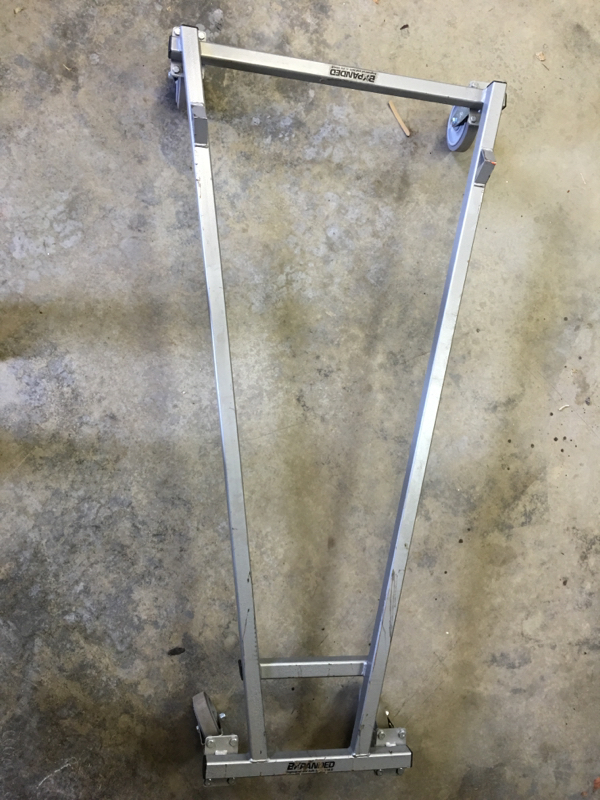

Finally found the approximate COG, and heavy duty steel wheels at TSC.
Today I wrapped a 7,000 pound loop ended tow strap under the pivot pin area on the hoe, and then toward each stabilizer piston, between it and the station then under the boom cylinder and up to wrap around my pallet forks. I also used a 3" ratchet strap under the center cross support then up to the cross bar on the pallet fork structure. This arrangement seems to allow me to pickup the entire hoe, VERY Carefully, and without any sharp turns move forward or backward with my Woods 6' Brush Hog on the 3PH for adequate ballast.
I was able to put the entire hoe and subframe on the concrete floor of my boat bay. Good enough for now.
Meantime I now have 4 steel swivel wheels from TSC, that have grease fittings on the swivel plate AND the wheel's bearing(s). These should allow for more support, 700#s each wheel, and much easier rolling ability when I complete my platform reconstruction.
