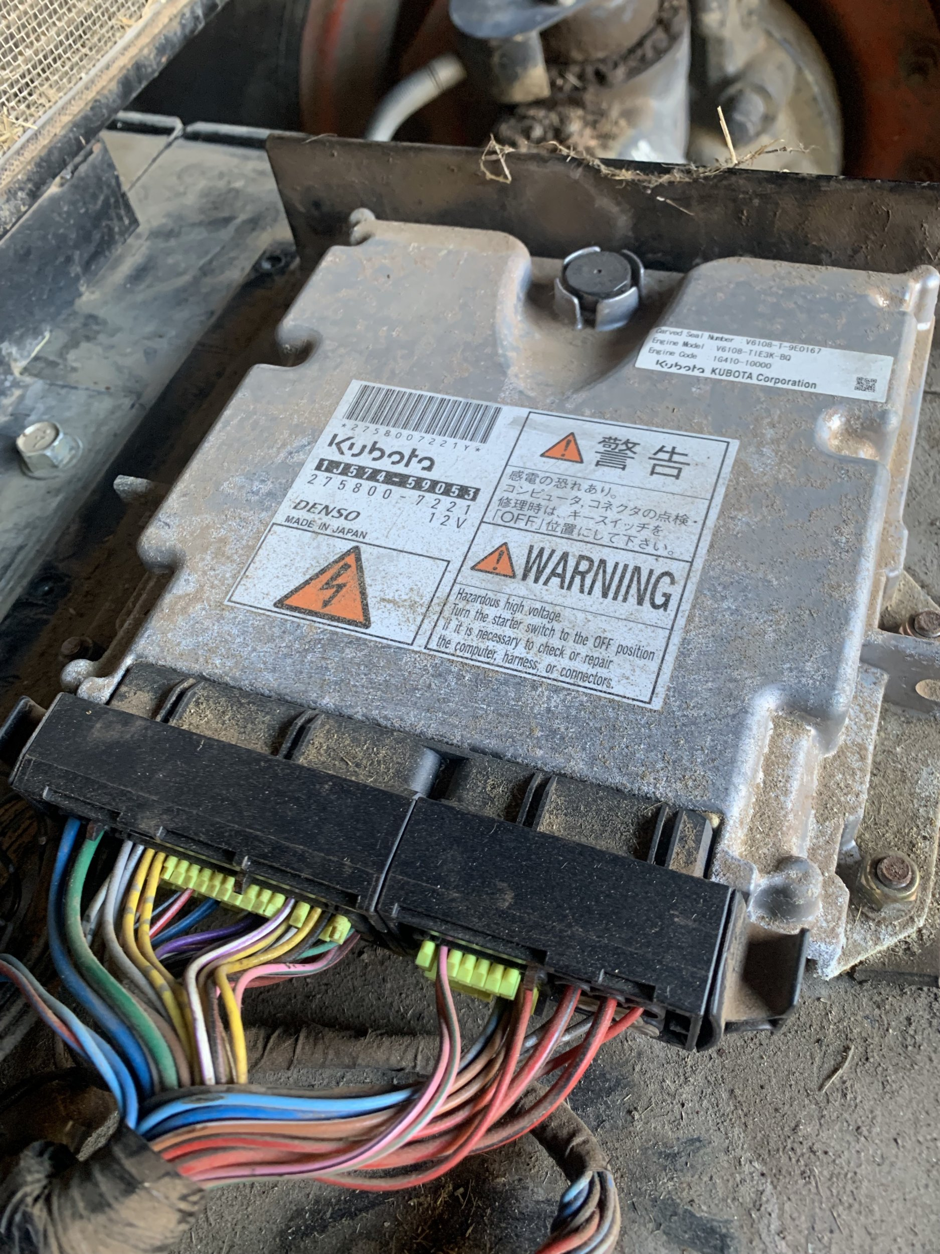

The ECU reads the air and water temp sensors and they are both part of the glow plug wiring circuit and it has been stated that if the relays are bypassed, the tractor derates itself.
So how do you bypass all that and “simply install a switch”?
So, don't bypass them. Leave them in place, just disconnect the "last inch" that puts power to the glow plugs. Probably just a "buss bar" connects them all together and one end goes to the "magic box".
Then connect your own power to the plugs, as others have said, heat and crank.
BTW, who "has stated" it de-rates itself? Kubota or is that an "urban legend"?

Purchased my M135X in warmer months almost 3 years ago (April 2019). Never thought to see if the glow plugs worked. They actually won’t work if it’s over 41*.
Last winter, I realized the glow plugs weren’t working. Ohmed out wires, looked at wiring for mice damage, water damage, bad grounds, etc. Ohmed out wiring. Thats when I learned the glow plug system in larger kubotas is more complex than I thought. All 4 glow plugs passed electrical testing.
The glow plugs have 2 sensors one for air temp, one for water temp. The ignition switch is also part of the circuit. Then there are 2 relays and a fuse. All of this is controlled by the ECU. Last winter, I replaced
Key switch
water temp sensor
air temp sensor
both relays
fuse
Still no glow plugs. With nothing left to replace or test, I succumbed to a very reputable Kubota dealer. They basically did all the same things I did and replaced one of the new sensors I had already placed.
Still nothing. They called Kubotas double secret probation hotline and Kubota thinks it’s the ECU.
ECU price $6000 :(
ECU Not returnable and no guarantee it will fix glow plugs.
So I’m out of answers. Any thoughts on other possible avenues to pursue

I don’t think it’s that simple, but yes, the thought crossed my mind. They make timer switches too, so you can’t accidentally leave them on.
The sensors must stay in place. We tried to bypass the sensors and if you bypass them, the engine runs de-rated.
I'm no mechanic, but FYI, I had a little John Deere 670 and the ignition switch rotated both directions. I'd rotate the key to the left for 10 seconds or so to warm the glow plugs then rotate to the right to activate the starter motor. That system worked great. Seems that the suggestions being made about a simple switch to activate the glow plugs would work the same way.
