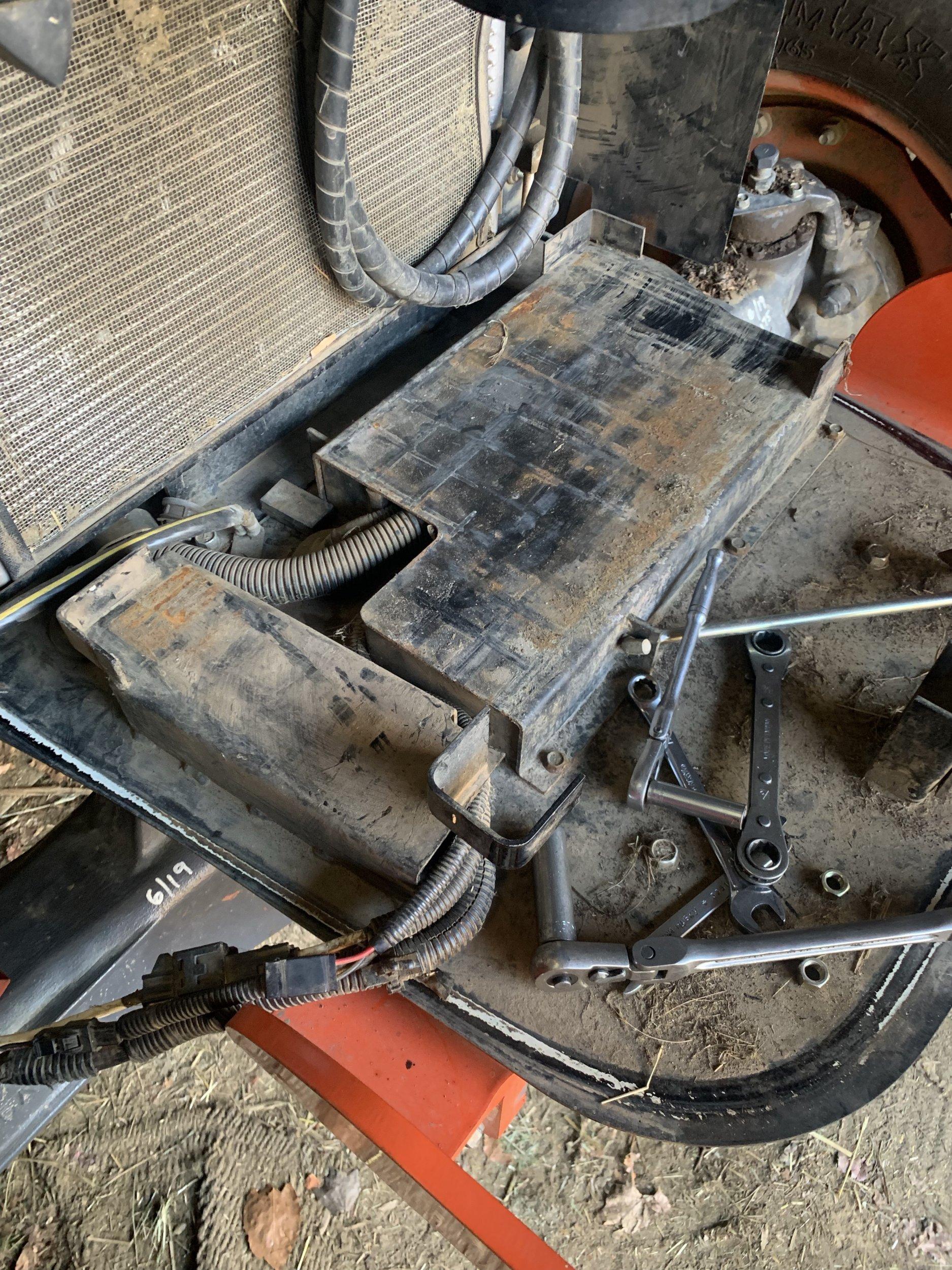

Purchased my M135X in warmer months almost 3 years ago (April 2019). Never thought to see if the glow plugs worked. They actually won’t work if it’s over 41*.
Last winter, I realized the glow plugs weren’t working. Ohmed out wires, looked at wiring for mice damage, water damage, bad grounds, etc. Ohmed out wiring. Thats when I learned the glow plug system in larger kubotas is more complex than I thought. All 4 glow plugs passed electrical testing.
The glow plugs have 2 sensors one for air temp, one for water temp. The ignition switch is also part of the circuit. Then there are 2 relays and a fuse. All of this is controlled by the ECU. Last winter, I replaced
Key switch
water temp sensor
air temp sensor
both relays
fuse
Still no glow plugs. With nothing left to replace or test, I succumbed to a very reputable Kubota dealer. They basically did all the same things I did and replaced one of the new sensors I had already placed.
Still nothing. They called Kubotas double secret probation hotline and Kubota thinks it’s the ECU.
ECU price $6000 :(
ECU Not returnable and no guarantee it will fix glow plugs.
So I’m out of answers. Any thoughts on other possible avenues to pursue?
I have a L6060 with 360 hours and no problems so far. I also have a Cub Cadet SS7360 36HP 4cyl diesel that the glow plugs never worked even after replacing all components related to the glow plus system. I installed a manually activated system from the battery to the plugs with a 40 amp fuse. I turn on the manual switch for 7 seconds and have not had a problem since and it starts in very cold weather within 3 cranks but usually on the first one.
   / Bad news big repair #123
to overcome the the ECU derating the motor because the sensors are derated the easiest way would be to find a used glow plug and plug it into the ECU while the glow plug that is actually in the motor is run off a manual switch, if you were really tricky you could figure out what the resistance of the sensor is and just wire in the a resistor so the computer thinks there is a glow plug there. me I would just find another glow plug and it in, actually I would just suck it up and pay for the ECU, or just keep running it the way it is, maybe put a block heater in it to help out on the cold days.
