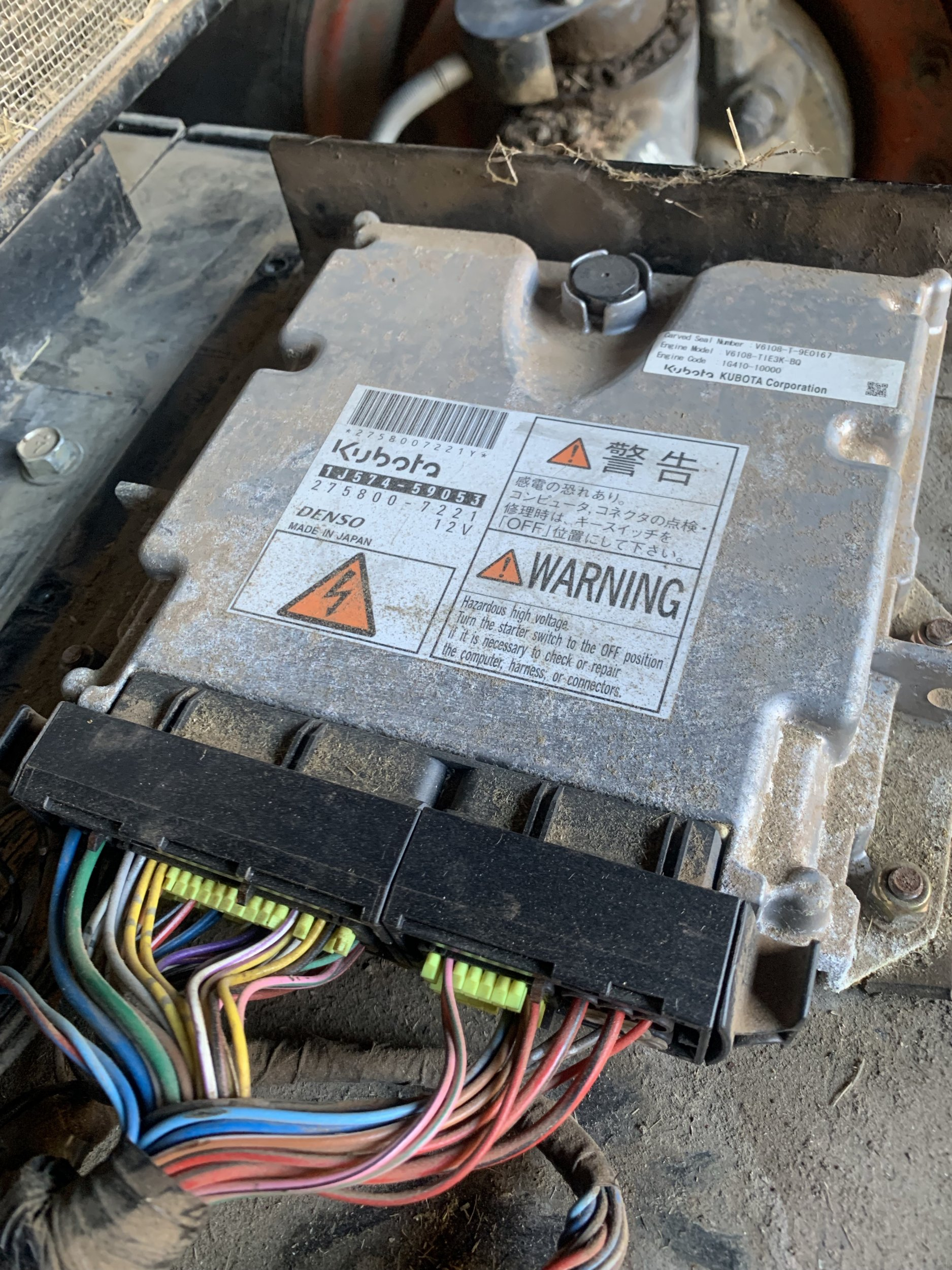

Heres the ECU. Checked connections for moisture or corrosion. That looked ok. There was some, but not enough for alarm. Moving to check a few other things tomorrow

start at the relay.... it will tell you which way to head.

Yeah I already did all that. Last thing was to check the ECU plug/harness for anything. It looks good.
Gotta be cold for plugs to operate. 54* today.

Look real close at every connector in those harnesses (if you knew which wire then one could concentrate on just that one, but...). Further, examine each wire within an inch or so of the connector. I had my cabin fan stop working on my NX a couple of summers ago (right in the middle of a hot day and with a lot of mowing to do; AND, with mouse stench permeating the cabin! [I suspected that mice might have chewed wires but that turned out not to be the case]). I troubleshot the holy heck out of it and just couldn't figure out why the fan wasn't working. While scratching my head and wondering what the next step was I was kind of desperate and had the fan powered up and then started wiggling wires (and burning incense). Lo and behold, the squirrel cage on the fan started spinning! It was a bad wire, a factory defect! At the factory someone bent the wire (within 1/2" of the connector) such that it broke enough strands in the wire to work for a few years and then decide to stop working. The wire didn't look like it was a problem, just had a definite short bend in it. And for some reason when I disconnected the connector and probed it for power it showed that it was fine!
I would also look closely at the wires as they go into/out of the relay(s): I'm thinking that this would be the most likely place for such an occurrence ass the wire bundles to the ECU tend to be handled more gingerly (the group of wires together tend to kind of protect the individual wires).

Diesel Bound, I will keep checking. It’s tedious and it pretty much requires two people and it to be cold for them to actually work. Yes you can look at wires relays, etc alone in a warm shop, but the OEM glow plugs won’t work unless it’s cold. You also need a second person to keep the switch in the GP position to perform some of the tests.
Takes away from time at work for 1-2 people. Time is something which I have little of.

Clean up all your grounding spots too, a poor ground can do strange things !
