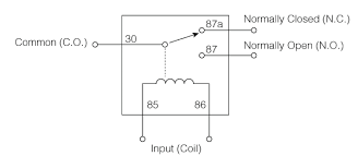

Umm... exactly where a
I’m getting .58 volts from ECU to the GP relay right now. It’s 30 degrees. Problem is, I don’t know what voltage I should be getting from ECU?
Where are you measuring the .58 volts..... On a typical relay there should be 12 volts on one side of coil (85?) and to operate relay other side of coil needs a ground (86?)... If the operate path from ECU is at .58 volts it would appear to be providing a ground to operate relay... OR it could be you are missing the 12 volts on input voltage side of relay or a open winding in relay.....
Typically most automotive (yes tractors too) use a really basic relay as in image below...
Applying 12 volts and ground to 85 and 86 should cause rely to operate and switching "common" contact from "normally closed" to
"normally open" ...You need to be measuring voltage(s) on both sides of relay input (coil)..
In the case of putting power to glow plugs I would guess (no wiring diagram to reference) that you should see 12 volts on "common" (30) and wire to glow plugs on "normally open" (87) ...
Good quality relay should have a diagram of how it operates stamped into case...

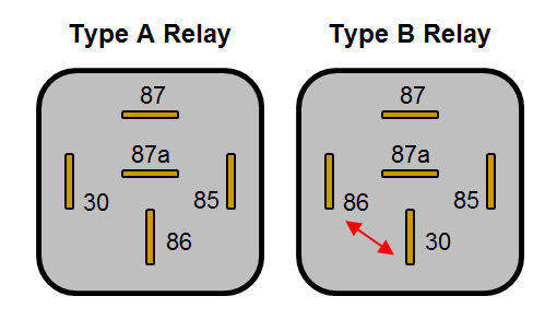

Well heck here goes;
Terminal layouts
The automotive ISO mini relays above are typically available in two types of pin layout designated Type A and Type B layouts. These layouts are shown on the two 5-pin relays below (pin 87a not present on 4 pin relays):
Terminal/Pin number
Connection
85Coil
86Coil
87Normally Open (NO)
87aNormally Closed (NC) - not present on 4 pin relays
30Common connection to NO & NC terminals
Per what has been posted here it is a possibility that your ECM is providing the ground for the relay coil either T85 or T86.
One way to verify that would be a voltage check of the relay base with the key turned on check for voltage on T85 or T86 of the relay socket,
if you have voltage on either of those then the ECM is providing the ground for the coil.
While the relay is removed you can look for voltage on T30, T87 or (T87A not likely) if so the system is good to the relay.
Also you could disconnect the battery and using an ohm meter check from the relay(s) from T87 to the glow plugs for continuity,
it may be T30 but normally that would be battery power but I have seem T87 used for power and T30 to the powered device.
If your system does not have the ECM grounding the relay coil with one side of the relay coil having voltage present whenever the key is on,
then one of those terminal T85 or T86 should be going to ground.
