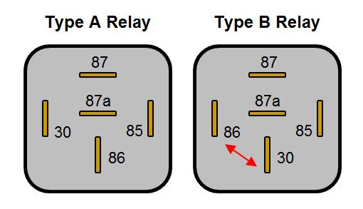

Yep - missed the link in post #88. Sorry. Ground it is.. pin 37 of the ECU has to go to ground to turn on the relay.

Well heck here goes;
Terminal layouts
The automotive ISO mini relays above are typically available in two types of pin layout designated Type A and Type B layouts. These layouts are shown on the two 5-pin relays below (pin 87a not present on 4 pin relays):
Terminal/Pin number
Connection
85Coil
86Coil
87Normally Open (NO)
87aNormally Closed (NC) - not present on 4 pin relays
30Common connection to NO & NC terminals
Per what has been posted here it is a possibility that your ECM is providing the ground for the relay coil either T85 or T87.
One way to verify that would be a voltage check of the relay base with the key turned on check for voltage on T85 or T87 of the relay socket,
if you have voltage on either of those then the ECM is providing the ground for the coil.
While the relay is removed you can look for voltage on T30, T87 or (T87A not likely) if so the system is good to the relay.
Also you could disconnect the battery and using an ohm meter check from the relay(s) from T87 to the glow plugs for continuity,
it may be T30 but normally that would be battery power but I have seem T87 used for power and T30 to the powered device.
If your system does not have the ECM grounding the relay coil with one side of the relay coil having voltage present whenever the key is on,
then one of those terminal T85 or T86 should be going to ground.
This link has a lot of good information on relays;
Automotive Relay Guide | 12 Volt Planet
Have fun.
Suggest you check you use of "T87" in your text.... Don't you really mean "T86"...
Yes good catch,
I went back and edited it.
Thanks for catching it.
