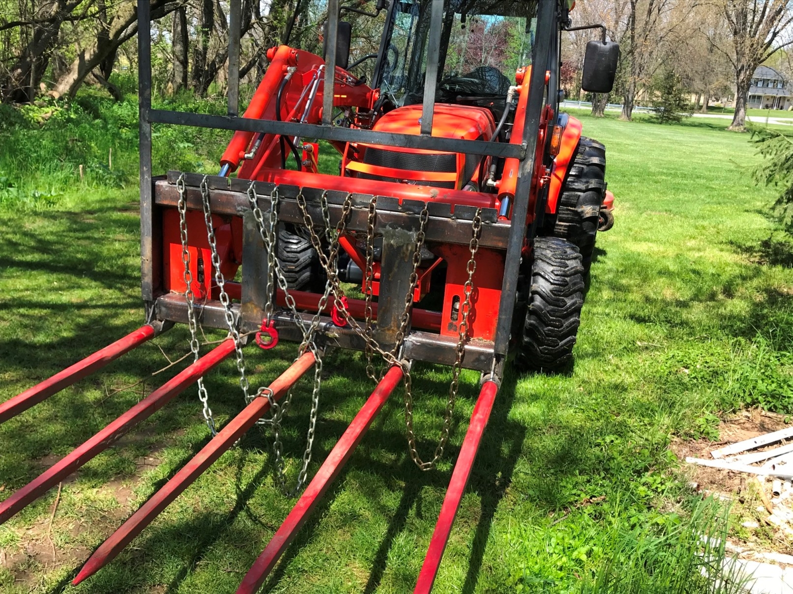

I'd imagine bale spears would hold up well. That's what I used to build my brush forks and they're quite robust
