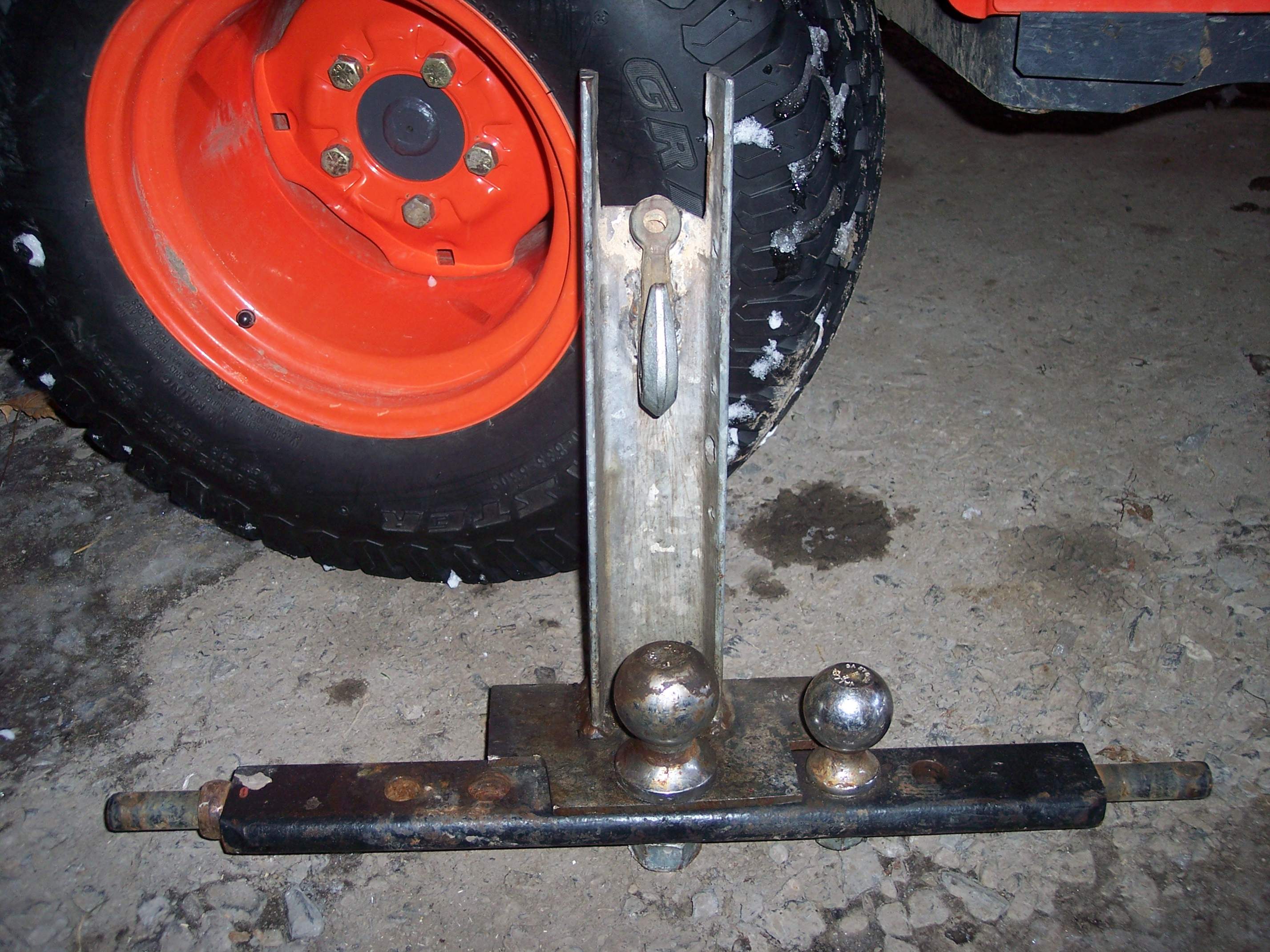

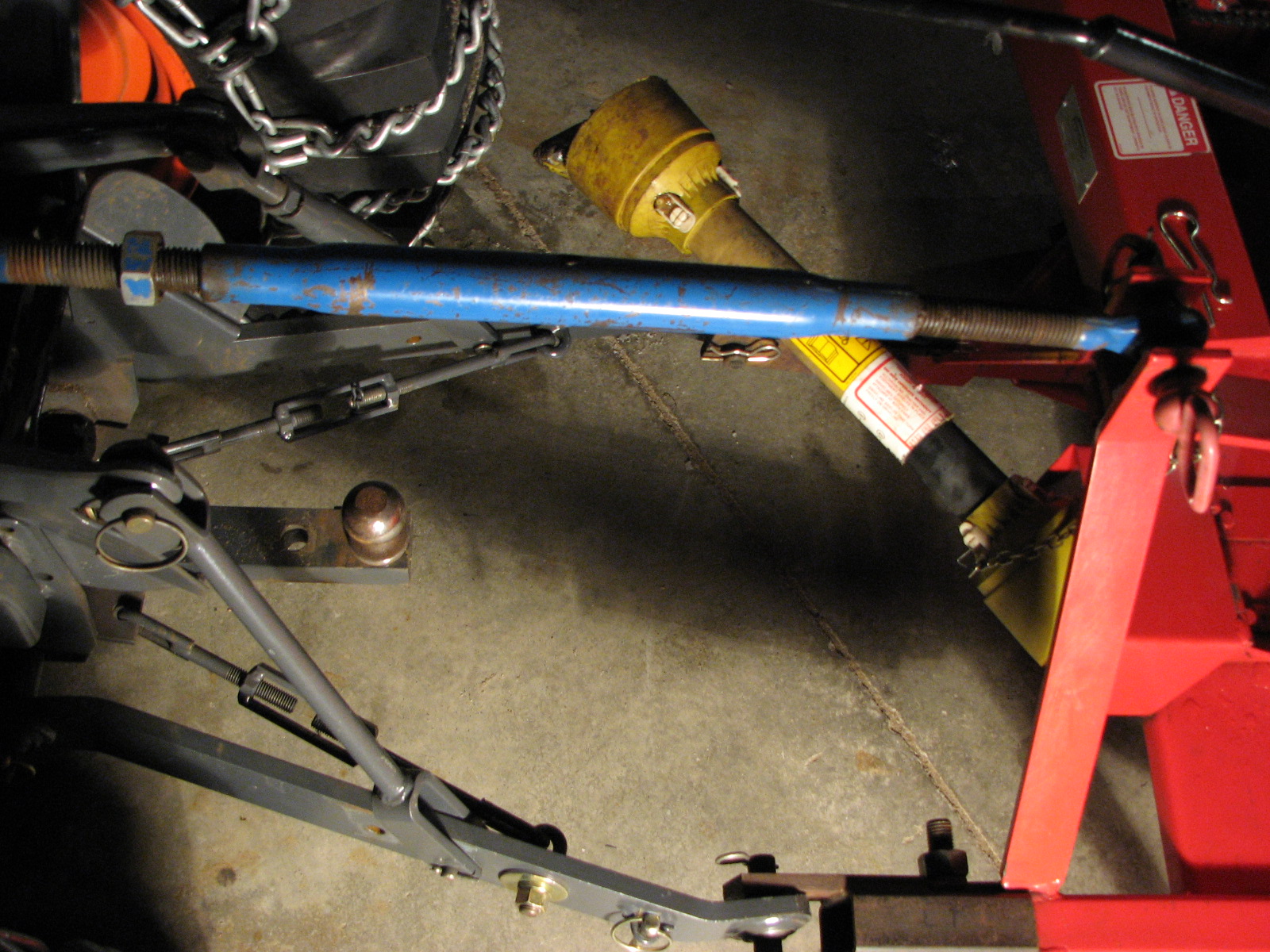

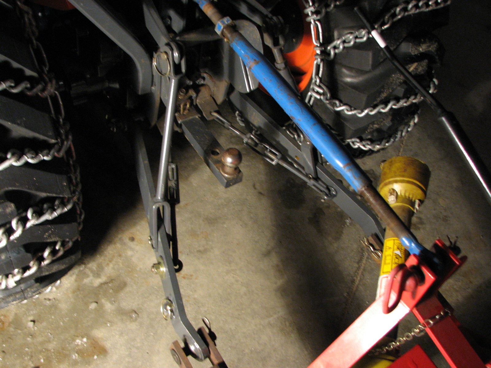

what type of apparatus would I need to put a 2" ball on back of my B7800 I would like to move a small trailer approx 500# I also have a 16' tandem axle flat bed approx 1800# just need to position trailers.
   / Ball Hitch for K B7800 #2
you could go to ebay and get one of the ready made hitches. Or you could make one like I did.

I moved both 16ft landscape trailer no problems in slippery areas and my 22ft camper with a small BX. The camper was a bit heavy, lifted no problems on 3 pt hitch, but tries to do a wheelie without the FEL on it. :D

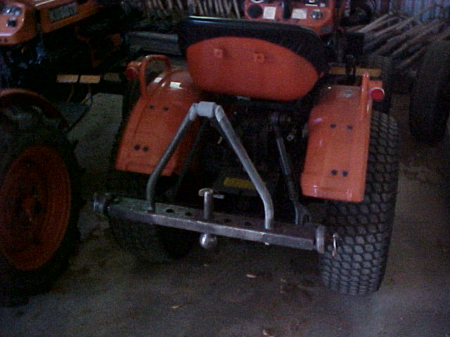

Get a "Handy Hitch" off ebay. Redland Hill Farms. I have one on my B7800 and they work great. Around $100.

Cheapest way to do it is to get the short (20') cat 1 bar as in Radioman's picture and bolt on a reciever made for a truck bumper ($40 or less).
Buy the little device that keeps the bar from rotating and you are done.
Other wise do what Radioman did or have someone make on like it for you.
The "factory made" version will cost you a couple hundred bucks.
