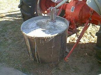

I've used old tube that were cattle feed tubs and then filled them with crete' worked out good for an old ford..

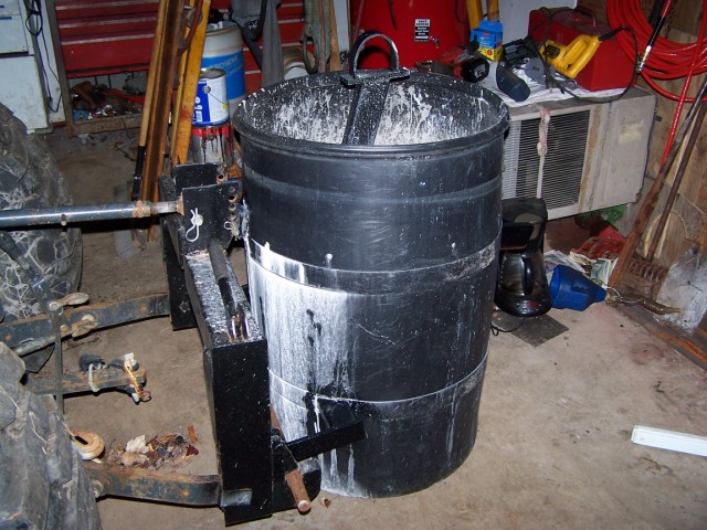

If you are talking rear ballast for your TN75D I don't think a 15 gallon barrel (or two) would be enough. I use a 55 gallon plastic barrel for my 26 HP tractor. With the steel framework and filled 3/4 full of ready mix it weighs about 800 lb. Your backhoe weighs more than that and is plenty of ballast but I guess you don't have that on which is why you need the ballast.

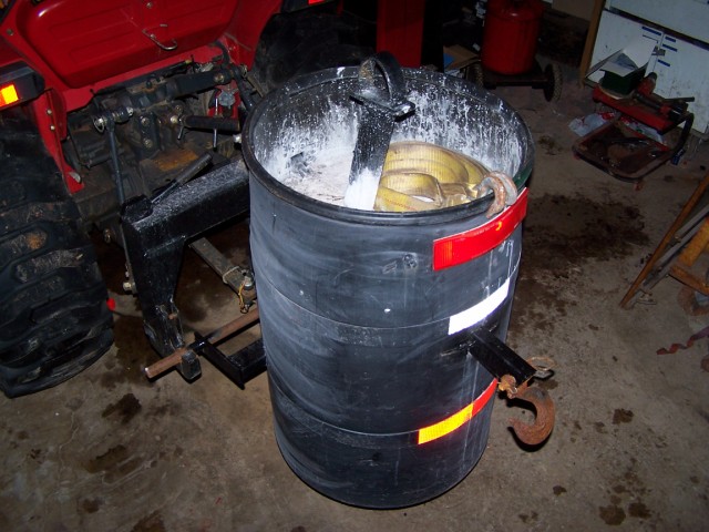

This in on a Kubota M4800 with a Bushhog M346 loader. The tractor weighs 3750# dry. The loader weighs aprox. 2000#.
I have a 55 gallon drum as ballast. It took 13 bags of quickcrete to fill it. These were 80# bags. I added aprox 1 gallon of water to each bag.
80 pounds x13 bags = 1040#
13 gallons water x 8.35# = 108#
Total weight is aprox : 1148#
I have this along with filled 14.9x28 rear tires. Each tire at 75% holds 53 gallons of water. That add 442#s per tire.
Total Ballast 1148 + 884 = 2032#
There are times when I get a full scoop of gravel in the bucket (6' heavy bucket) that the back tires want to spin.
I can actually pick up a large enough rock in the bucket to loose traction and not be able to move the tractor (2wd).
Total weight of tractor with ballast and loader is aprox. 7800#

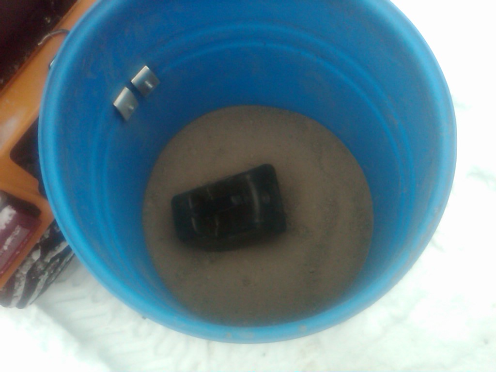

Allot of great ideas here. Something that I found useful was to use a 30 gallon plastic barrel, mount it on a draw-bar from TSC and use dry sand in it. I can adjust the weight for what I'm doing whether it's counter weight for the front bucket or the front blower. I use the sand to combat ice when needed. I was lucky enough to find a barrel that has a ring clamp that holds the top on which is rain tight. I keep a feed scoop inside the barrel so I can throw some sand around the driveway when it gets icy. My tractor is a SC2400 so it's not real big, but it sure helps to stabilize it when hauling gravel around in the bucket or when using the blower.---DTS---
