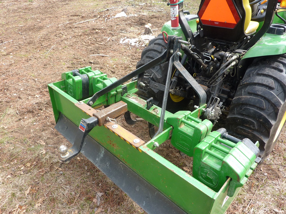

I now have about 500 lbs of suitcase weights hanging on my box blade. Found several more on CL for a fair price. :thumbsup: This solves buying a ballast box. The weights seem to stay put so far....but I think I will add a retention bar thru the handles. Maybe a cable.

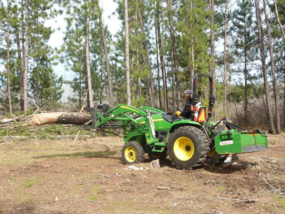

My tractor was getting a little light on the rear axel and a few times I have felt a rear wheel come off the ground....even with my loaded rear tires and the box blade on. Not good. Today I lifted some stumps and trees and maxed out the loader.....all the tires stayed planted on the ground. :thumbsup:

In your picture, if you would keep the box blade as low as posiable it would also improve your stability by lowering the center of gravity. I wish I had made my BB a long and a low rectangle instead of a square mass, cause sometimes, I lift it too high and that makes me pucker! It's all about the center of gravity, Lower the Better!
Thats a nice 2nd use of your box blade. :thumbsup:

Looks good. Curious about the black ones. I have a bunch of the same weights...... a couple of mine (also black) are actually Yanmar weights. They look the same as the JDs, but where the JDs are 42 lbs each, the Yanmar branded weights are actually heavier..... I think 48 or 50 lbs.

Well done. :thumbsup: If you find time, could you possibly describe the way that you attached the trailer hitch to your box blade? Thanks.

Do you know what the original weight for the box blade is?
/ Ballast Box Blade
I had an old chunk of 1/4x 2 x 2" angle iron....about 18" long. I simply bought a 2" reciever at the farm store and welded it to this angle. Then I gusseted it to the inside to prevent bending. Drilled holes and bolted it on. Ir's kinda medium duty.....but it seems to do everything I need with it. I had the 6" drop hitch...and that seems to get me under most trailers pretty well.

Nice set up. :thumbsup:
I'm not positive....but my guess is about 300 lbs. I have two more weights to add.....so I can get the total weight up to about 900 lbs. (and I do have a HD "basket" that can go in place of the receiver hitch. I guess I could use that for more weight...but I likely will haul some tools in it. I think it would add about 100 lbs empty.

youll find that if you use the box heavly, and fill it up, that youll push the weights out. (ask me how i know)
instead hang the weights outside the box to reduce the amount of area the dirt can push up against.
I put a 5' lenght of railroad rail on the back of mine. left about a 2" gap between it and the back wall so dirt could still spill out and i wouldnt pack it solid.
the RR rail weighs more than my BB. Id say my BB is only 200-250lbs while the rail is a good 300+
for the record, adding the weight made my box blade act ENTIRELY different. (for the better)

Adding the imatch also extends the box blade back about 6" which acts as even more counter weight. For me it's the perfect ballast!
/ Ballast Box Blade #16
makes a huge difference having all that weight. we cut prototype muffler cores at work on our tube-laser. i saved up two 5 gallon buckets of the 3-4mm x 1mm thick 409 stainless slugs from cutting the perforated patterns and packed them into a 2.5" x 5" x 3/8" wall piece of scrap tubing 6ft long and welded that to the back of my box blade. digs good now :)
