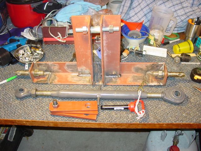

A bit of update:
They say measure twice and cut once or in my case measure correctly and weld once. I just eye balled the distance between the upright where it ties to the top link. it does work for cat I but not wide enough for cat II. I could have cut and rewelded it but would be difficult cut to keep things plumb. I went to plan B and made an extension that could also pivot. actually I like it better and would make it for easier hook up. I need to stich weld the extension although one piece would have been enough. I suppose I can use for other application if I wanted a longer top link.

Ford and others used to sell a rigid steel bar support for the tph drawbar. A hole in each end. One over the top link pin, the other over the swinging drawbar ends, with a slight bend at each end so they go straight over the pins. They were about 1/4" thick and 1-1/2" wide, length to make the lower links parallel to the ground. I think I have one around someplace, though you'd want to measure your requirements.
I like the flex of the extender-fix.

Jim,
I hunted a few hrs this am and swung by my place and picked up the top link for fit check. To my surprise I noticed the top link had two different ends one for cat I and one for cat II, so I could have switched them how I needed it. I never realized that. It was still a bit tight for cat I and needed a hammer if it got bound up. My idea is pretty much what you described as I was planning to stitch weld two of the 1/4" thick bar together although 1/4" probably is good enough as it would always be in tension with some side to side force. I can bury the contraption more in the middle of 2x2x2 concrete block and use it for lifting and moving it when needed.

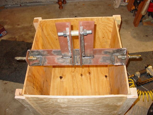

Hey guys, one more update.
I made a box (form) that measure to 2x2x2. This thing appears pretty big and I wondered If I might need to make it a bit smaller. The width I'll keep the same as 24" . I could pick it up with quick attach @ 26" center to center of the lift hooks. I don't have to fill up to 2 feet and as far as depth I can reduce it to around 20" or some adding a filler piece in the form. This thing will get filled up in spring next year.
Any opinions?

Tie it on temporarily somehow and fill with washed stone or gravel to try it out?

Jim,
Plywood will not be able to handle the weight without quite a bit of bracing on the outside. I might check to see if kubota has a ballast box and how much weight it has. I then then adjust the inside volume to comply with the weight needed. I'm thinking may be around 900 lbs be a better weight hanging in the back. If so, then I adjust the dimension to 2x??x??.

Concrete ~150#/cf. 2x2=4 SF x 1ft high = 4 x 150 = 600 # @ 12" deep, so 18" deep should be 900#. I think...
