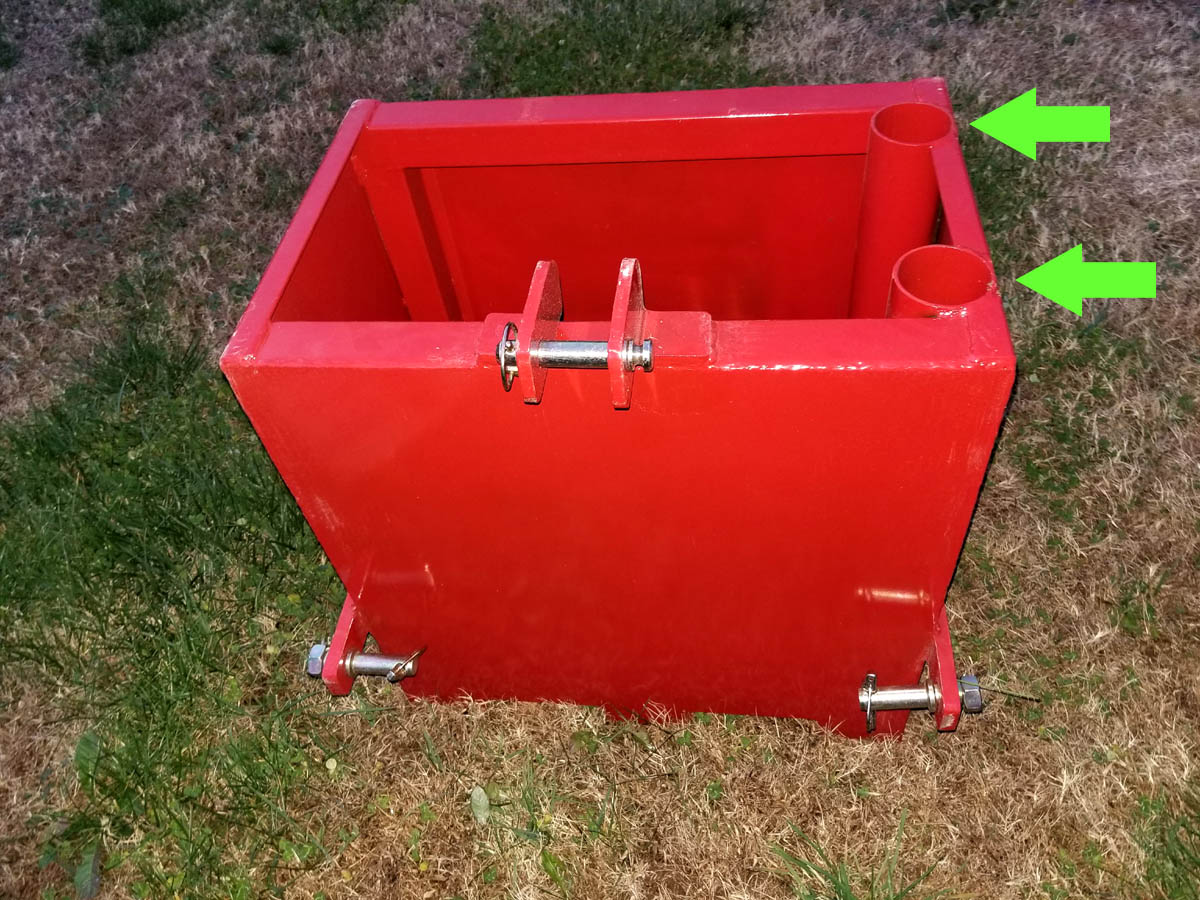

Big brown truck delivered a big red box today. Got this ballast box from Titan Distributors (not sure if that is same Titan as sticky at top of this page???) on Amazon Amazon.com: Ballast Box 3 Point Category 1 Tractor Attachment: Home Improvement. I thought $259 was a very fair price for how heavy this thing is esp since that included shipping. Box/packing cardboard was pretty beat to heck, but once unwrapped it seemed to be in great shape minus a little scuff here & there on high points - which I couldn't care less.
Couple questions:
1. There are 2 big round cylinders welded in corners on one side. Do those serve a purpose or is that just structural support? Could carry around a hoe or rake but otherwise can't think of a reason for them to be there.
2. How heavy should I try to make it? It's 130 lbs empty. I have a small 25hp tractor that can lift about 1200 lbs with FEL. Rear tires are fluid filled. I do lots of dirt/gravel moving with FEL. So far have been doing that with a 5' box blade on rear and machine handles fine. I have sand, ABC gravel, #1 crushed concrete, and 4x8x16 concrete blocks to choose from to add weight. Thinking the blocks are a good choice since easy to remove but would be lightest option. Sand I would guess needs a have trash bag liner or something to keep it from leaking out of the trap door?
3. If I do use the cement blocks that would put total weight around 600-650 lbs. This box has a receiver for a 2" trailer hitch. So if I wanted to move my empty trailer around (16' dual axle landscape/utility type, 1800 lbs, no idea tongue weight) would I need to worry about too much weight on the rear or 3-pt?

G'day Mate.
The corner 'pipes' are for handled tools that you may want to transport (shovel, hoe, rake, etc...).
As for adding weight, that's up to you. I loaded my JD ballast box up with bricks that were lying around the property. Filled it to within 3" of the top and then cut a rubber mat to place on top. Some folks simply pour cement into it to bring it up to that level... even adding a chainsaw scabbard.
The amount of weight that you can add is entirely up to you.

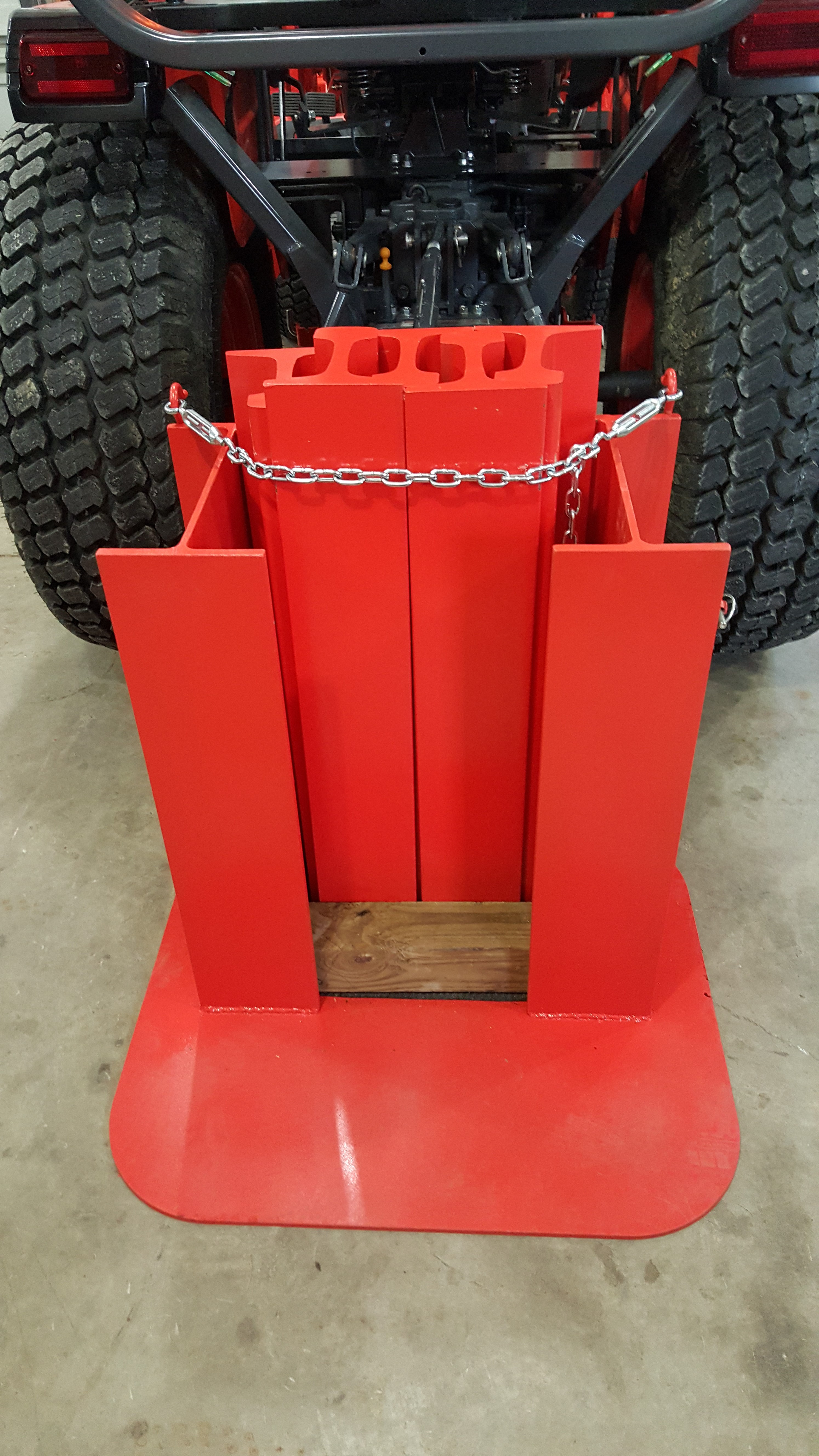

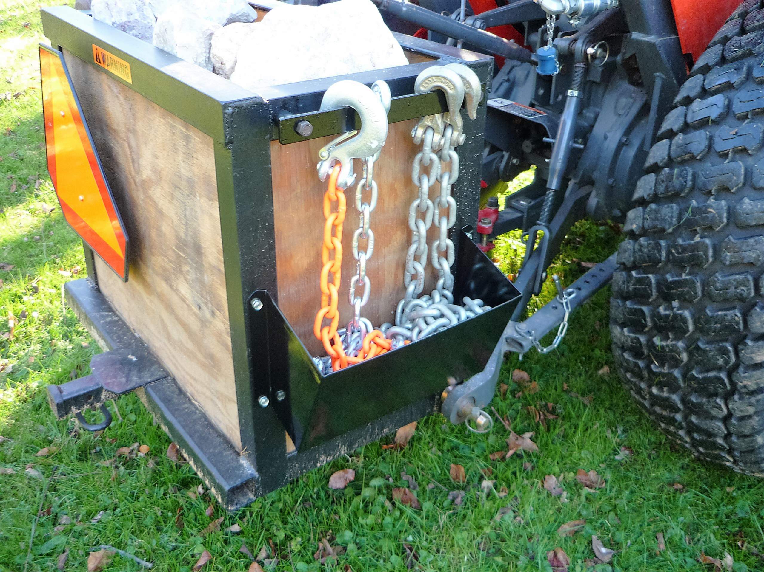

I built a ballast box because I got tired of worrying about whacking things with a big box blade out back. Then, I discovered how handy it is to carry chains on it, and with a trailer hitch as well, it serves me nicely. I wanted removable or adjustable weight, for depending on the task, and stones work for that, plus it's a lot easier to remove or install when it doesn't have a full load in it. Had I known you could buy one like the OP's, for just over $200, maybe I would have gone that route?
/ Ballast box #17
Nice job on the box and chain storage! Like you I think its a good idea to having adjustable weight in the ballast box. I'm using iron suitcase weights in mine which leaves room in the box for other stuff.
