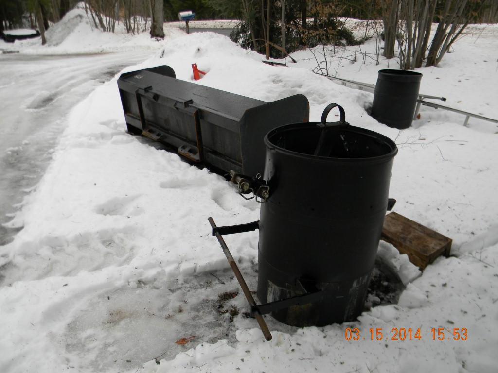

I use a 55 gallon barrel I made up years ago. 10 - 80 lb bags of ready mix and about 50 lbs of steel framing inside the barrel. I figure it's at least 850 lbs. It's narrow enough to go through the woods without getting hung up on trees.

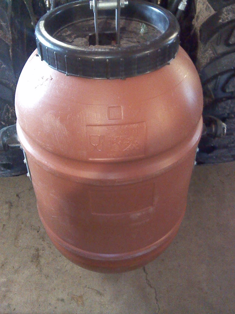

Here's what I use,I just took an old bait barrel and beefed it up with some rolled 11Ga and a drawbar. I bolted two pieces of hotrolled to the drawbar for the top link, and simply filled it with sand. I figure 300 to 400 Lbs. It has helped greatly plowing snow.I only have three hrs into it and about $35 for parts.
