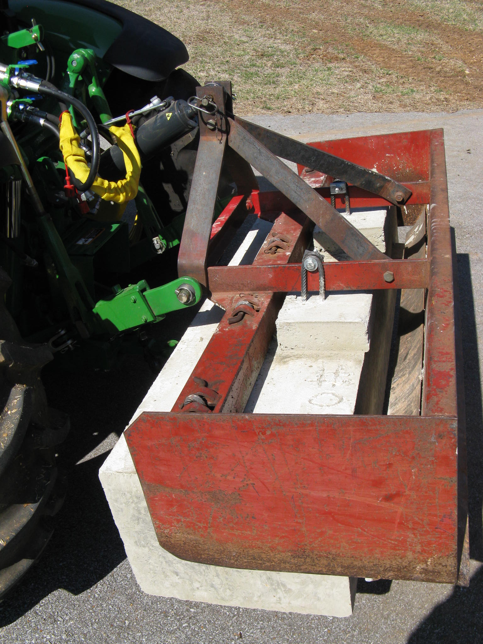

Concrete is about 150lbs per cubic foot. Just do some math and design to fit your limits. I just worked it out so it would allow it set on the ground and release from the hitch.

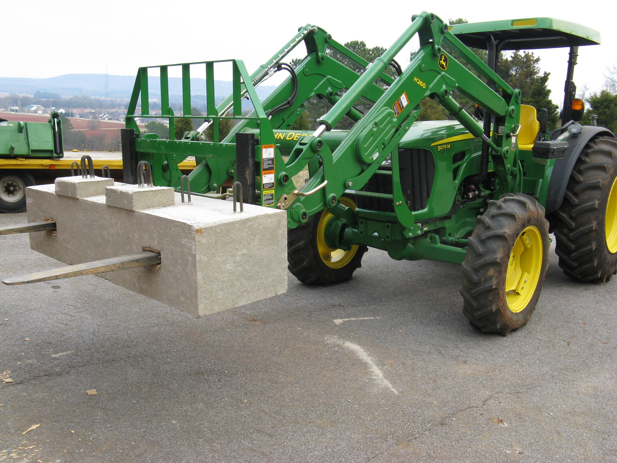

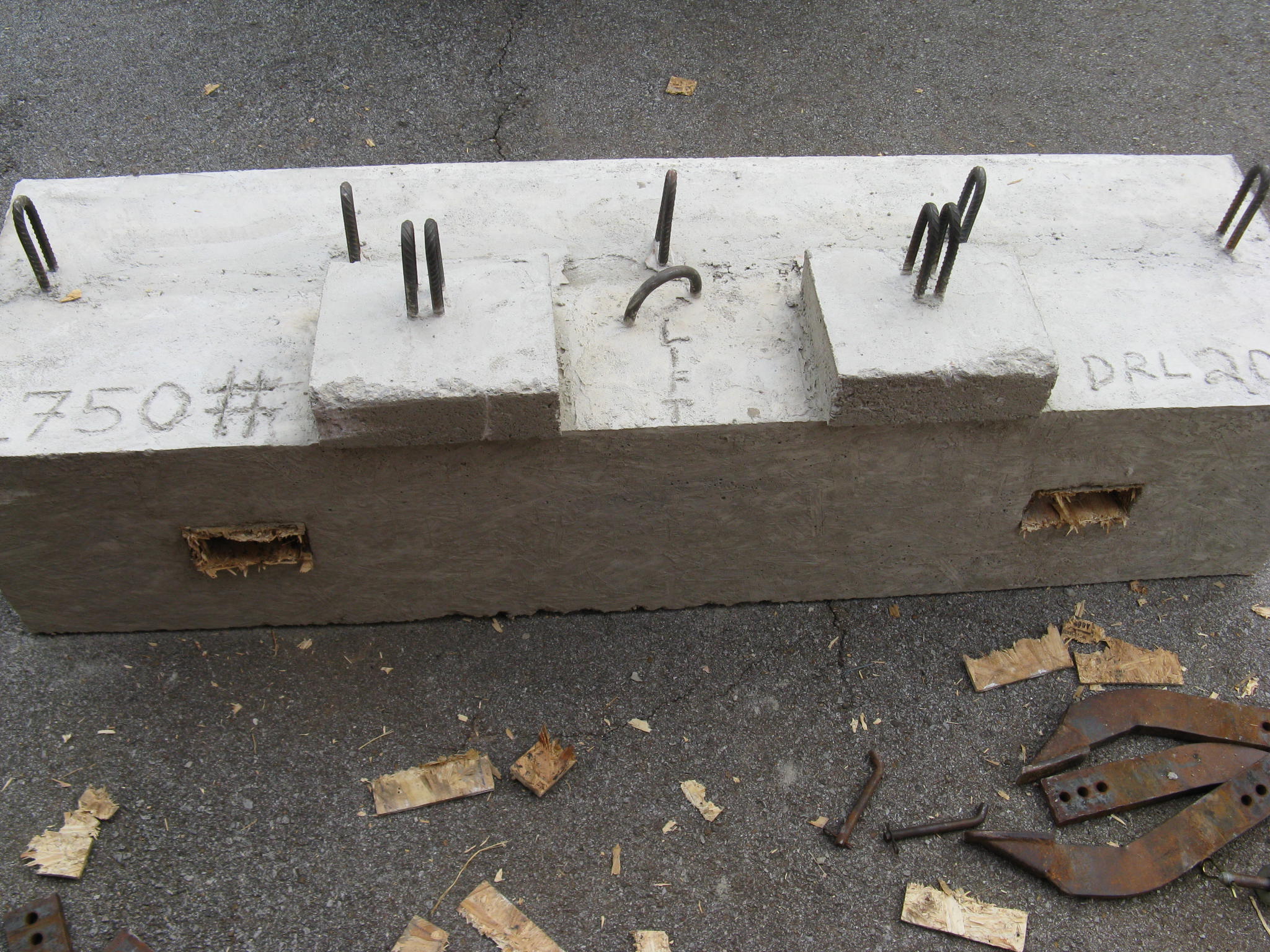

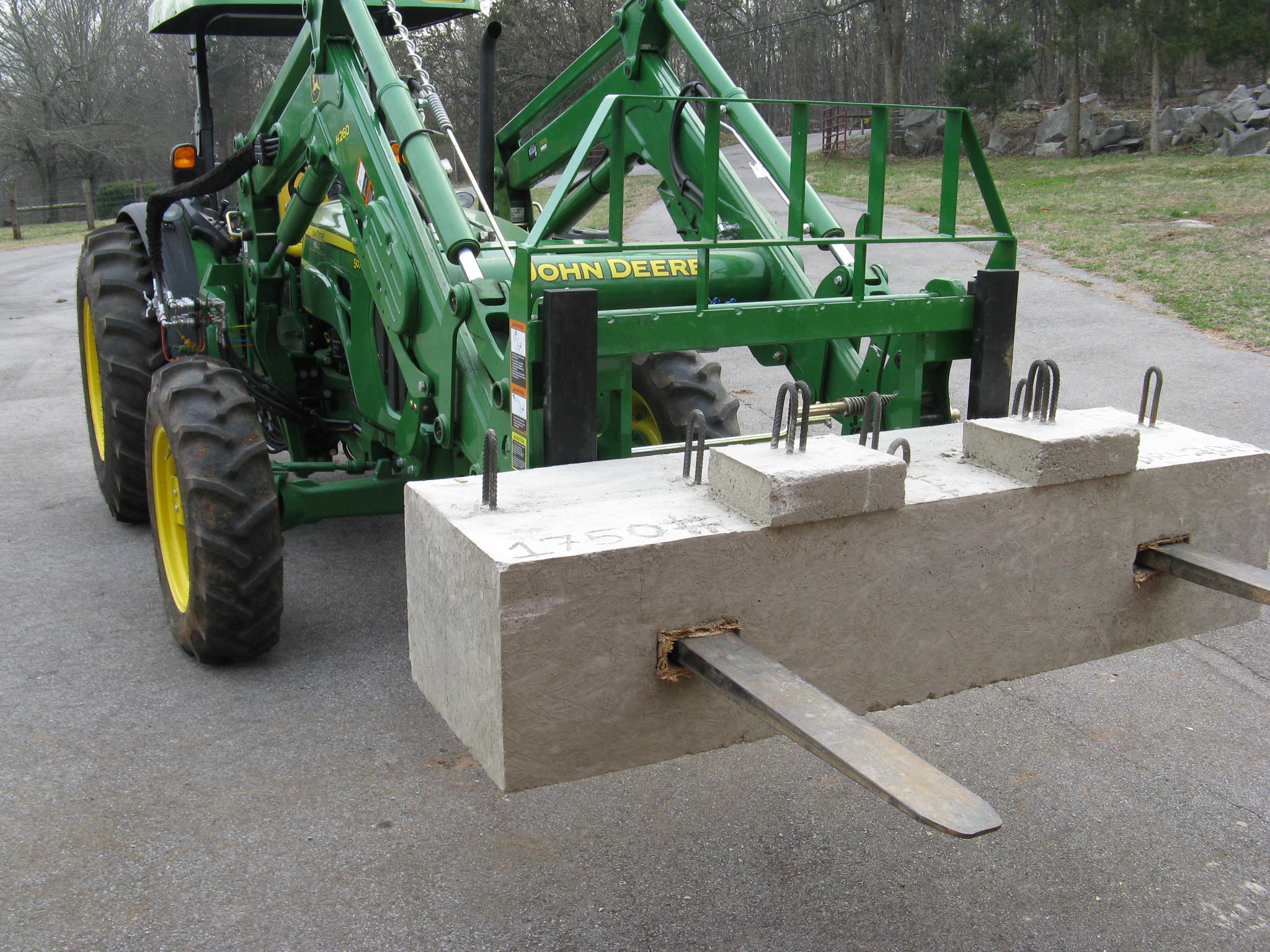

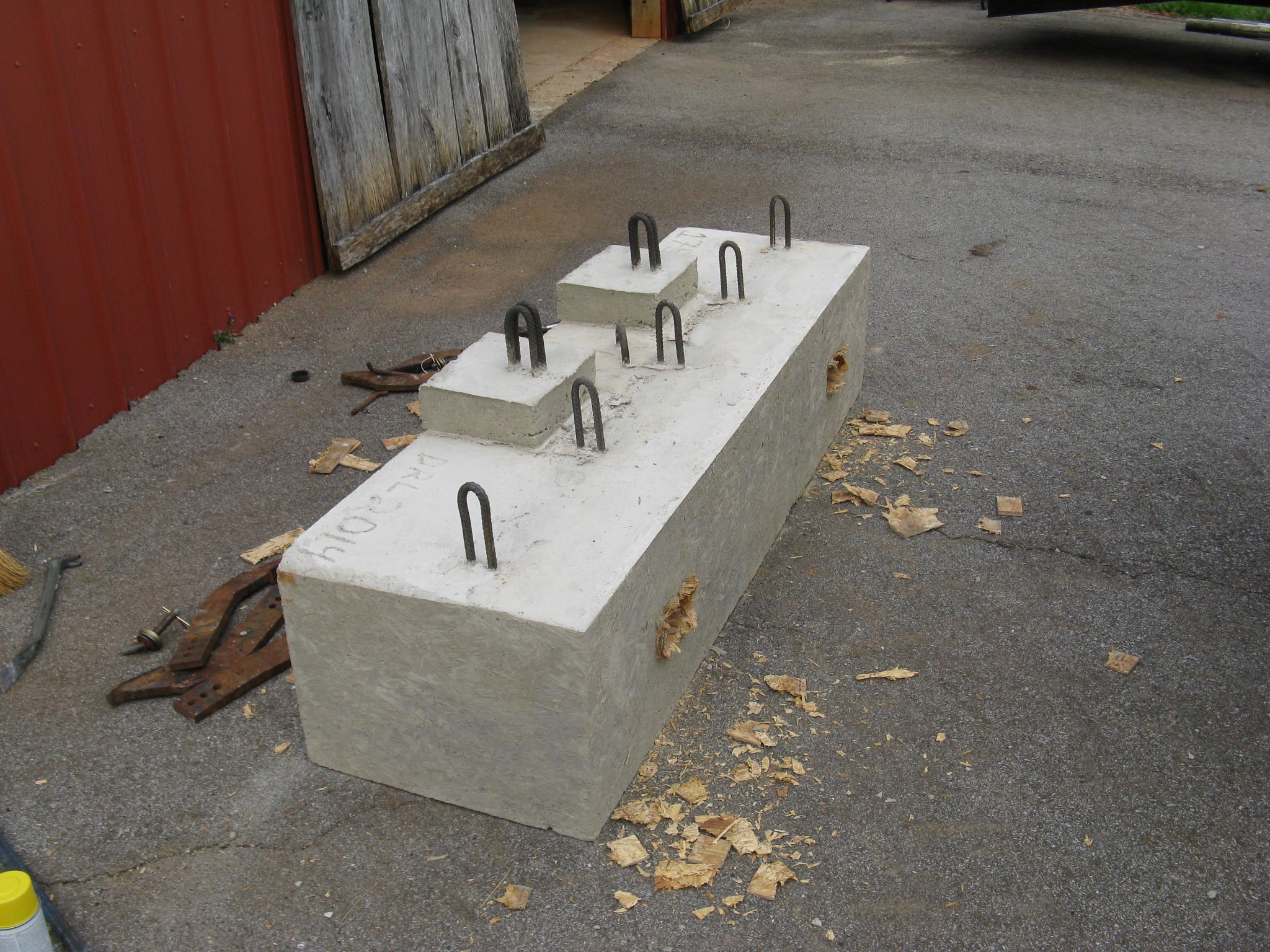

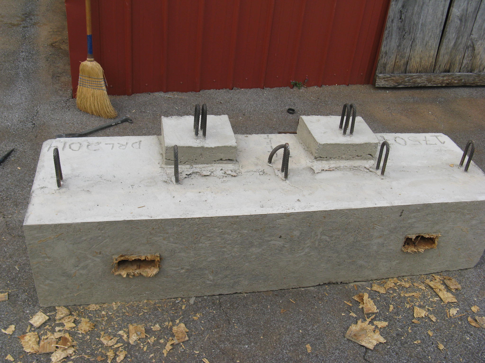

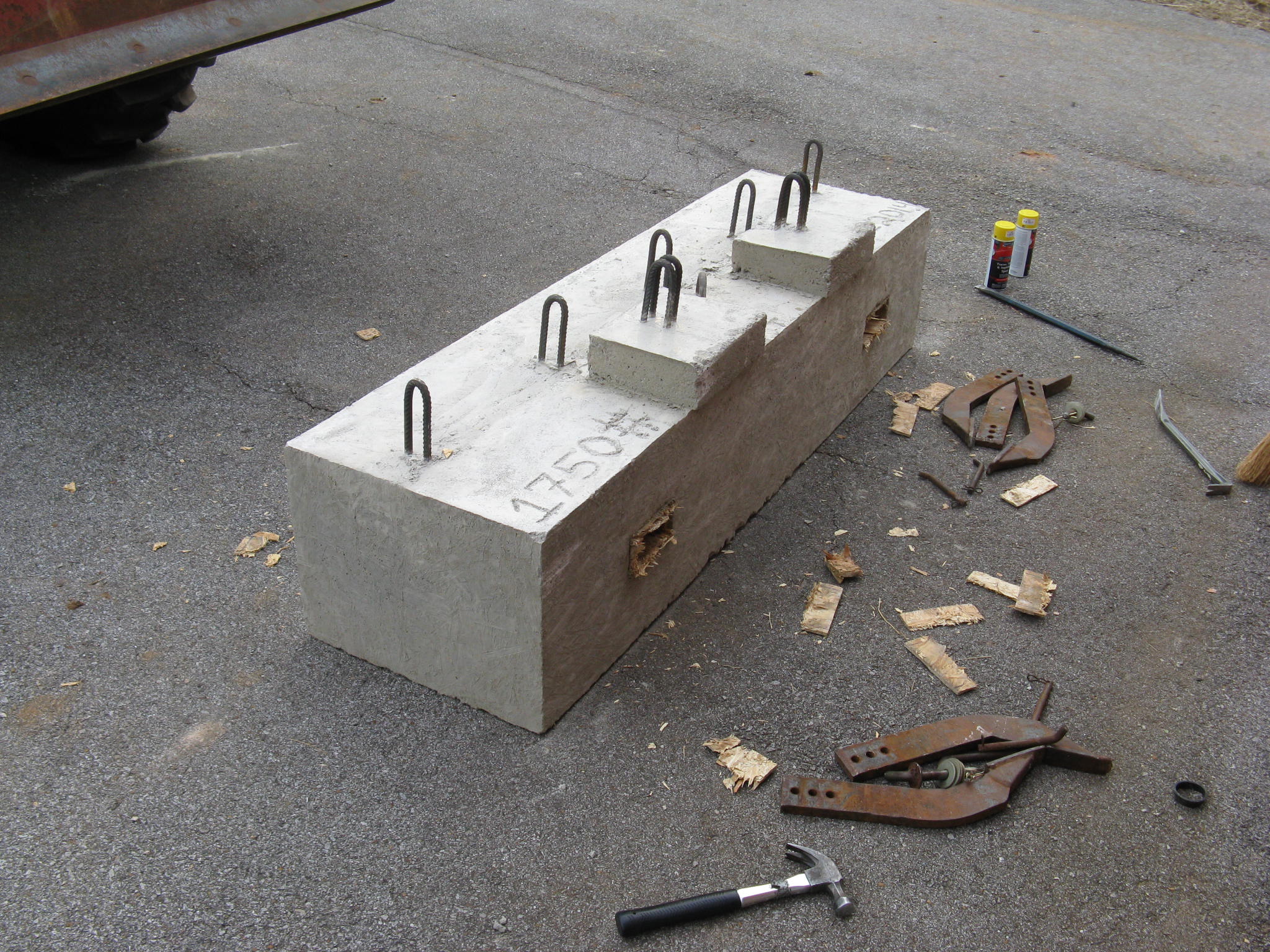

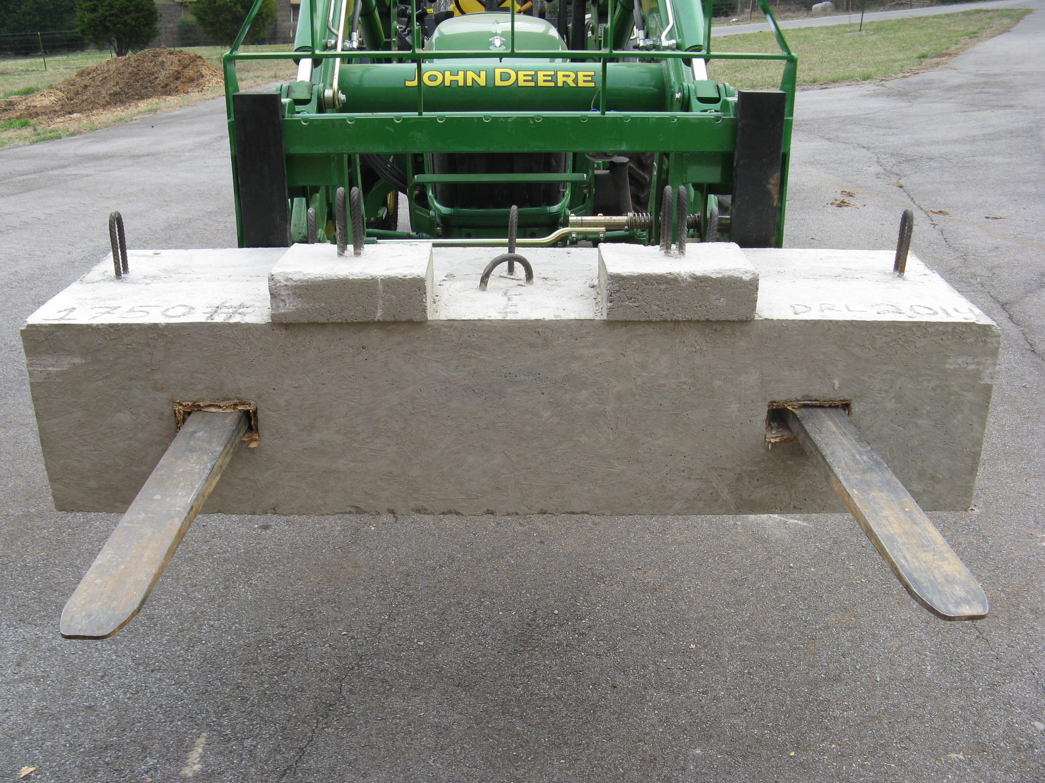

Ballast 020.jpgBallast 011.jpgBallast 013.jpgBallast 014.jpgBallast 015.jpgBallast 016.jpgBallast 017.jpgBallast 018.jpgBallast 019.jpg
Finished except for a little paint to keep the rebar from rusting. The fork slot forms are giving me some trouble to get out, but I allowed for that and made sure the forks would fit the slot even if the forms were in there and had to come out slowly. I am very pleased with it and look forward to using it tomorrow.
SPECS: 20"X15.5"X71.25" - 21 & 1/2 bags of 80lb Quikrete - 60 lbs of rewire & rebar. Approximate weight 1750lbs.
