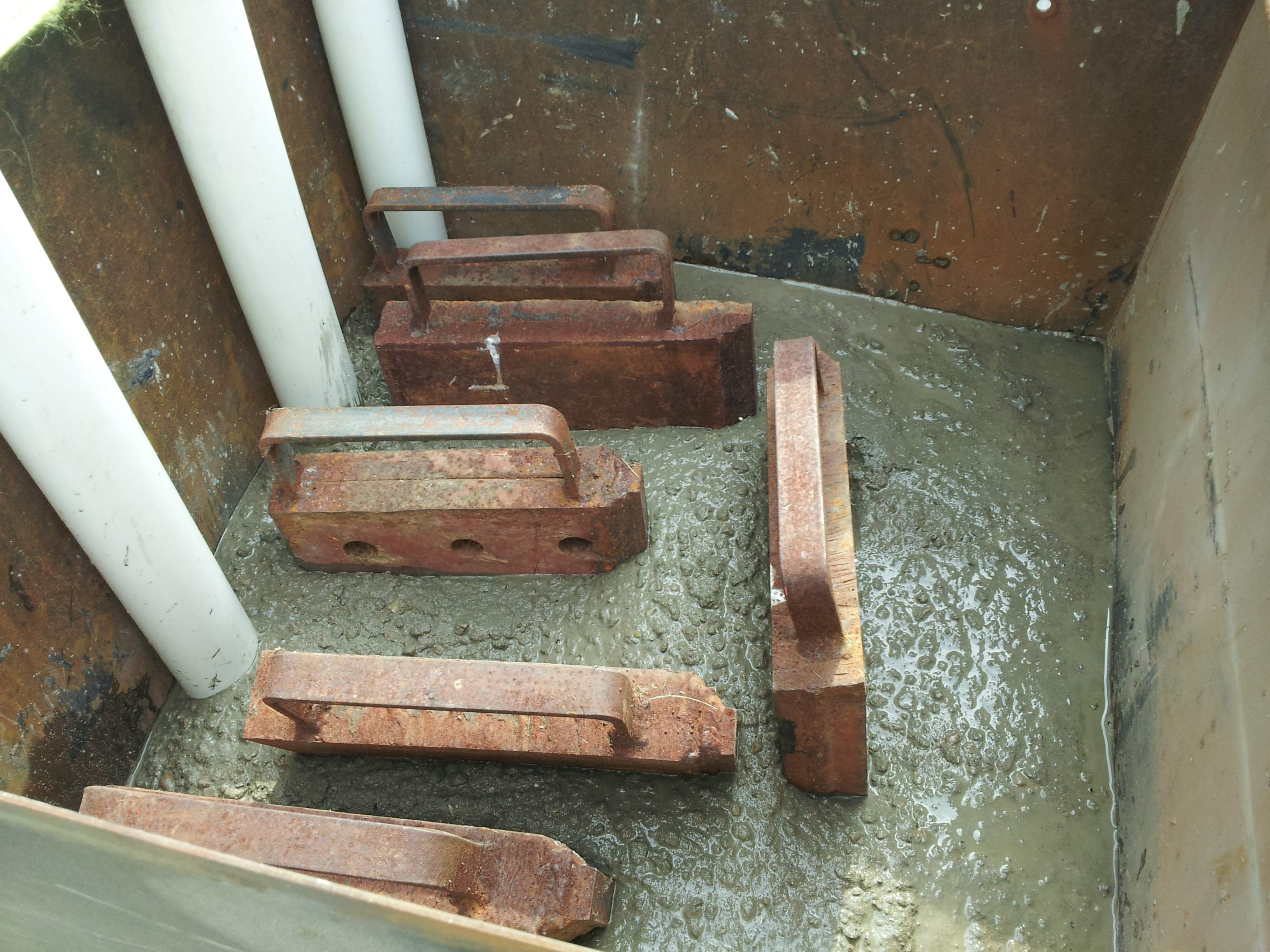

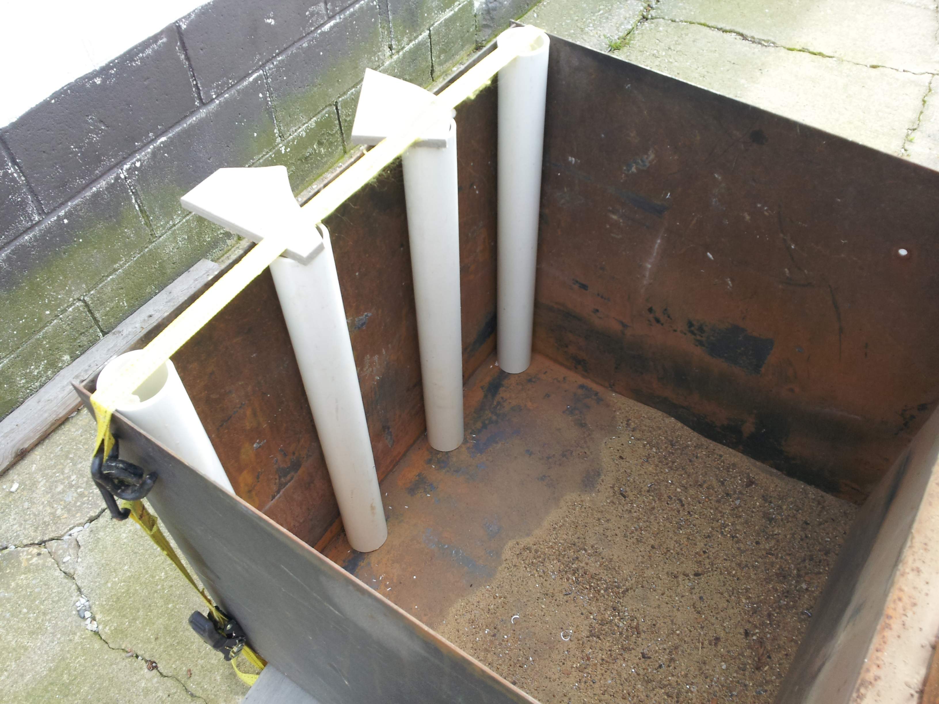

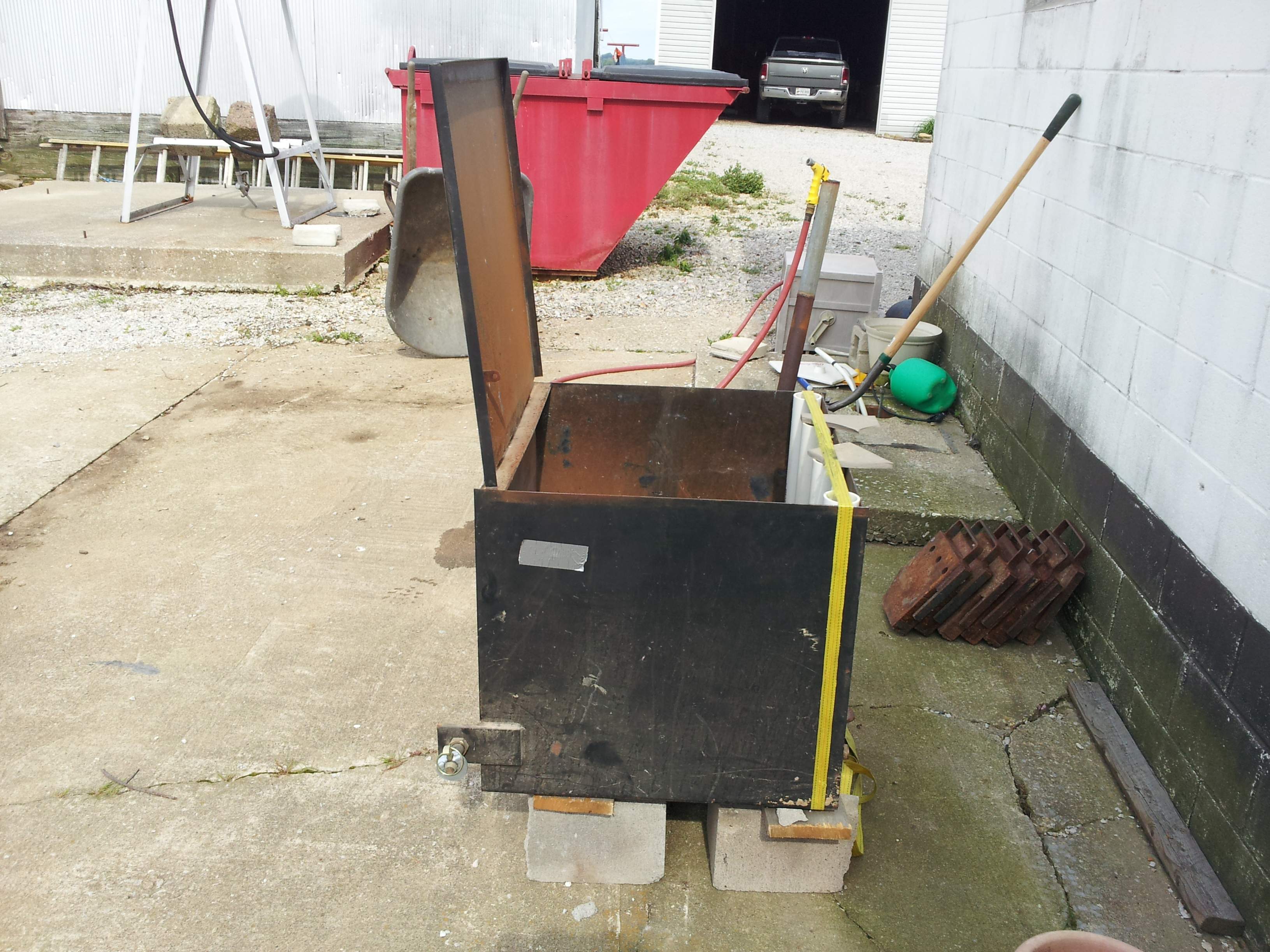

Here is my ballast box build, with ideas borrowed from many folks here. I lucked onto a great deal for the box itself. From there, it was just a matter of buying pvc and concrete, then finding the time to fill it. Finally did that yesterday. I didn't take a pic of the finished product but will and will update the post.
The pics are in reverse order of what I intended to attach them.
First shows the pvc in place. I had previously drilled a 5/16" drain hole in the box in the center of each pvc.
Second is just another view of the box itself.
Third shows the box partially filled with crete, then I added close to 500 lbs of steel plates I had lying around.
I ended up using ten 80 lb bags of 4000 psi crete, so with water it's hard telling what the weight is. With the added steel, I'm guessing it will weigh anywhere from 1200 to 1500 lbs.
I feel that an error was made imbedding steel weights with holes and handles into the concrete.
Left outside, they could be used for other purposes.. And add value to more applications. Like front end weights. or "adjustable" rear weight.
But...it's your......;=)
   / Ballast Photos #87
I normally would agree. I had them made out of one large plate about 15 years ago. I used them for 1 year and then after upgrading tractors they sat, unused, since. I thought about welding some sort of holders to the outside of the box to add the steel weights, but didn't think the 1/8" steel would hold up and wanted everything enclosed inside to reduce size so it wouldn't catch on anything.

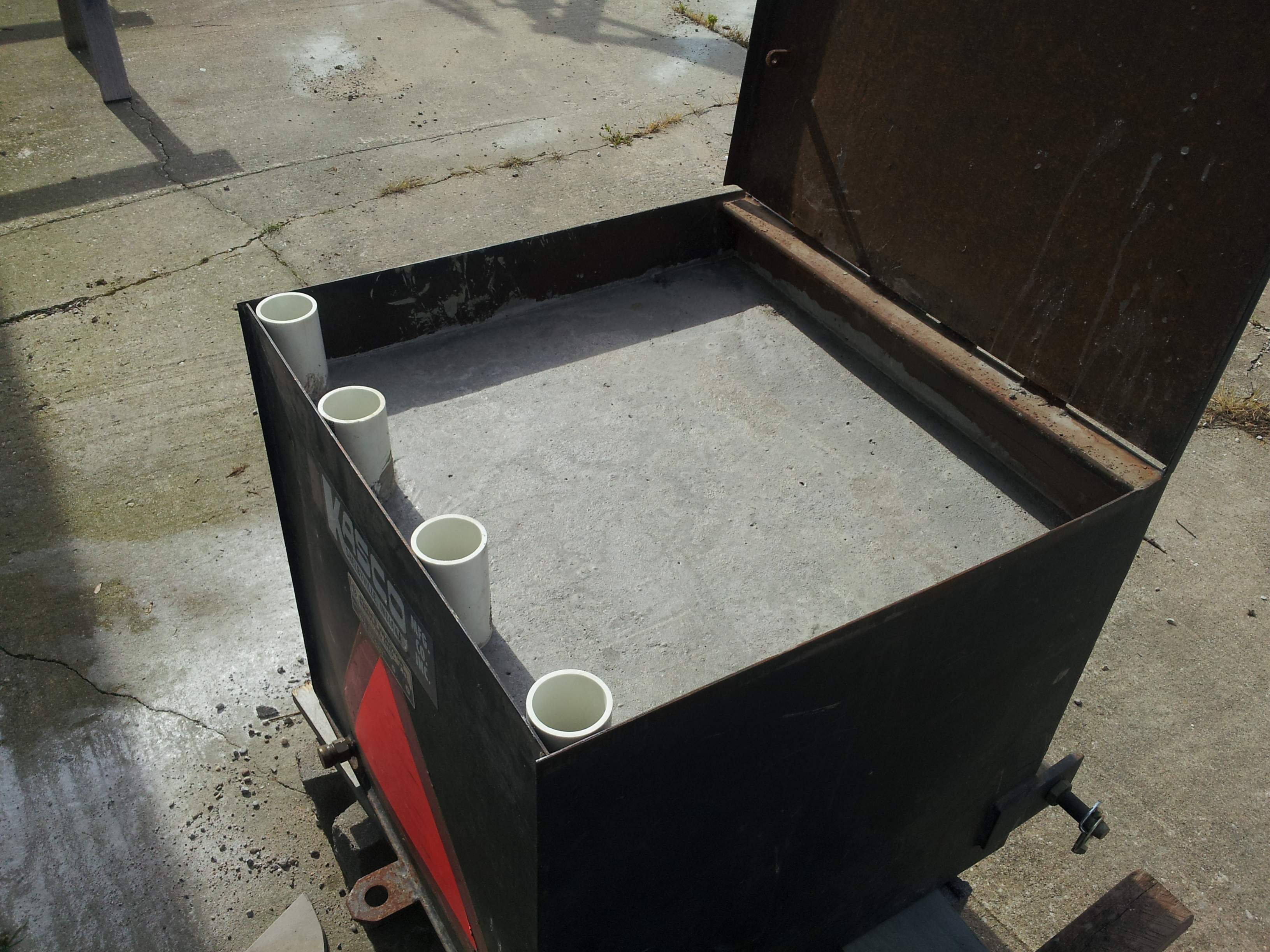

   / Ballast Photos #88
Crete is drying nicely.
