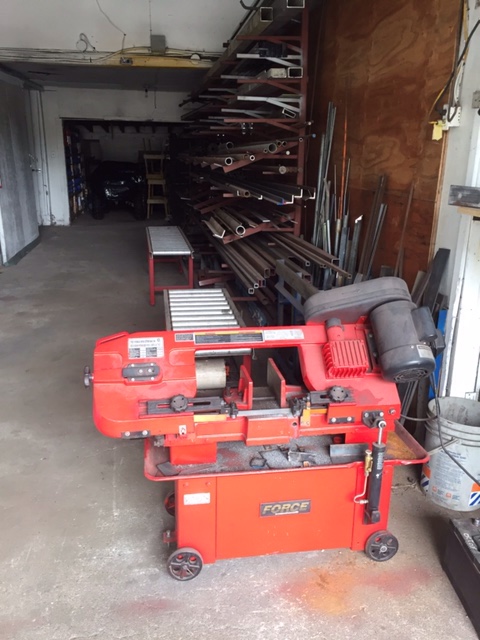

Physassist - Sorry no answer for you but I'll add to your question: My bandsaw doesn't even have a lube option and I've always wondered if it's worth adding?
It cuts just fine as is, blade doesn't get hot, but of course it's not exactly fast. I'm wondering if I added liquid cooling if I could speed up the cutting and also lengthen the lifespan on the blades?

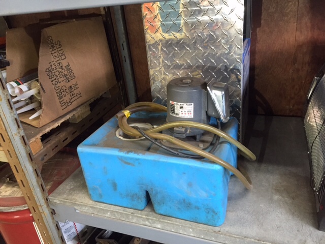

***WARNING** The following is an expressed OPINION only and not supported by any scientific evidence!
I disabled and removed my liquid coolant system years ago. It now resides on the shelf. I don't miss the mess it made, the clogged screens and not to mention the short shelf life.
I now use a "lube stick" which I find works well for my "less than industrial" setting ( and is also compatible with my 'cut and dry' attitude.
Terry
