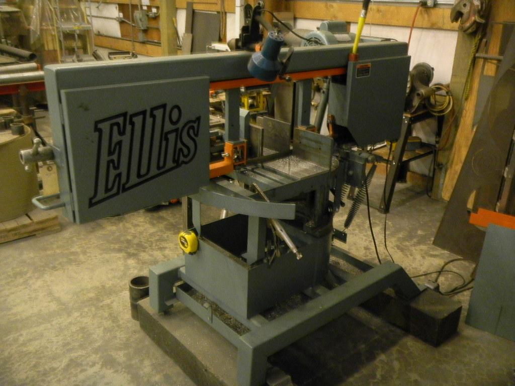

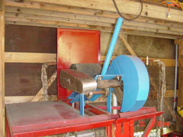

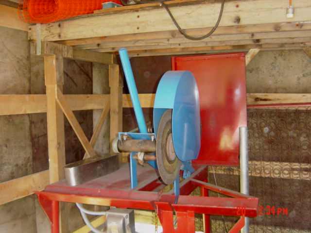

In the 1970s I worked in a fab shop that had a large chop saw in an outside bay. When that blade would break and hit you in the chest it would almost knock you down. About 15-feet above the saw was a fiberglass clear roof panel. It had several holes punched in it from broken blades. Years later I built one like it, 7 1/2-horse power motor. It will cut 4-inch round stock in just a few seconds! I haven't used it in years. I use my Ellis 1800 band saw for all my cutting needs. Well except the plasma, and OA torch.:D
