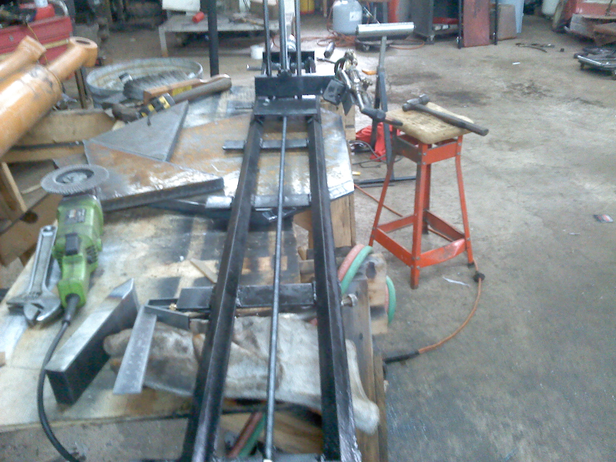

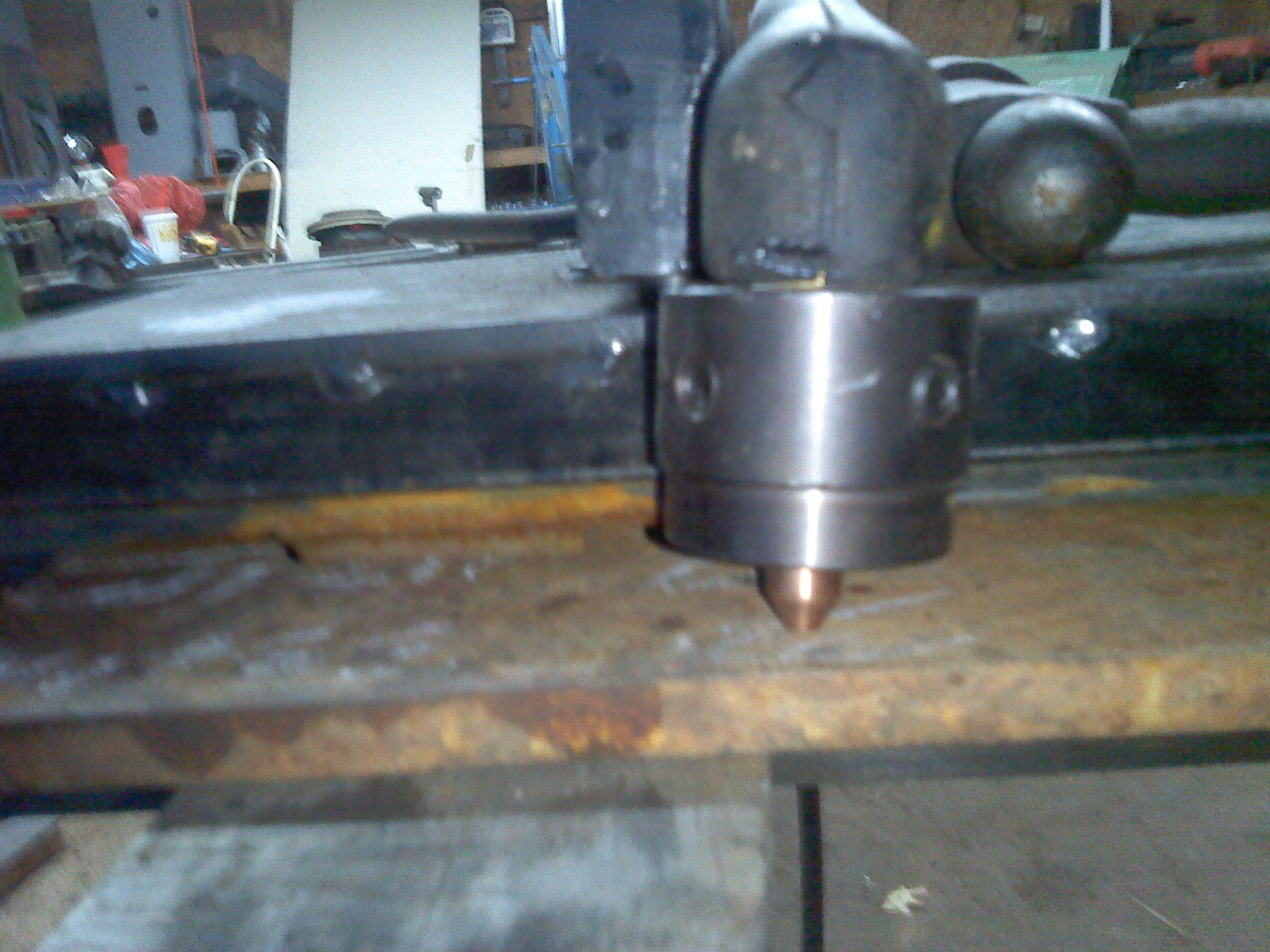

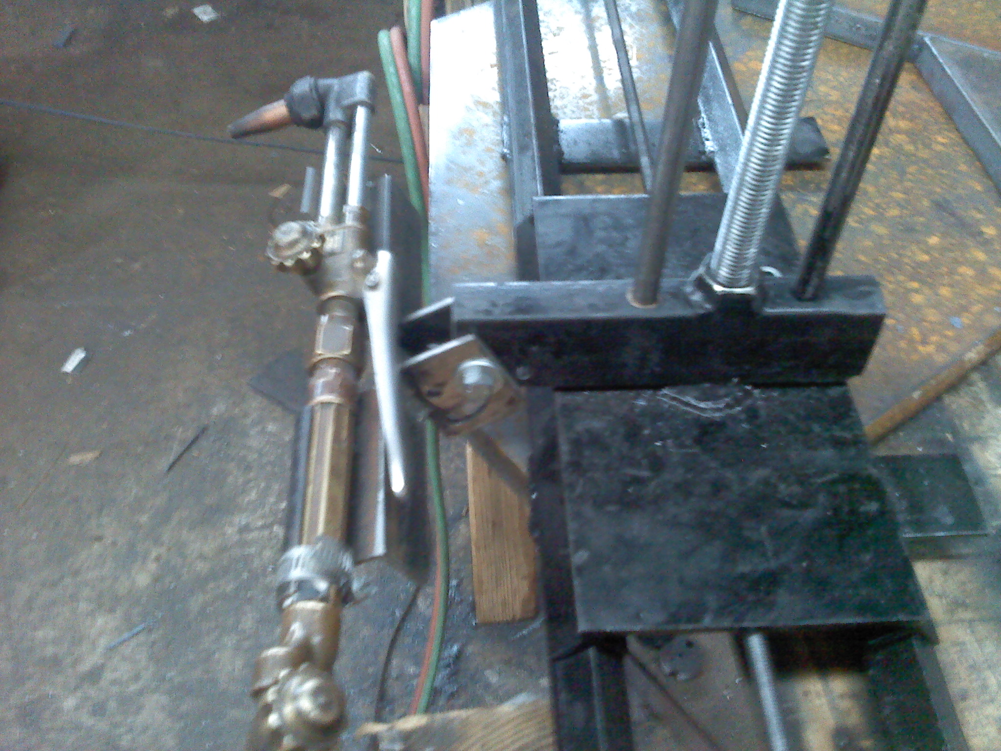

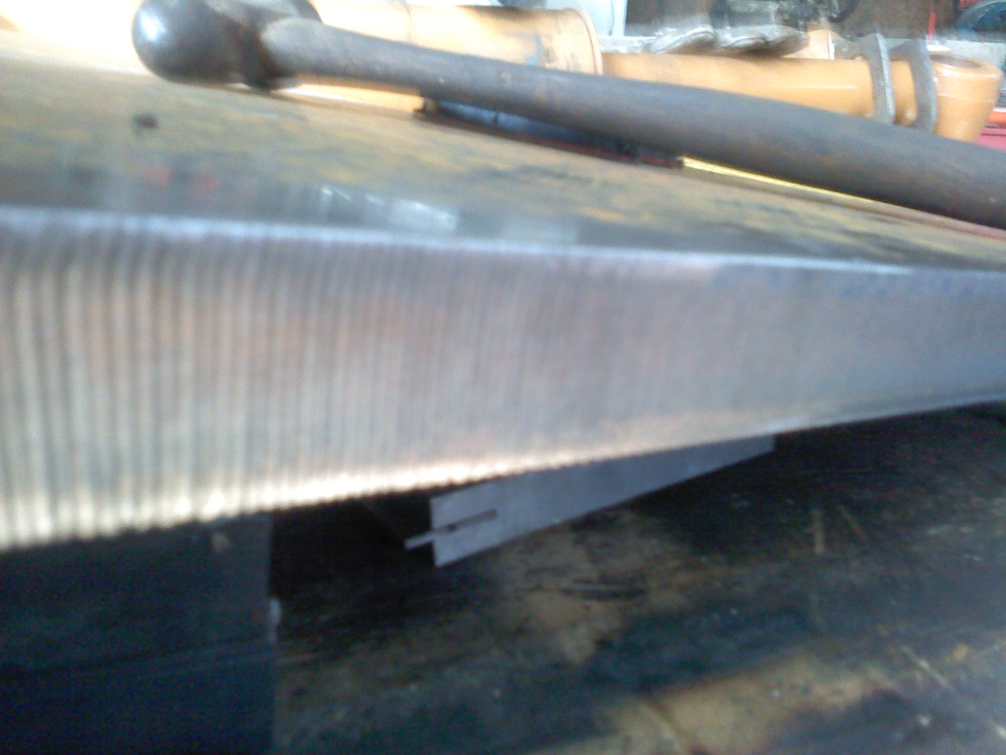

I had a buddy that used a wormdrive circle saw for cutting metal plate. Never got to try it myself, but he said it was the way to go. I build a drill operated track torch for making log straight cut in flat plate. I use my oxy acet torch, but did make a mount for my hand held plasma, but havnt tried it yet.
