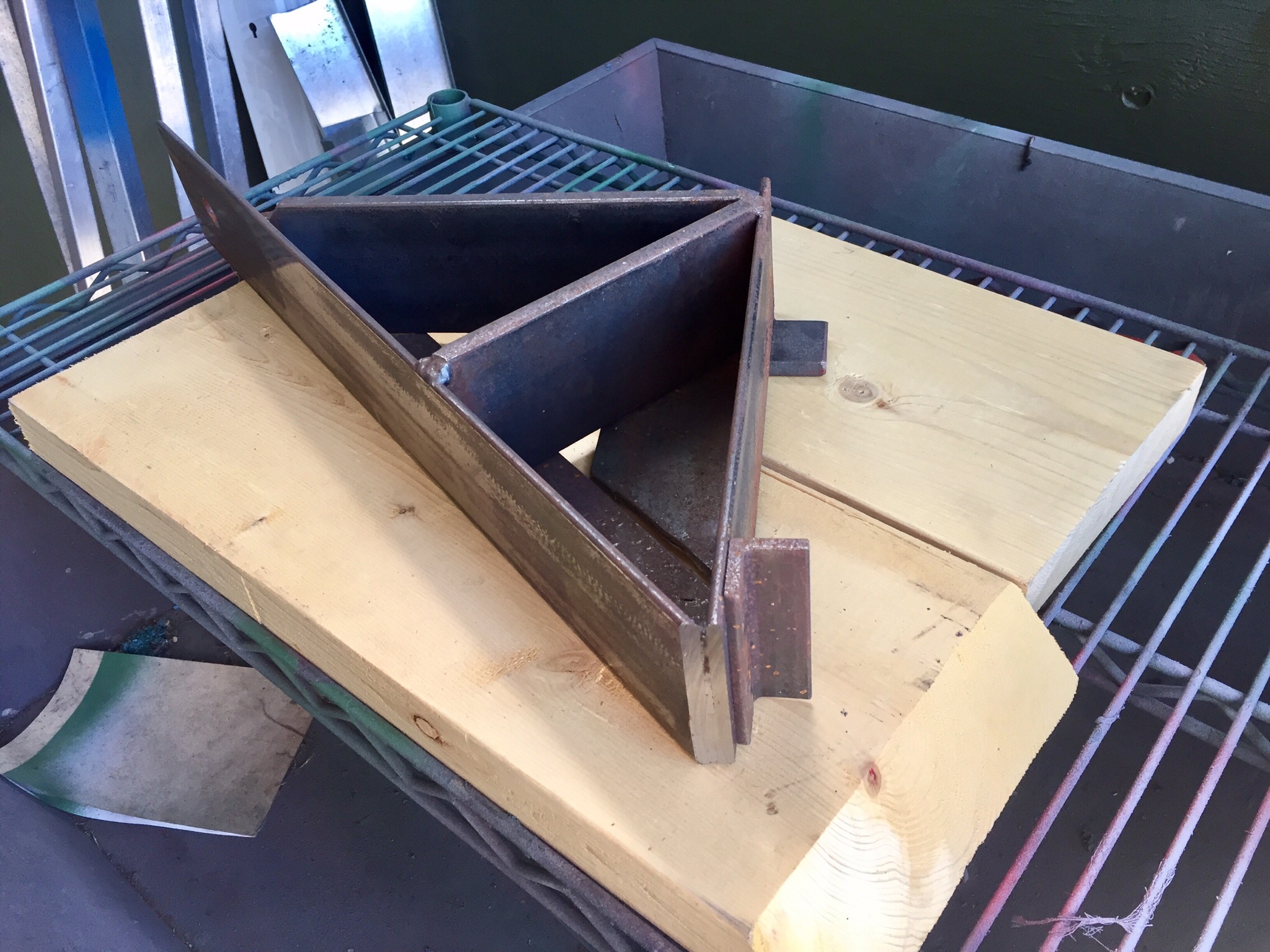

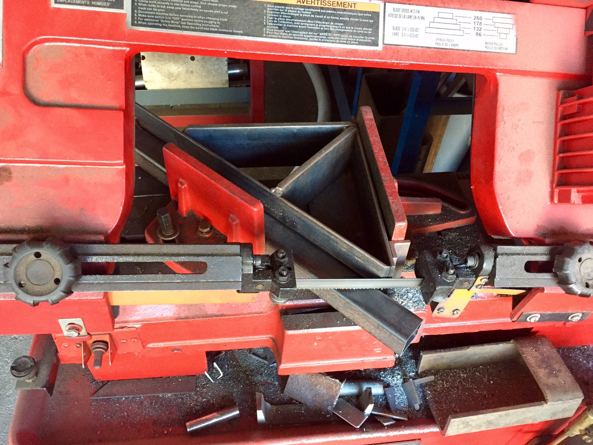

I took a page out of BukitCase's notebook and made myself a bracket for 45ー miter cuts on the bandsaw.
View attachment 514229View attachment 514230
It saves a lot of time re squaring the back vice jaw to the blade. Would much rather have an Ellis, but I find this works well for me.
Terry
Thanks for posting this! About the only thing I don't like about my little Jet bandsaw is trying to accurately set the fence to get 45 degree cuts and then get it set back accurately to 90 degrees. From you pictures, I fabbed up a jig and it works great.

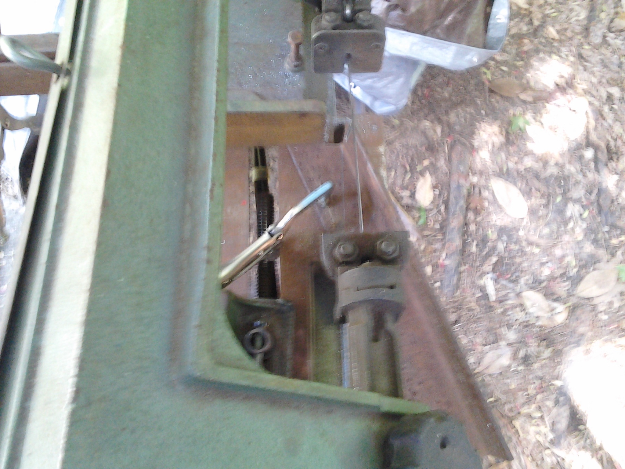

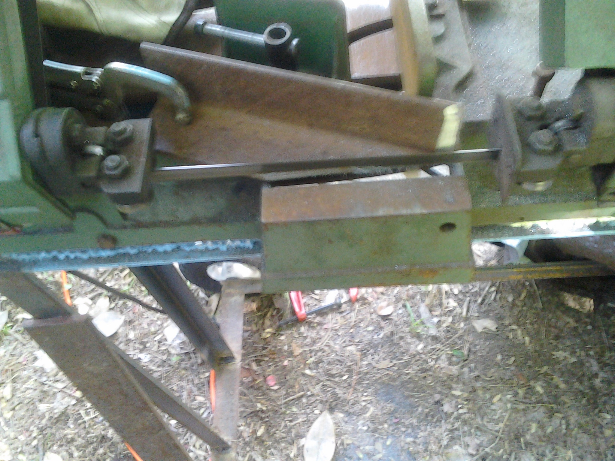

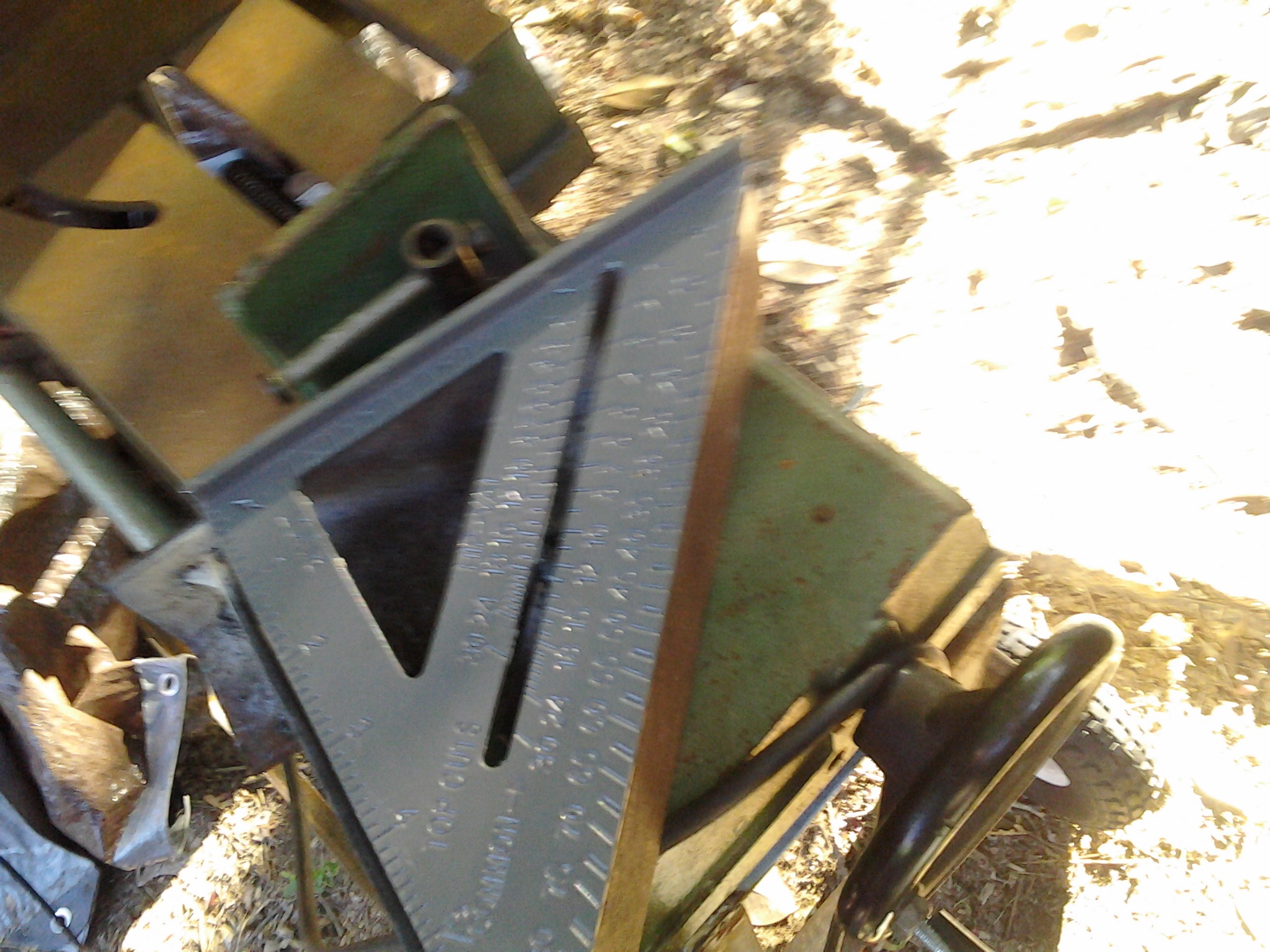

I went to work on one today. Of course I had none of the right stuff so figured that I needed a couple of goes for practice anyway I'd use what I had. Being me without explicit directions I began to think. This is becoming more and more difficult for me or at least the results are less and less reliable. So I says half 45 is 22.5 so I cut two 22.5's and I'll have the 45. Now how do I do that? Haven'd had a protractor since I left work. Come on Google - lead me to a forestry site that was suppose to have an Excel spreadsheet that you just punched in numbers - never did see that but they had a pdf of results and I did some more thinking and figured 12 inches on the big leg of a carpenters square and 4 and 15/16 down the small leg and that would be much closer to 22.5 than I could make it. So cut a cardboard templete and set my saw. Made my cuts and That don't look right. Got to fitting and twisting and figured if I pressed the 22.5 into my fence at 90 I'd be closer. What's that 112.5? I don't know but it's about right. Need one more brace and I'll have it welded up. Sorry no pictures (I'm out of electrical tape)

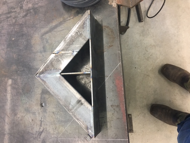

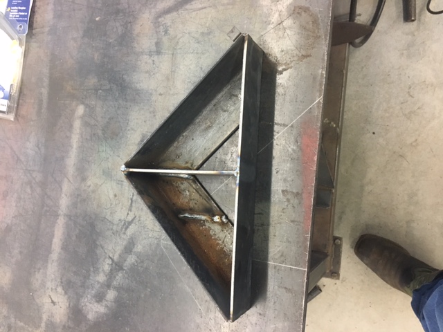

Are you making this more complicated than it really is? (Not trying to be a smart aleck) I cut two pieces of 2"x2"x1/8" angle about 8" long with 45 degree angles on both ends. Then, squared them up to make a 90 degree and cut a piece of 2"x1/8" strap to fit. Finally, a piece of strap to stiffen the middle and a little piece of 2"x1/2" channel to keep it in place against the fence. It all came out of the scrap section of my metal rack. One piece of angle had been partially cut and welded back, possibly from trying to teach my wife to weld.:) I need to clean that up, as it looks like chicken crap. Anyway, a little paint to finish it off and I'm done. Next, I want to make an adjustable miter gauge. These pictures show a view of the bottom and the top.

I'm sure this is simpler than I understood. Let me explain to myself.
set 22.5 angle
cut 22.5 angle the two did not fit as I expected
turned the saw fence to 90 butted the 22.5 cut into fence clamped and cut
needed some adjustment (what did you expect?)
45 looks close not bad for practice
will use to try some test cuts soon
