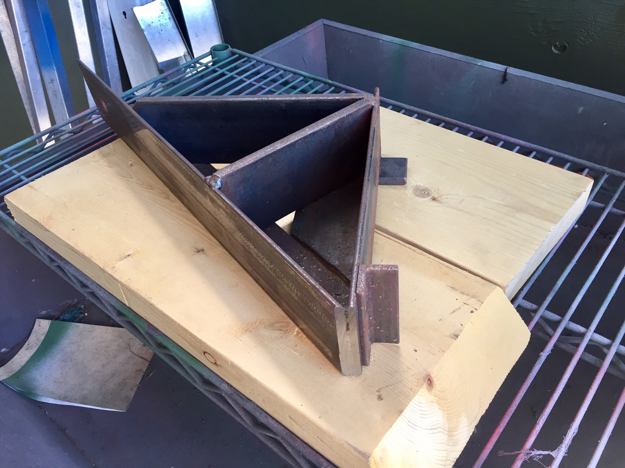

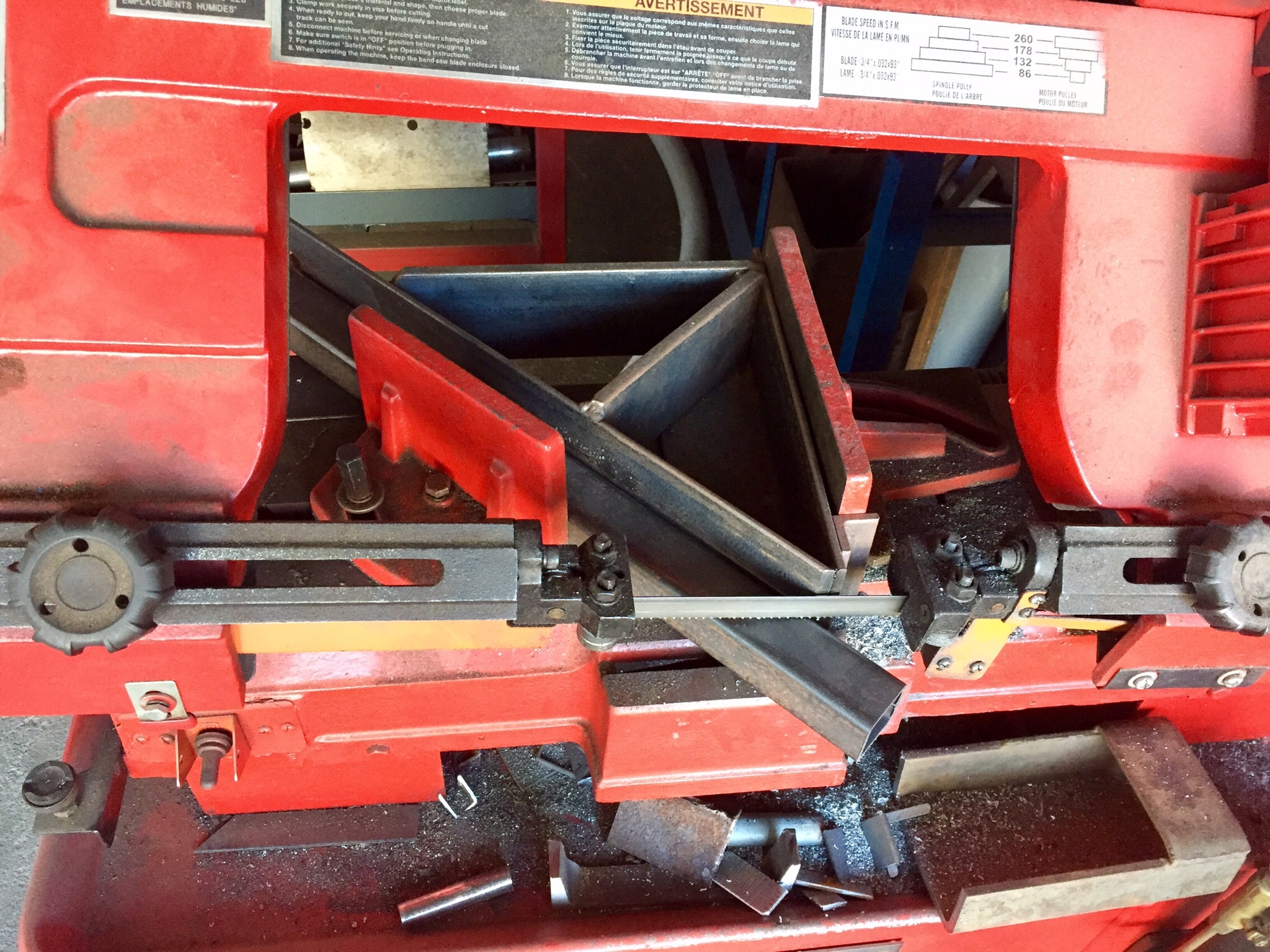

I took a page out of BukitCase's notebook and made myself a bracket for 45° miter cuts on the bandsaw.
It saves a lot of time re squaring the back vice jaw to the blade. Would much rather have an Ellis, but I find this works well for me.

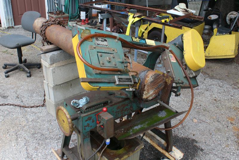

Buddy of mine called me the other day wanting to know if my old WellSaw saw could cut 8 inch round steel. I said I think so... He shows up with a 63" piece of 7 1/2" round steel that weighs as close as we can estimate about 825 pounds. Made two cuts, one to clean up the end and another to get the 36" piece he needed to build a power hammer. I paid $150.00 for this saw and use it constantly No way would my chop saw do this..
View attachment 514229View attachment 514230
Terry
I really like that. Would a mirror image of that work? I've got the cheap HF model, what measurements would you need and do you take pay pal?
Pretty easy to make your own. Try PM-ing tbn member BukitCase as he will have better details on file than the description I could give you.
Terry
   / Band Saw vs Abrasive Chop Saw #48
I'll save you the PM, here's what I did - most pics of the adapter are near the last of the thread, there's also a sketch of what I THOUGHT I wuz gonna build :rolleyes: -
