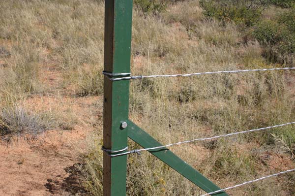

The post come pre drilled for the braces to bolt on. The angle braces are also about 2 to 3 feet in the ground a in concrete. You will not pull one of these down with any kind of wire. These are the same braces that most highway dept use along the highway. The wire is just wraped arond the post it stays in place. The takes a little practice to get the wraps tight. The trick is to use your fence tool to hammer the wire into nice corner turns on the post. Here is a close up.

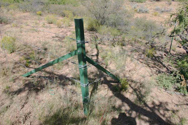

Here is a real 90 degree corner post

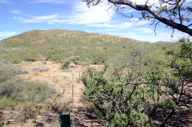

Here is 1/4 mile of my fence if you are interested.

JimBrown, Thanks for the info and photos. I like this concept but have not seen them available locally. Was thinking about making my own with purchased iron. A couple of questions: 1. Are the braces mitre cut on an angle where they meet the post? 2. Are the braces bent on an angle to go vertically in the ground/concrete or do they just go in the ground on an angle? Thanks!

They are not mitered there really is no reason and they are not bent on the end. I just dig a regular post hole and scoop out the angle side if I need to
