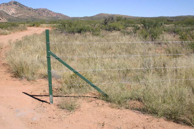

Here is my steel corner post. 3 inch steel angle iron 3 feet in the ground set in concrete. This is the most common type of corner post around here. You can buy at any good fence company or feed store. I also have some wood corners but I prefer these as they will be there untill some one pulls it out. I have built about a mile and half of four strand fence in the last 3 months. I put my roll of wire on a pipe and put it in my bucket i can then pull it off as I walk or just back the tractor up and let it spool off. You need a good fence tool. That is a single tool that is a hammer, pliers, cutter, staple puller, wire twister. I strech the wire with my BX. I clamp the wire to the bucket with a pair of vice grips and then slowly back the BX up. You got to be careful are you will pull down the corner post.

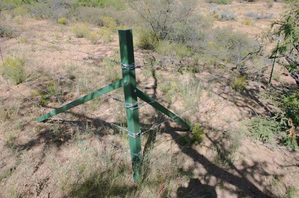

If you are going to have calves or small cows you will need stays. If you do not they will put their head beween the wire and just walk thru it. The stays are the upright wires in this picture.

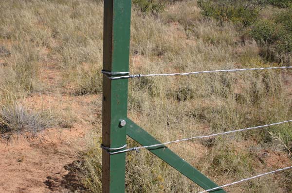

Here is a pic of how I do the C holders to the T post. The purpose of the C holder is to keep the wire from sliding up and down the T post not to keep the wire tight. To install you simply hook the hooked end around the wire and then take your fence tool and wrap the the long end around the wire. Takes about 5 seconds.
