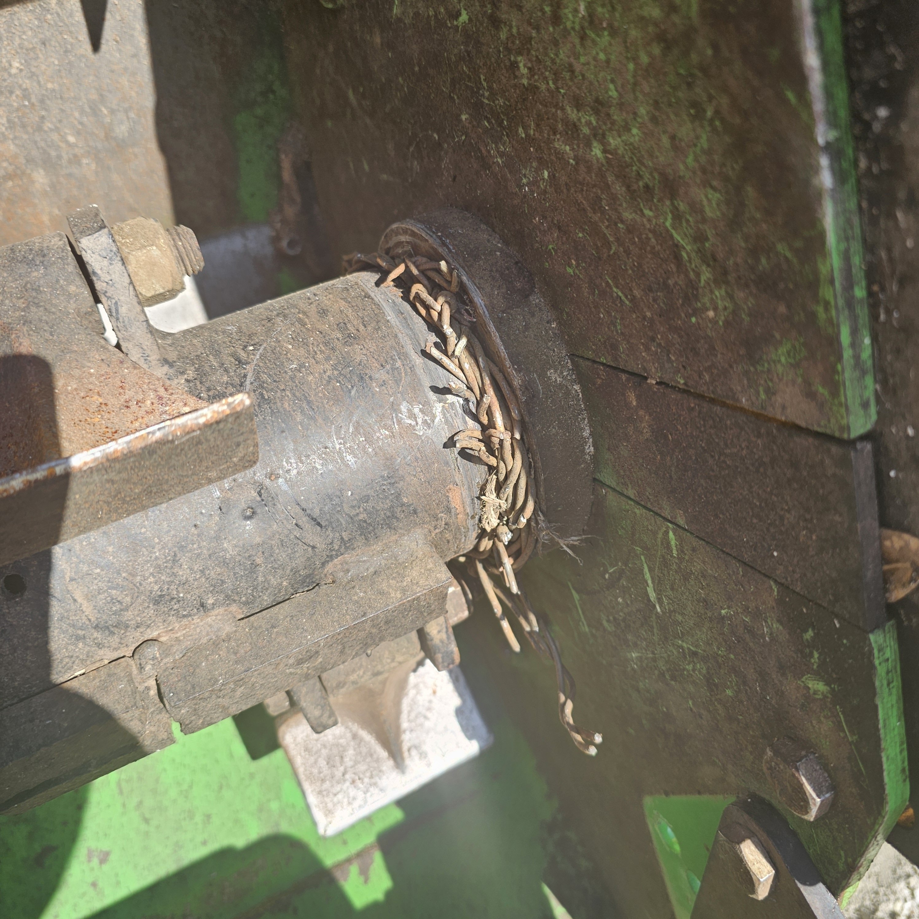

Got the pulley to come off. No lube needed. It would have taken a lot longer without all of the help. Never used a taper lock before.
Hello Torvy,
Please be sure to use a torque wrench for the taper lock screws and
a bead of blue Loctite on the taper lock screw threads to secure the
taper lock bushing.

Thanks all. Using @leonz idea, I was able to get it off of there. Since it's a ditch mower, setting it on its back was tricky.
It's all put back together. Lube and testing will have to wait until tomorrow. The beauty of retirement. I can stop before I hurt myself and do more work tomorrow.
I thought about using the dremel, but I'm out of the grinder wheels. Hopefully there won't be a next time.

Just enough here to stop rotation. It's free now.

Sometime ago, I caught a decent length of fencing net with my cutter. While it looks bad, since I run chains and not blades, it was a matter of finding one end of the fencing and just uncoil it.
I've also completely destroyed an old cast iron stove hiding in the brush with this cutter.

I ended up testing it yesterday anyway. Weather showed rain today. Turned out we got some in the evening. A couple of drops while I was wrapping up.
Worked like a champ. Now I can hopefully walk around without so many ticks joining me.

I suck up wire in my drum mulcher regularly. I carry a set of 10" bolt cutters from HF. Can usually cut it out pretty quick.
