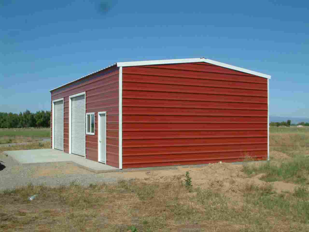

I have a 30X36X10 barn and I have two doors on the gable end, a 16X8 roll-up and a walk-through. I can drive two vehicles in side by side and have room on the sides for storage and my work bench. I also have two windows on one side. You need a walk-through door as I am assuming that you will not want to open the roll-up every time you go in the barn to get a shovel or rake, etc. I also have a boat that I park in the barn. If I could do it over again the only thing I would change is the height. I would make it 14' high instead of 10' so that I could double deck part of it for more storage. Also, if it was higher, I would be able to put in a two post lift to work on the cars a little easier. The one big door in the center of the gable end allows access to anything in the barn and still leaves the corners available for storage. Good luck with whatever you decide.
