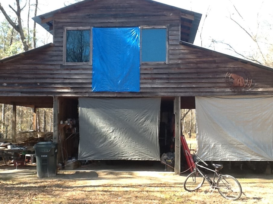

Sorry about the picture being upside down guys.

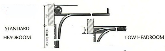

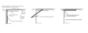

XFaxman- no I was not familiar with the low headroom doors. I will measure my opening and see how much room I have to work with. Can you purchase rustic looking roll up doors? I am going to redo the barn and get rid of those windows and put new cypress siding on it.
Thanks

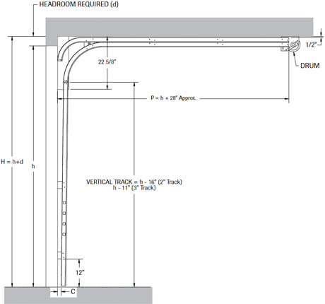

XFaxman- no I was not familiar with the low headroom doors. I will measure my opening and see how much room I have to work with. Can you purchase rustic looking roll up doors?---------------------------
Thanks

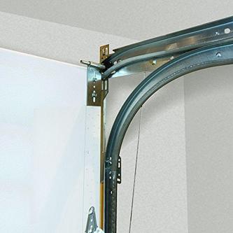

Yep: rustic looking overhead door
But the keyword is 'overhead' so not to confuse it with this roll-up type:

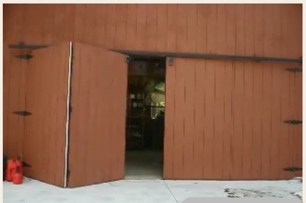

My barn doors have a single roller at the bottom at the edge of the opening. When you install the stop bolt, set it so this roller has an inch or two of engagement. If you have 6" of overlap to your door, this will allow the door to open fully and the bottom will be always engaged. To dog the door, you'll need to cam locks, one at either end. Flip the lock and it pulls the door tight and the wind can't blow it open. Too easy.
