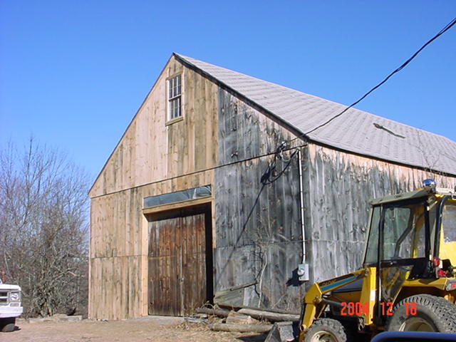

/ Barn doors #26
</font><font color="blueclass=small">( Willy,
Jim,
Like that barn, is that a window above the door? )</font>
Thanks, Yes that is a window over the door. I have the window in my heated garage as I am working on it. I just put 16 panes of old glass into it. The window is 12 feet long.
/ Barn doors #27
JimR- Your doors are on the inside of your barn aren't they. If I'm remembering correctly, you are the guy refurbishing your existing barn... mortise and tennon joints on some of the framing... nice job! I would sure like to talk you into some pics of your top and bottom tracks on your door. Placing my doors on the inside may solve the wind problem. I'm thinking that a 3x3x1/4 angle with headed studs set in the concrete so that both legs are at a 45 degree angle to the floor and the heel is pointed up with a small wheel with no tire to run on it may make a good bottom track. Do any of you guys that have bad experience with track doors have them set on the inside rather than the outside of the building? )</font>
Yes, I am restoring this old barn. My doors are inside mounted. I will snap some pictures of the track and wheels for you today if I can. My doors do not requre an upper track. I have a board that I routered out that is fastened to the beam above the door. It hangs over the doors to hold them in place.
