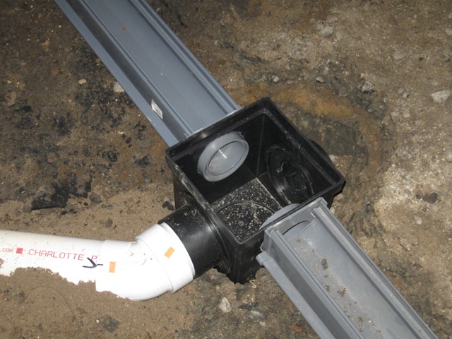

Ok so here is the deal, Have a 42x42 barn build and it's about 1 foot out of level on one side where we are putting on the stalls. If I get home before dark in the next week will take pictures.
What I was planning on doing for the stalls is to slope the dirt towards the center then dig out a small trench leading out of the barn. Thinking for the trench about 6inchs wide and 6 inchs deep. Putting about an inch or two of pea gravel (10mm wash) the pipe for the drain. After this I was going to fill in the trench and an inch or two above that in the 12X12 area (Stall side) that is sloped. Then wrapping the landscape fabric over that. Does this all sound correct? Was advice from a coworker as I've never done something like this.

One side of the barn that I'm putting the drainage in will have 3 stalls for horses. The other side of the barn is for storage (Tractor, hay, maybe a washbay one day, tack, etc) and we were planning on leveling the floor with maybe gravel then putting thick rubber interlocking mats down.
The goal is for any runoff from the stalls, the bedding should absorb it mostly, but want somepalce for liquids to still drain away.
I should add that I was planning on doing the french drain around the outside of the barn also for rain/snow runoff to keep it away and was going to tie the drain from the stalls into it.

First, define "dirt". Is it clay? Topsoil? I.e. will it hold water or allow it to runoff to your drain? Remember this base of "dirt" will be under your mats and may not dry out. Have you ever pulled a mat in a stall that holds water? Gagging time! Which is what I think you're trying to prevent.
If I understand you correctly, your stall trench will be backfilled with "dirt" from about an inch over the pea gravel to an inch above the trench. This would mean the water/urine would run toward the trench and have to penetrate the "dirt" that is in/over the trench to get to the pea gravel/drain pipe. Is that correct? If so, the composition of the "dirt" is a factor. If it packs hard which is good for the sloped portion, it won't allow penetration in the area over the drain. If its permeable, it won't allow the sloped portion to move water TO the drain.
Second, I wouldn't put sand directly under the mats. Sand will move with horses laying down. We've got several stalls that are tough to "muck" because the mats are hunched up from horse activity due to a less than stable (no pun intended) base.
For porous systems, I'd lean toward a coarse gravel base over sand fill with a finer gravel (not pea gravel) top layer followed by mats. Pretty solid, yet will allow water/urine to drain down. Then put in a perimeter French drain system next to the stalls if your land doesn't drain well on its own.
Mats over concrete seem the best. I would do it what we did on the wash stall at our barn. Basically the same as you are designing but with concrete sloped to the center with a drain down the middle. We used a commercially available horizontal drain system (Home Depot). see attached pix. If you do the labor yourself, concrete isn't that expensive, considering what you'll have invested in mats, stall fronts, etc.
