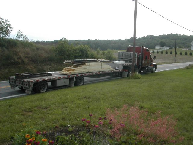

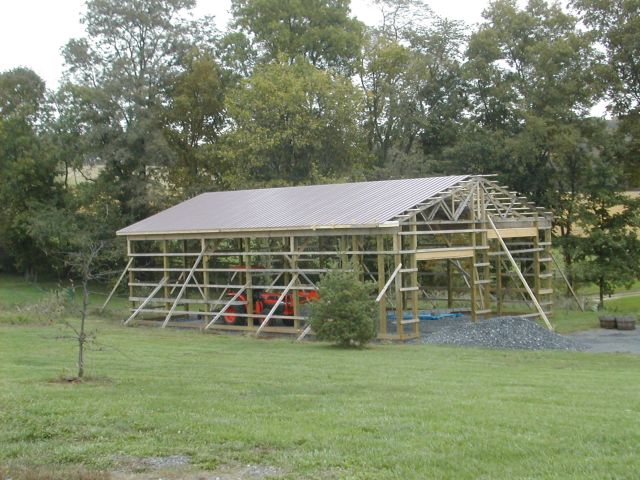

On june 8, 2006 I took delivery of a pole barn package. Today, 4 yrs to the day, I finally got concrete poured. I didn't realize the same date until I was looking at the old pictures.

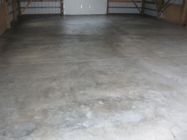

Tomorrow they will cut control joints, and I will apply cure and sealer.

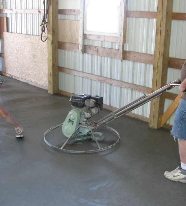

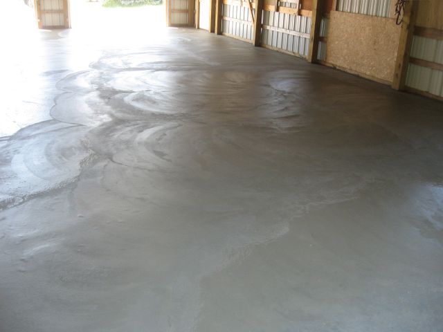

I don't think I ever ran my own thread on the barn, but have added pictures here and there. The barn was a package I bought and built myself. It is 30x48x12, with a 10x10 door on one end centered, and two doors on the other end, one 10x10 and the other 8hx10. The joints got cut this morning. I'm taking a break from cleaning up the saw mess. I swept as much as I could, now I am hosing and squeegying the water off. I don't want to use pressure washer on the new concrete yet, so am using garden hose.

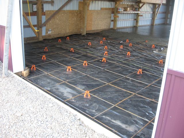

I did the prep work for the concrete, I leveled gravel 5.5" under the floor level, and put in vapor and the rebar. No electric yet, but I did put in two 2" conduits and a 1 1/2" conduit thru the slab and stubbed out.

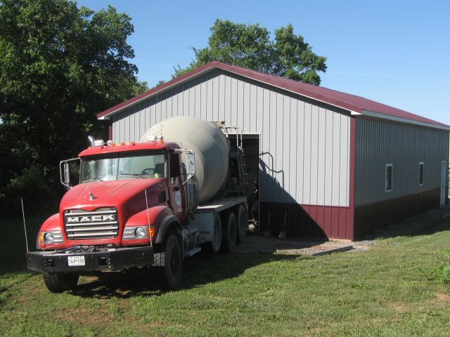

I figured on 6" deep of concrete, but he ordered an extra yard, and it was a good thing he did, as I only had enough left over for a 3'x8' pad in front of the mandoor. 3 loads 9.25 yds each. The barn looks small with a concrete truck backed up to it.

Nice looking floor, I really like the rebar grid with chairs, most of the concrete guys around here want to use wire mesh, you really have to beat them over the head to make them use chairs, but of course they will charge you a pretty penny to do so.

Vocomp-20 it's a Curer / sealer. Got it at the local brick / concrete supply company. It can go on immediate after the water has evaporated and you can walk on the concrete. HD also sells a concrete sealer, and a curer/sealer.

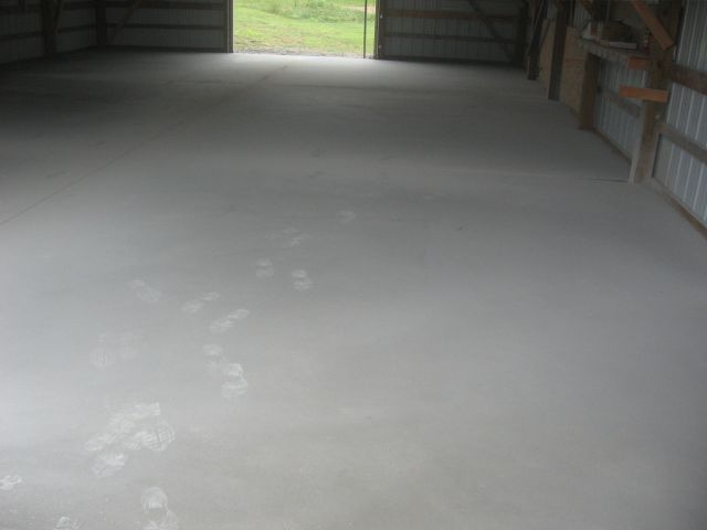

applied 2 coats of the curer/sealer. It said it would cover up to 300sf per gallon, so I bought a 5 gal bucket and an extra 1 gal jug. It only took about 2.5 gal for the 2 coats, but it's all I'm doing. I still need to fill the control joints with a caulk.
Added a couple other pictures from construction, one is using the tractor to set the roof trusses, and one putting on the roof metal.
