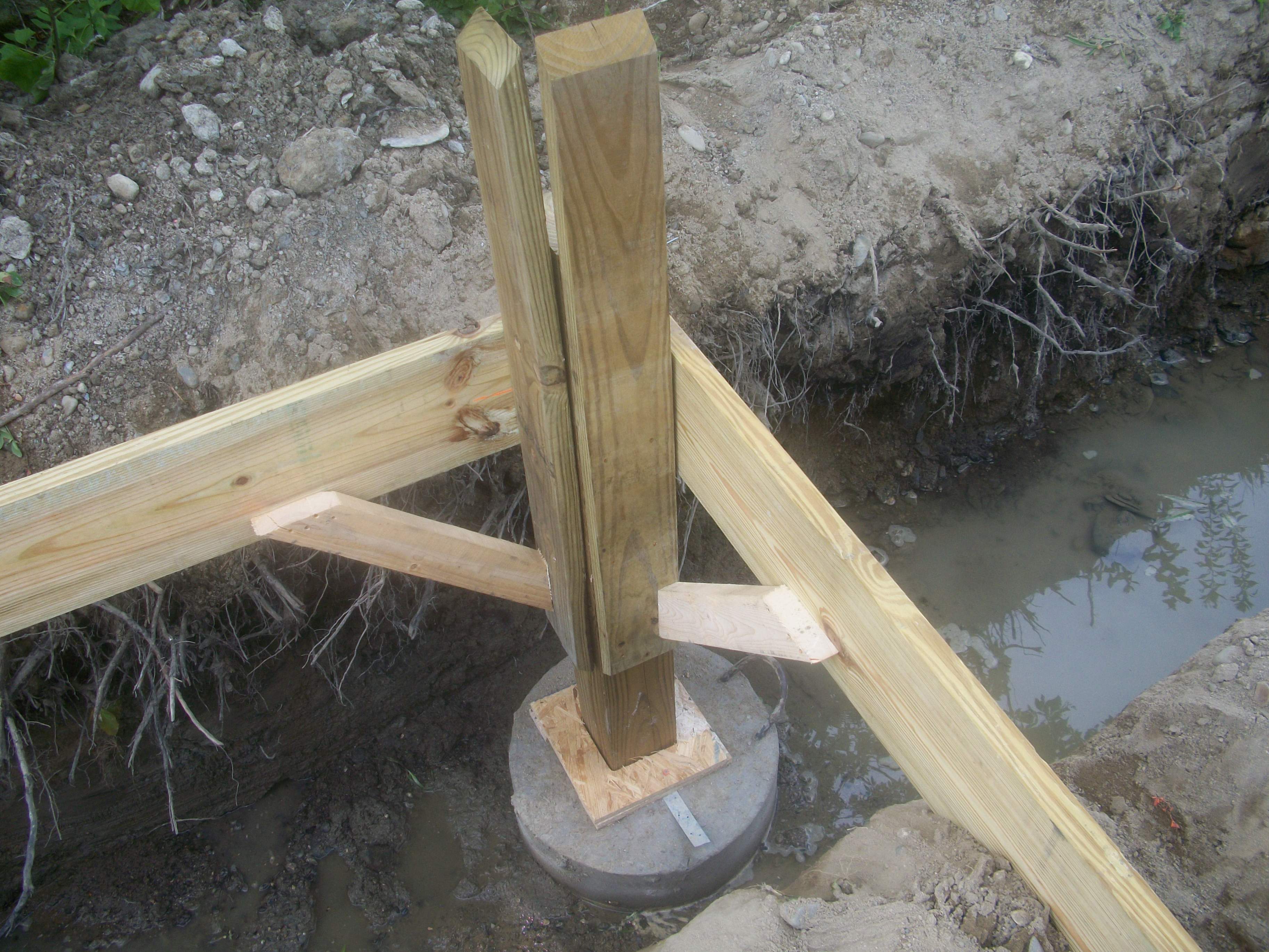

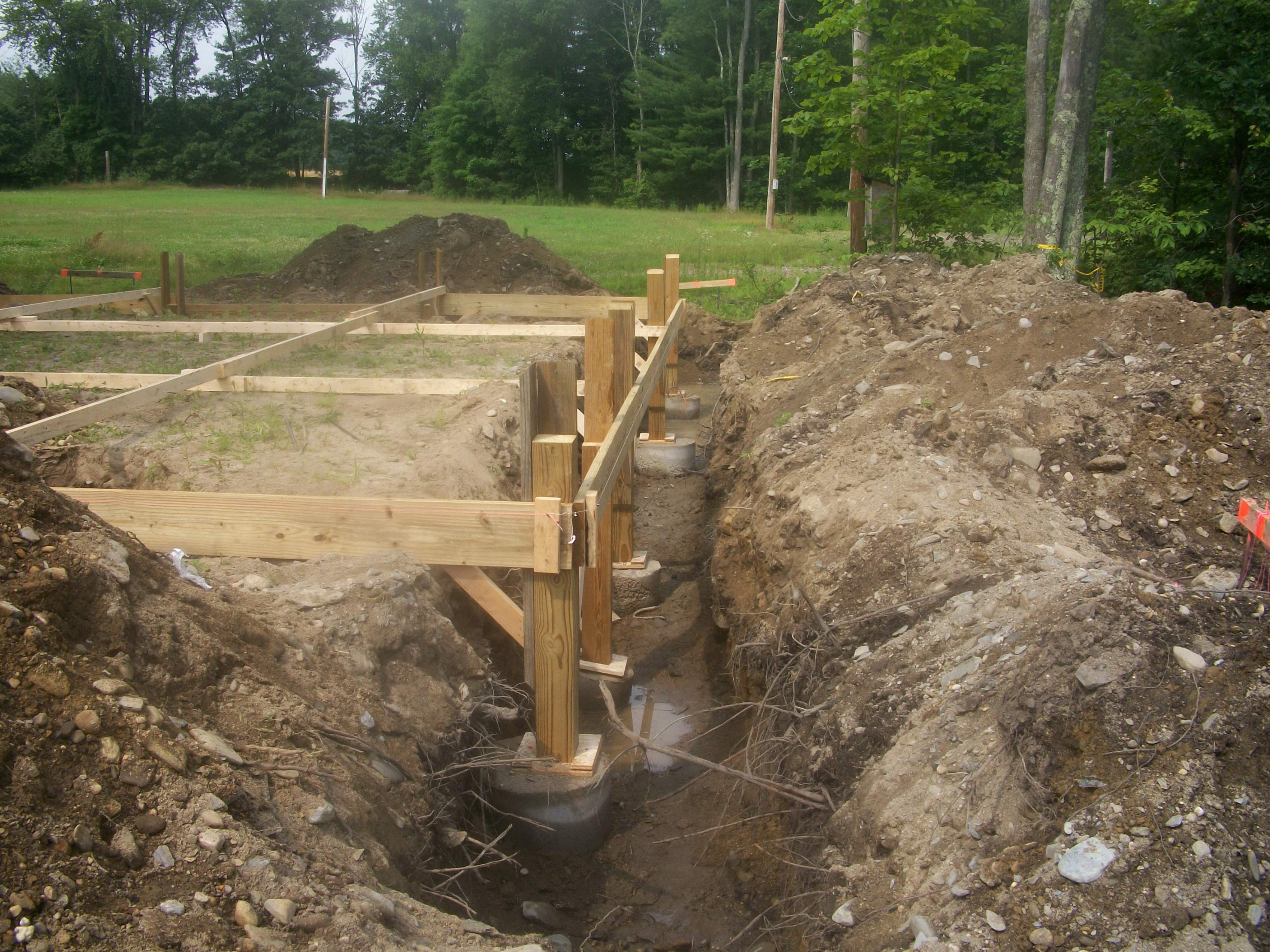

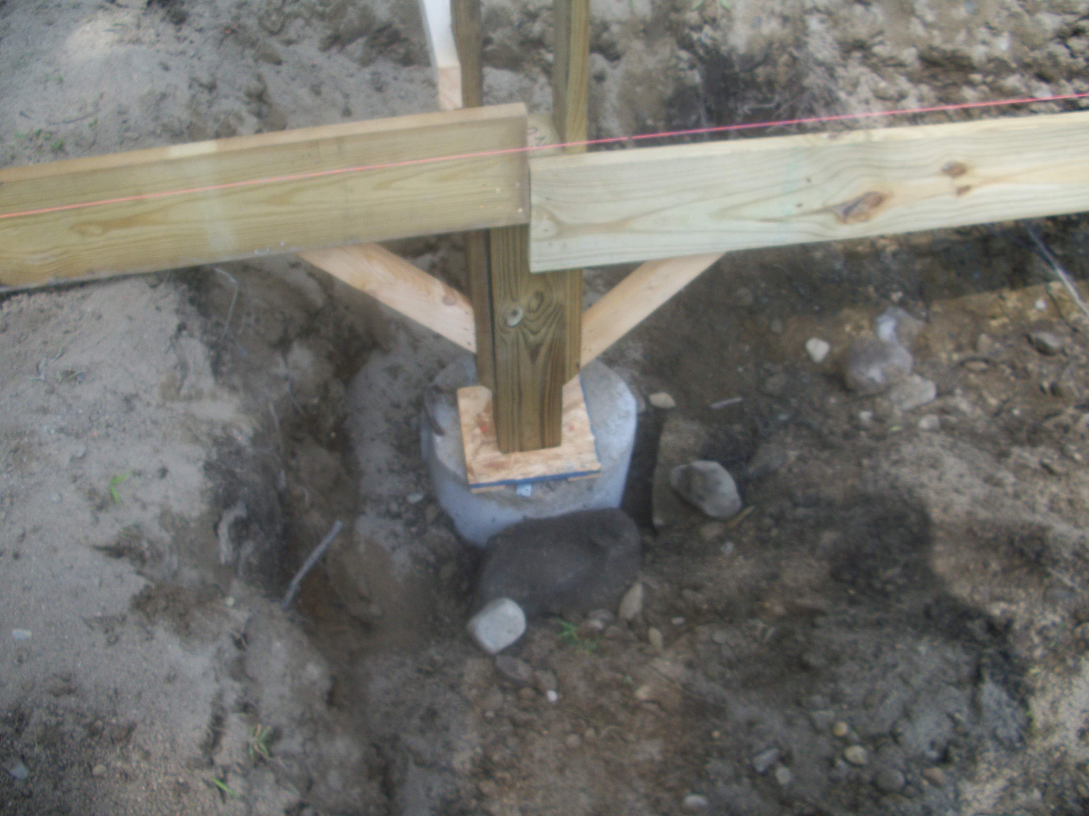

This is a variation on your method. Precast concrete footings formed using cut plastic 55's as forms. When these are poured, galvanized straps are cast in. The square OSB board that sits on the concrete is a sacrificial piece that has a hole cut in it that matches the post dimension. Then when these short posts are "squared" off, the galvanized straps are then nailed to the OSB blocks These blocks keep the posts from kicking out during backfill. These short PT posts extend a reasonable amount above grade then the non-pt posts are added supported by the "sistered" 2 x ? pieces.
I don't understand this at all. What is the beifit of pouring concrete below grade and then having a post come up the rest of the distance, but ending above grade?
For what it cost to do it this way, why didn't you just put 4x6's or 6x6 posts in the hole and build from the biggest, most solid post you could use?
The concrete is not poured. these are precast. benefit is you get approximately 700 sq. inches of bearing surface vs say 36 if you use a 6 x 6 post.

this is a cost effective alternative vs. using pine posts or PT posts that are full length.
This is a barn that was built at our fairgrounds by one of the larger barn builders in this part of New England. And this thing is SQUARE!
