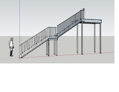

The picture is a partial diagram of what I'm doing in my barn. The top deck is 12' high and is 4'x9'. I plan to use a forklift to put stuff up on the deck and pull it into the 2nd floor storage bay. There is room at the end to put in a hoist if I decide i need to do that.

Thanks for the picture.
Very nice, hadn't thought of using a platform. Each end of the second story overhangs the lower level by about 12' so I can drive a hay wagon up underneath it, I can use those doors as a platform to load things.
