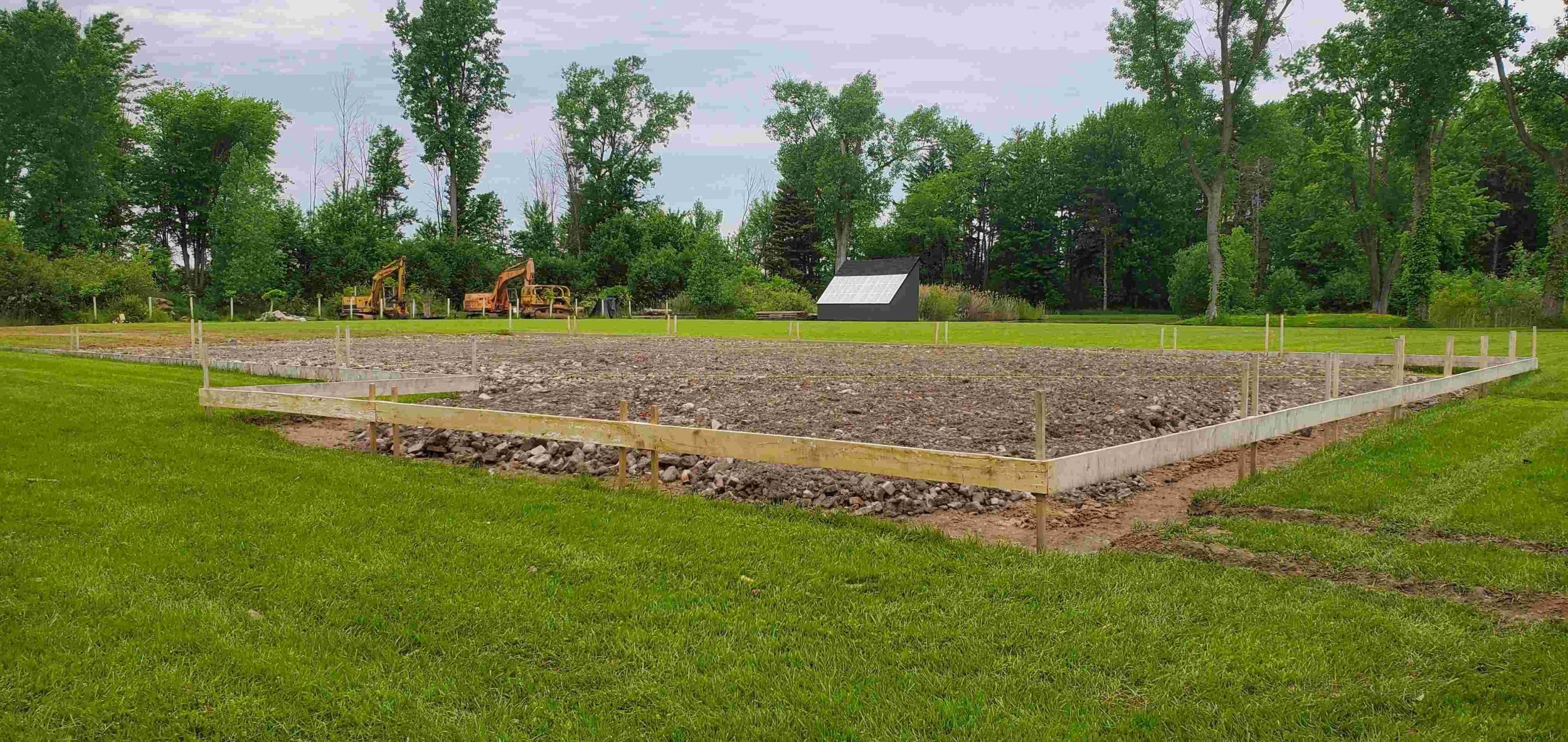

Nice to see your project is getting started.
I'm curious why you didn't use dirt to build up the pad before setting your forms?

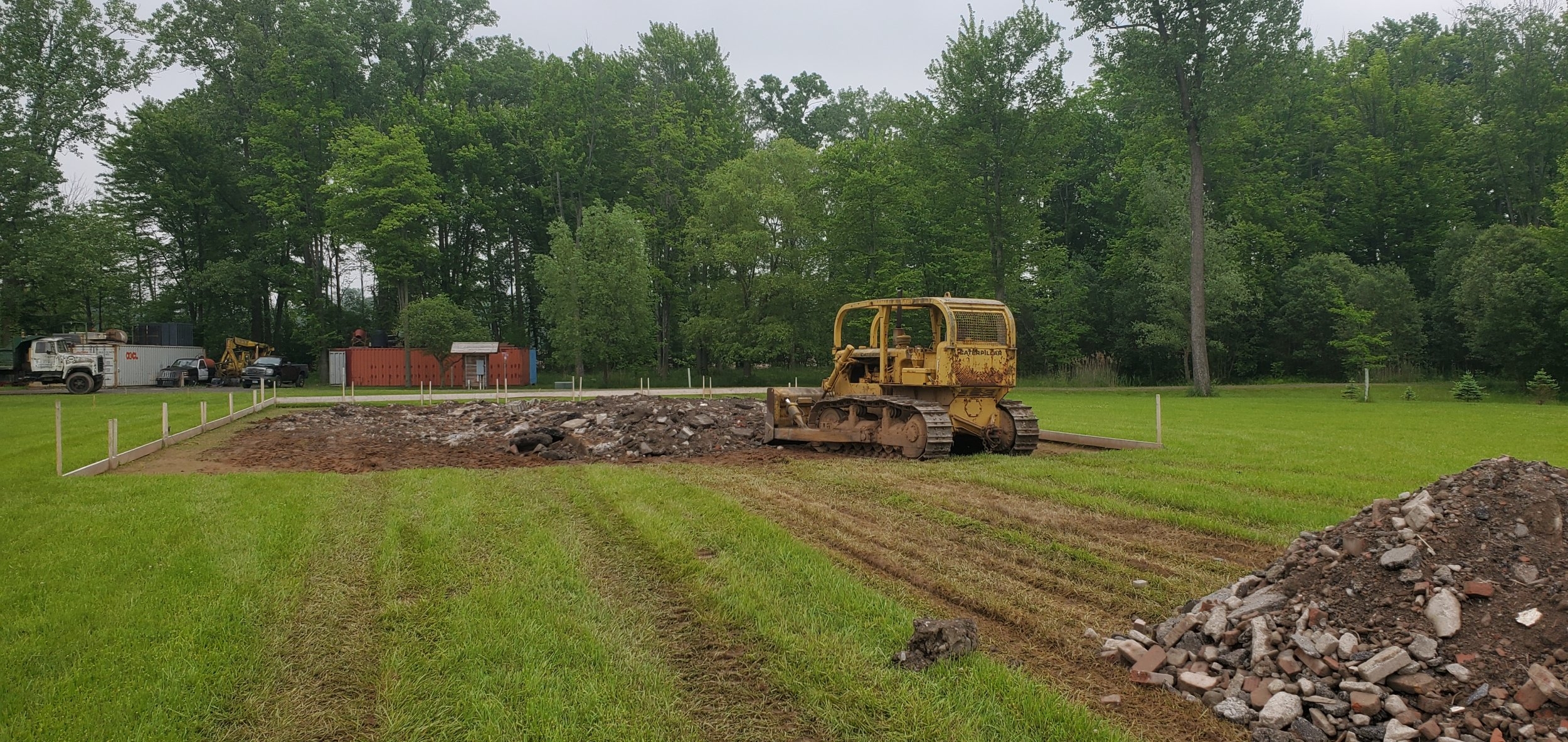

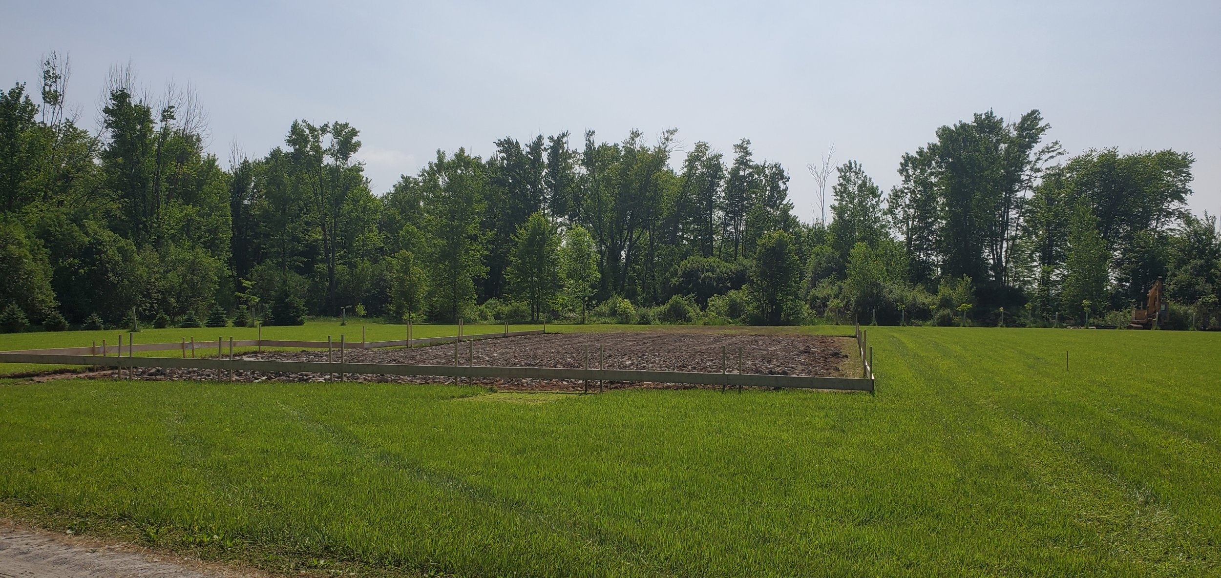

Those "forms" are only there because I have a sawmill and a lot of fallen dead ash trees. I wanted to give myself a rough guide for leveling off the area as I don't yet have a laser. I'd never buy lumber to do that. Those forms are ~2ft outside the perimeter of the shop walls so the posts don't end up so close to to edge of the stone base making it harder to auger the holes. Eventually I will backfill up to the other side of the forms with dirt or driveway stone then rip them out. A lot of times I just leave the forms in there to rot away, it's what I did with large portions of my driveway when I backfilled the edge with dirt. But I won't leave them in there for this building.
As for dirt vs. hard fill. The guy I bought the fill from had dirt, but it was mostly clay. My soil is sandy loam for about 6-7ft down before getting to clay. I didn't think it was a great idea to put clay under the slab when there is sandy loam underneath it. I have a very high water table in the spring, so I went with hard fill primarily because it drains better than clay.
It took a lot of tracking back and forth to crush up the material with my D6C, but eventually it turned out pretty decent.
I'm probably going to need 2-3 more loads of hard fill then switch to 2" crusher run.

So after (13) 20 ton loads of hard fill and a bunch of passes over it with my D6C to break up the larger material, I am ready for stone. The stone will be placed primarily around the perimeter where the holes will be augered for the perma columns.
I am deciding what type of stone to order. I know that I want crusher run, which has fines in it for compaction. The question is what size?
Here are my choices:
I'm thinking the 2" crusher run. Is there any reason to go with finer material? Remember that in one corner this material will be 26" deep. The forms will hold the material in at the top but I am purposly leaving the bottom of the forms open so the stone can slope outward at the base. It will be backfilled with dirt at a later date, likely after the barn shell is up. So it has to hold the slope during the post hole drilling process.
The perimeter of the forms is larger than the building layout, and at the deeper corner the post holes will be drilled 3ft from the edge of the stone. I did this in the hopes the augering process does not disturb this slope. I dont want to backfill prior to the barn shell going up as that makes it a muddy mess around the worksite if it rains.
