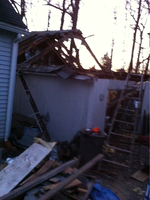

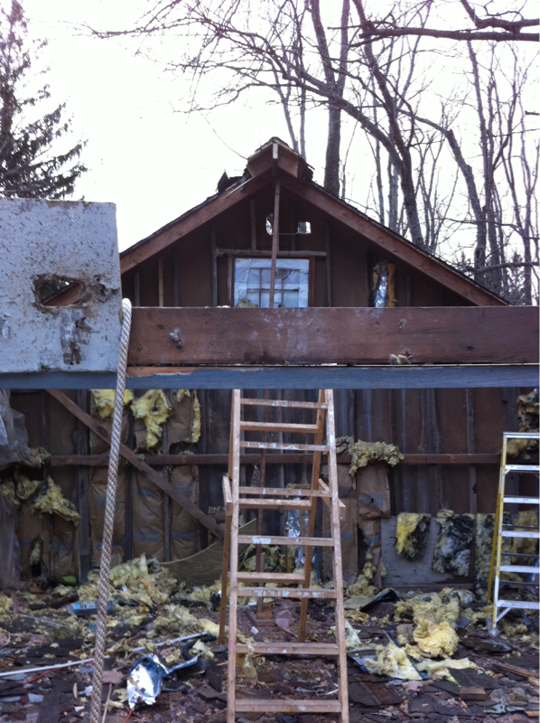

I took this in a couple of days by myself just start from the top and work your way down.This old garage had a bad lean toward the house,but there was a bunch of good lumber.My neighbor wanted to pull it down but I was afraid of Murphy's law.
