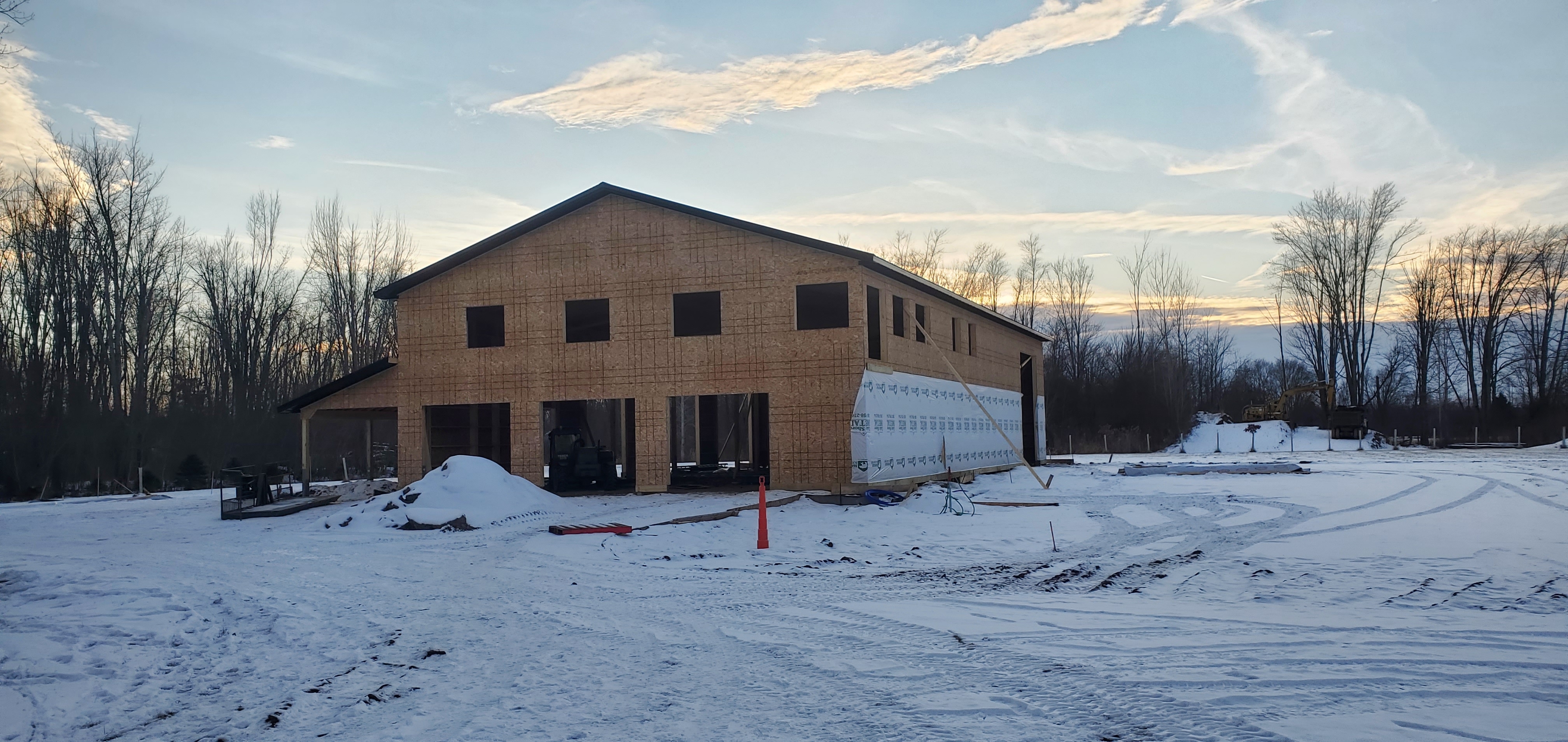

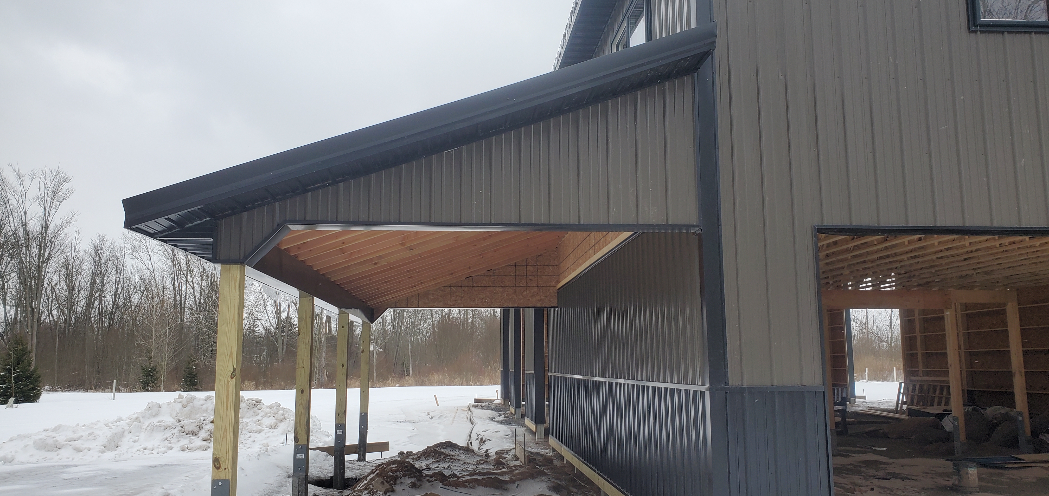

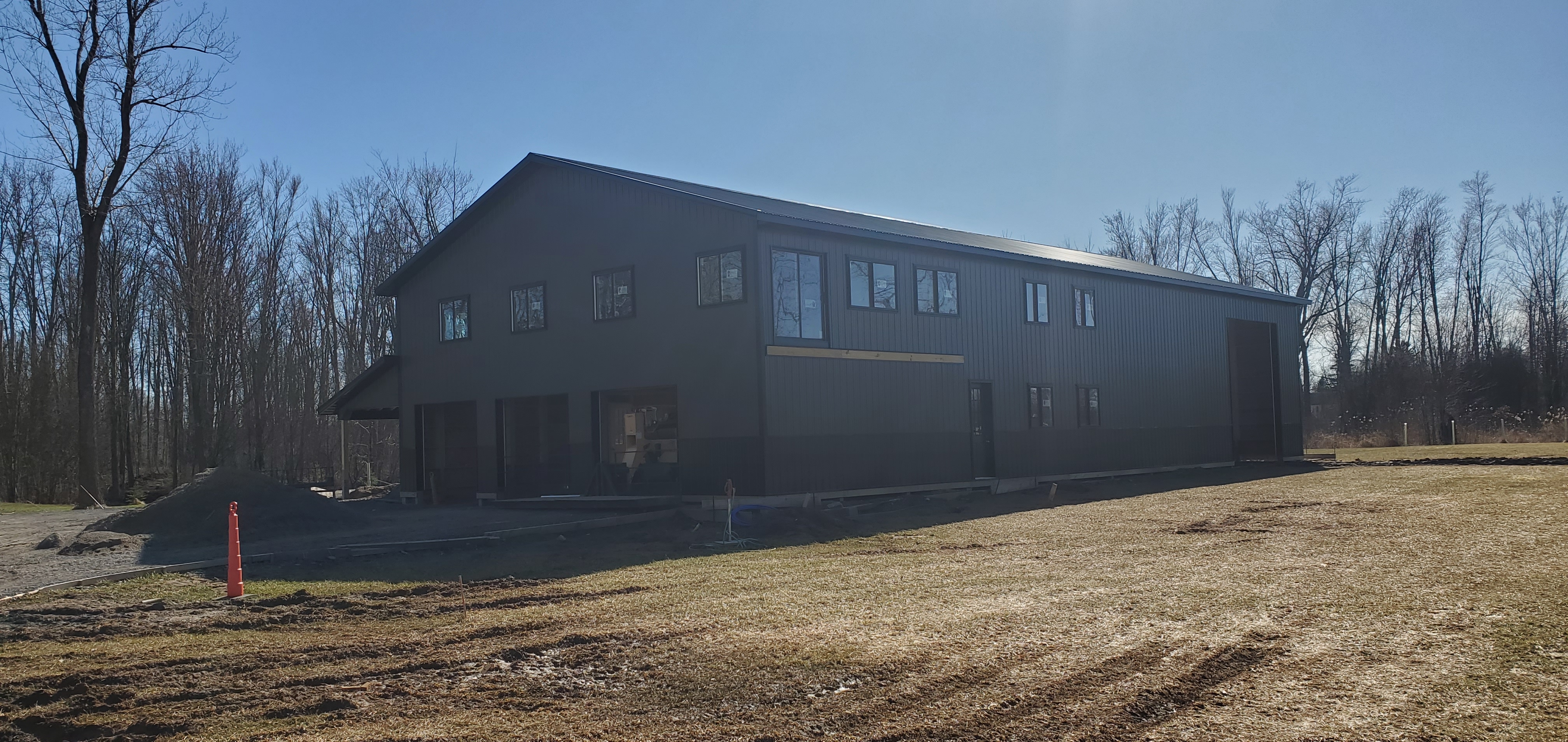

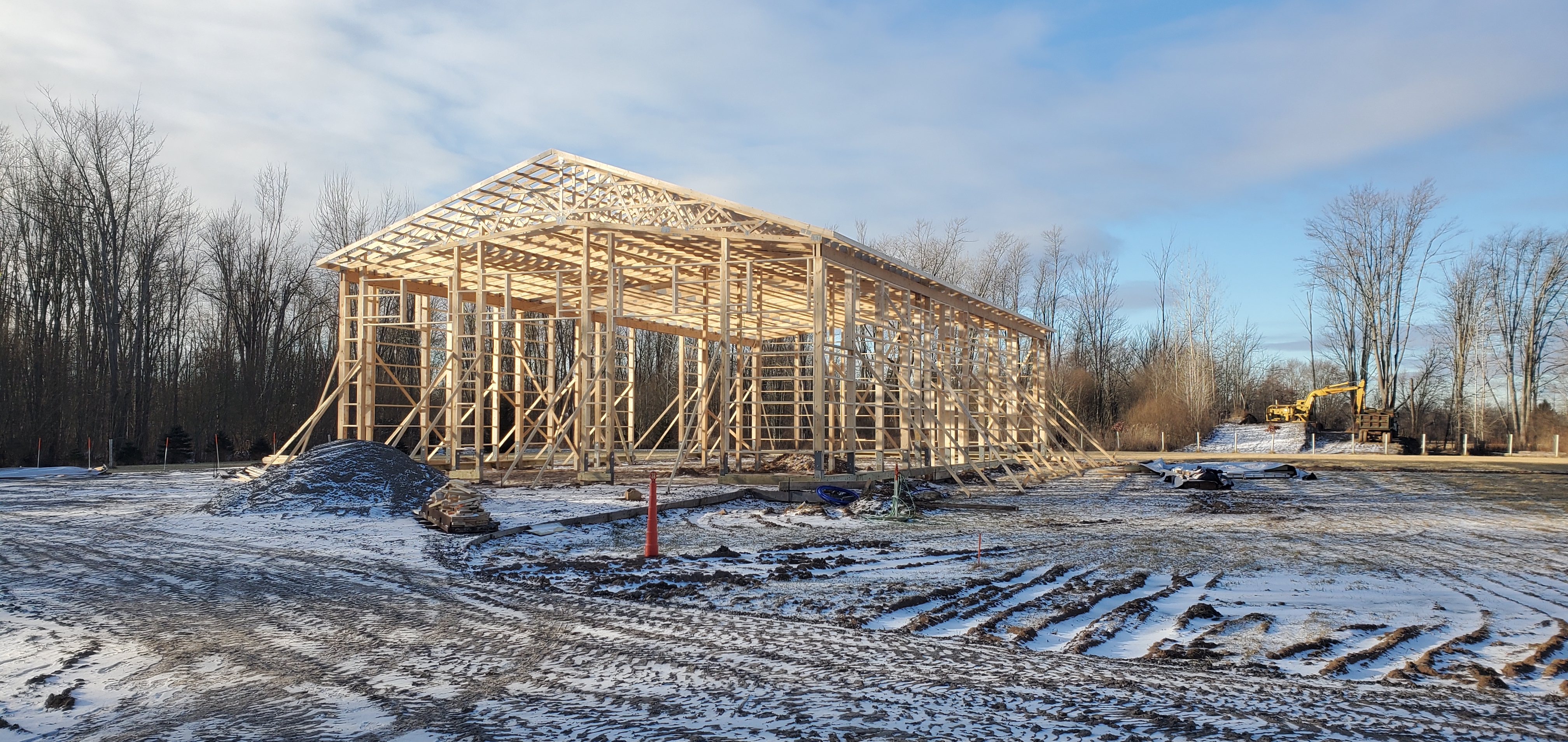

The Amish crew worked through the winter to get my barn shell up. I had to go with them, because I could not find anyone else who would do the work. Nice guys, but their quality of work is far from top notch. However, it is what I expected from Amish builders and was able to work out most of the issues with them.
This is as far as the Amish guys will take it. I still have not found any contractors willing to finish the interior, may have to start working on it myself. They were at least willing to install the living space floor truss system and subfloor, so at least that part is done.
I can probably do must things myself, however would like to get a plumber and electrician on board. I don't really want to do the under-slab plumbing myself.

You've had a very busy winter!!!!!!
Congrats on getting so much done, it looks very nice.

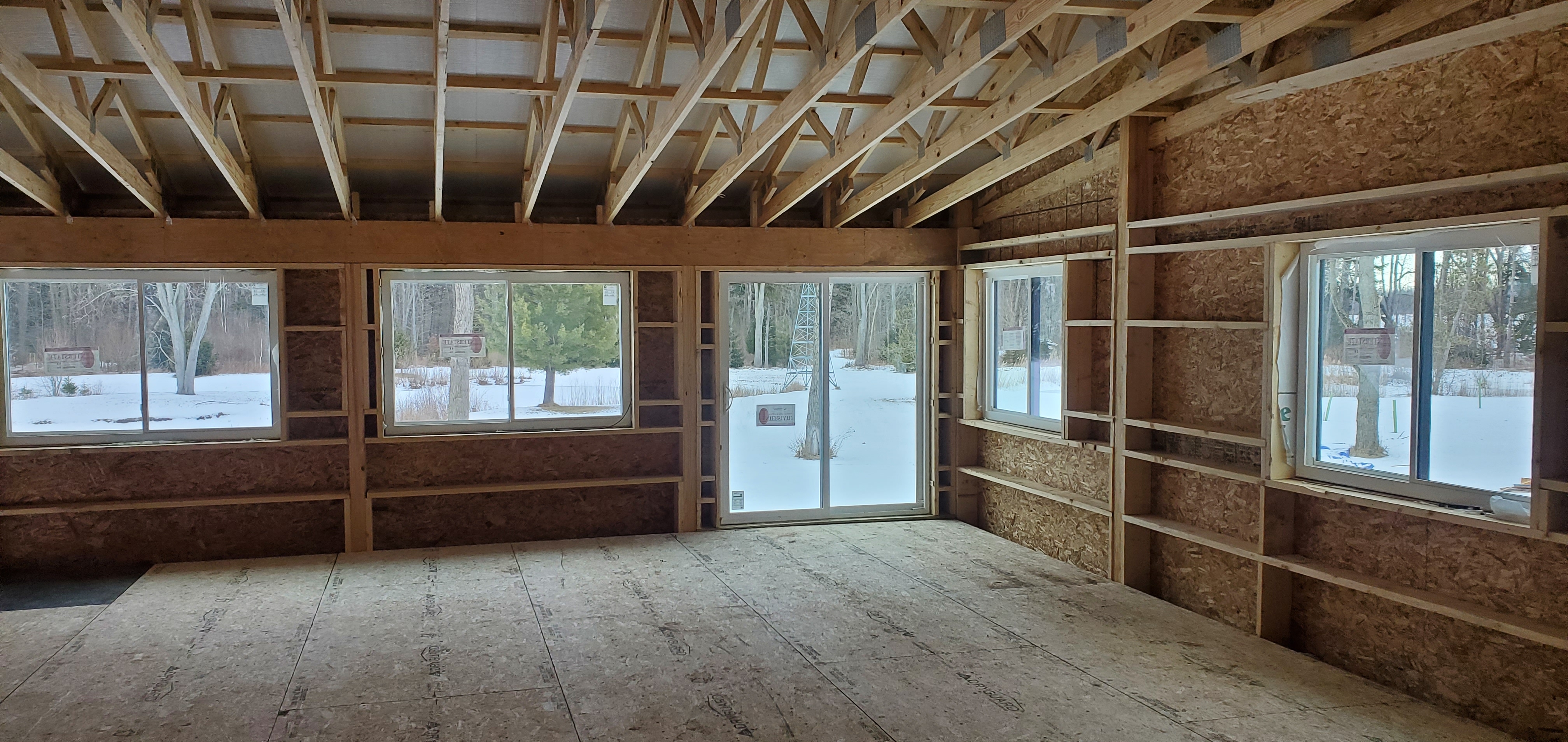

Did you pour a slab for the floor? I'm confused by the picture with OSB on the floor on what looks like the first level of the building.

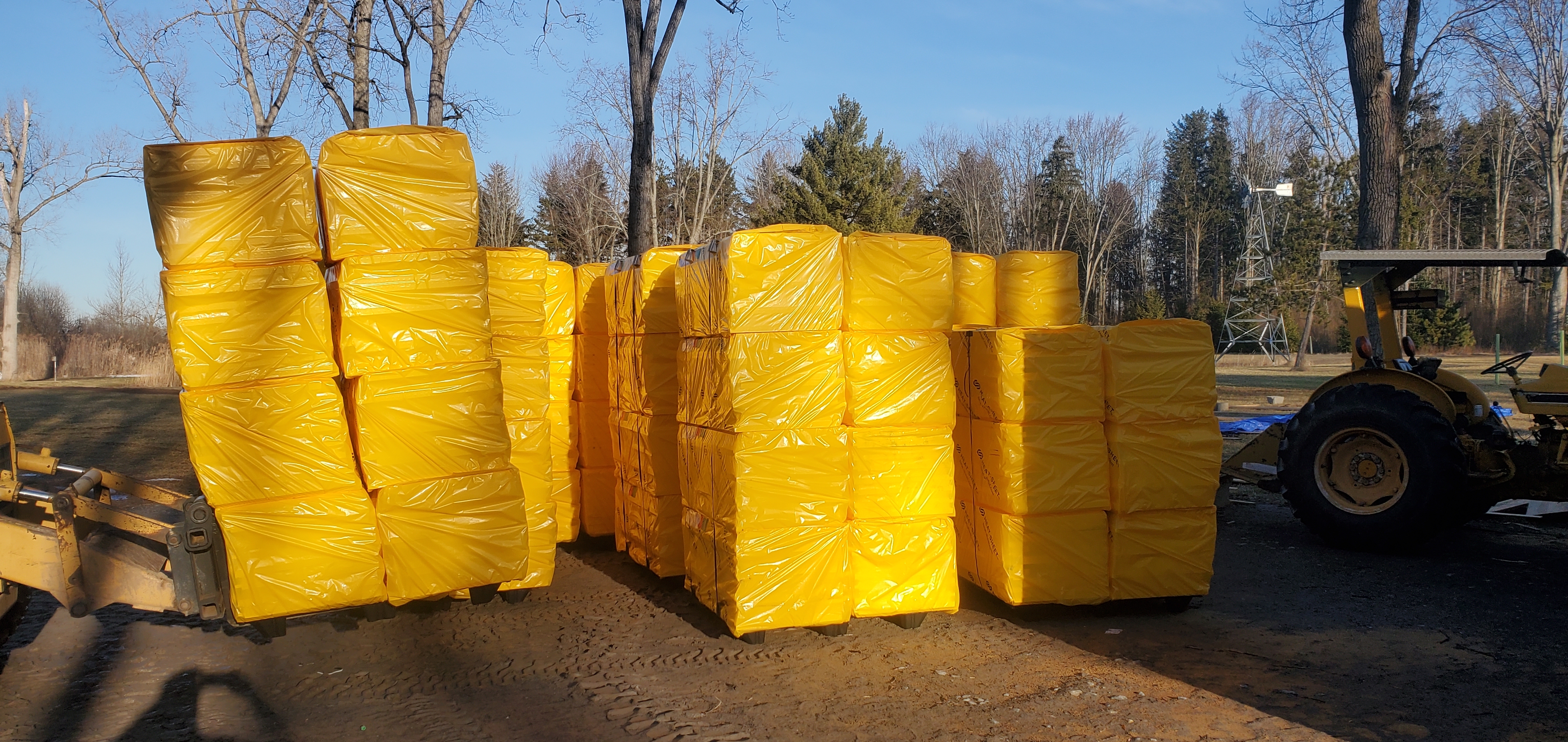

No slab yet, have to put in all the under-slab plumbing/electrical, then more stone, and then the foam insulation and radiant heat tubes before any concrete slab can be poured.

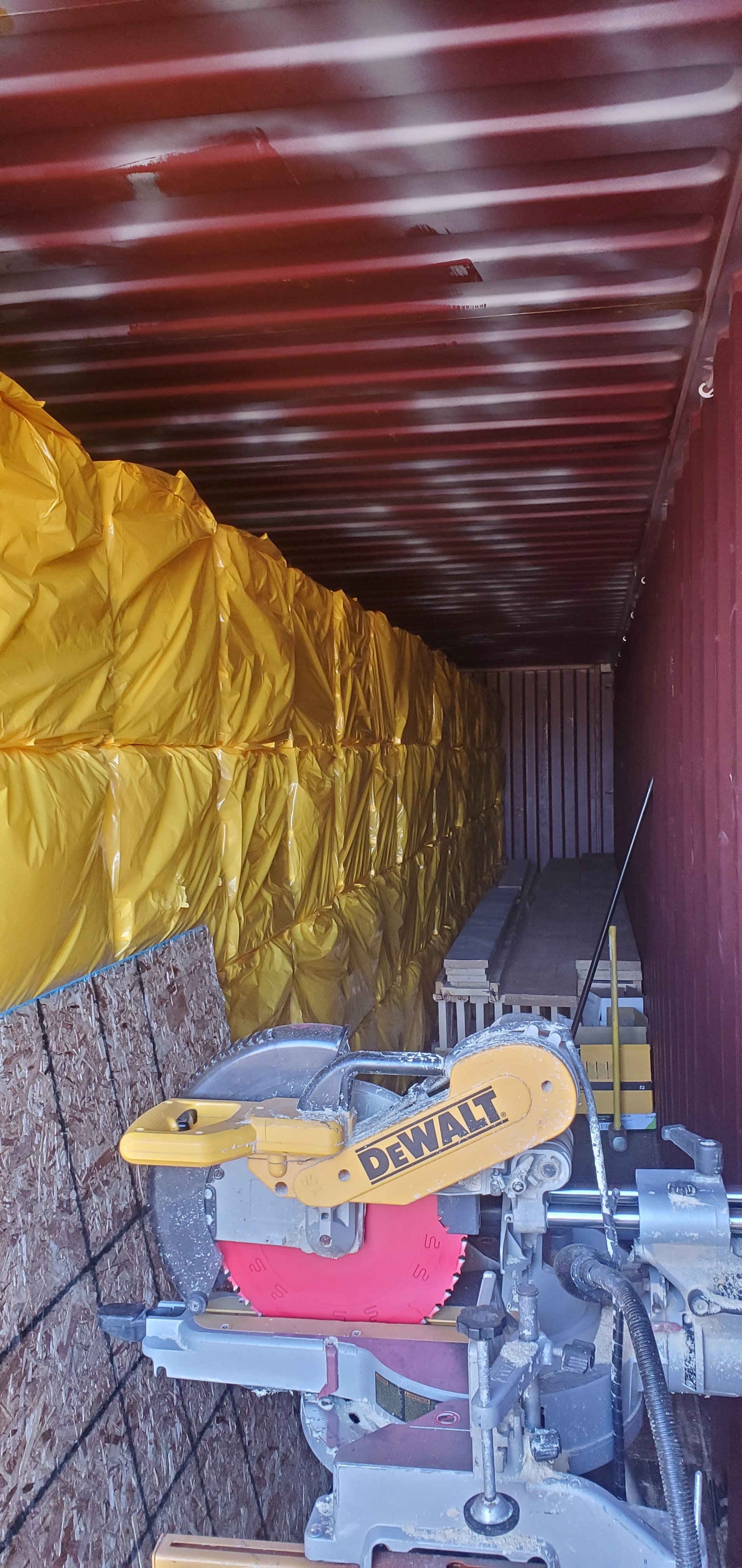

I did order and receive all the insulation that goes under the concrete:
It filled up one of my shipping containers pretty much. It's this stuff: Heat Sheet R10 Heavy
The OSB sub-flooring you see is all on the second floor installed on 18" tall open web trusses that span ~28ft.
The last picture looking through the first 10X8 garage door shows the 18" floor truss system (ceiling of the garage).

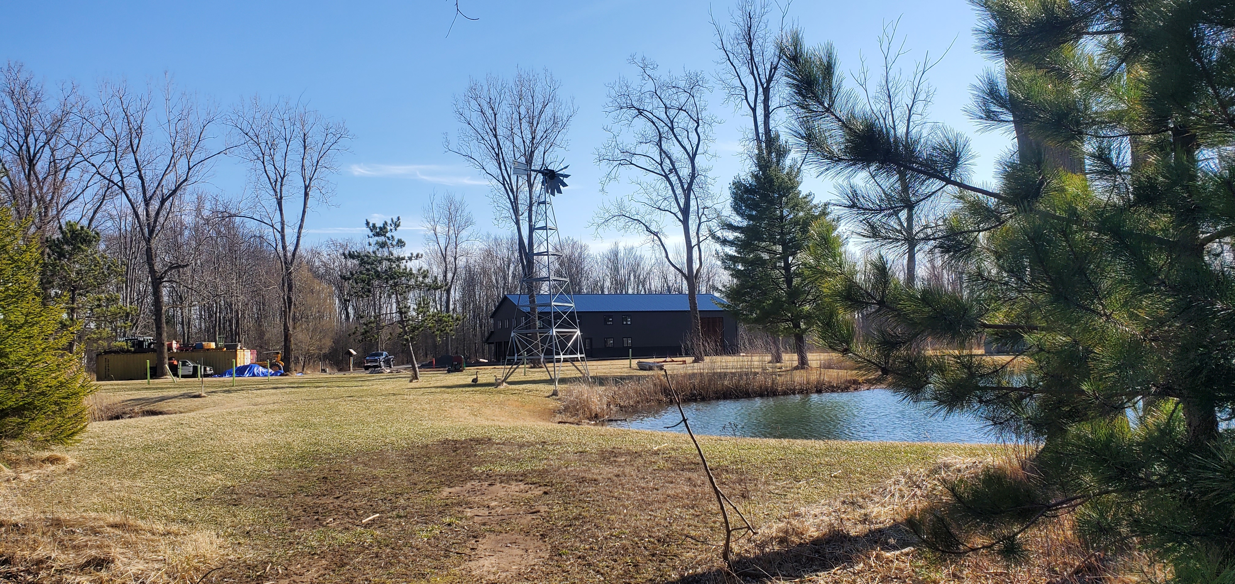

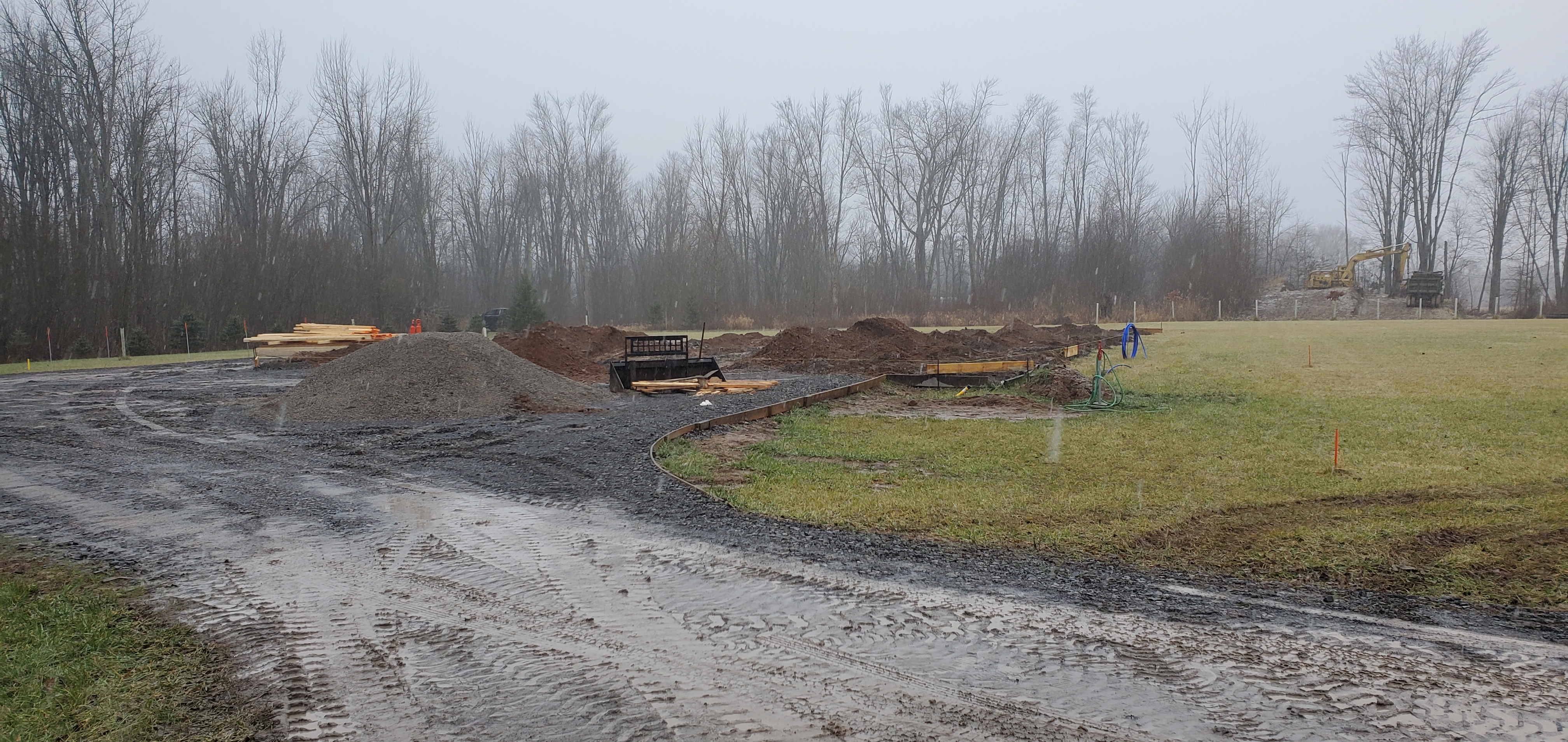

Next big hurdle for me is the Natural Gas installation. I've already dug most of the trench and fully paid the invoice from the NG company, so I am hoping this locks me into the service even though this Natural Gas ban starts in 9 months.
It's far too wet for me to proceed any further on the NG installation, probably can't happen until summertime:
It's still a muddy/wet/frozen mess.
