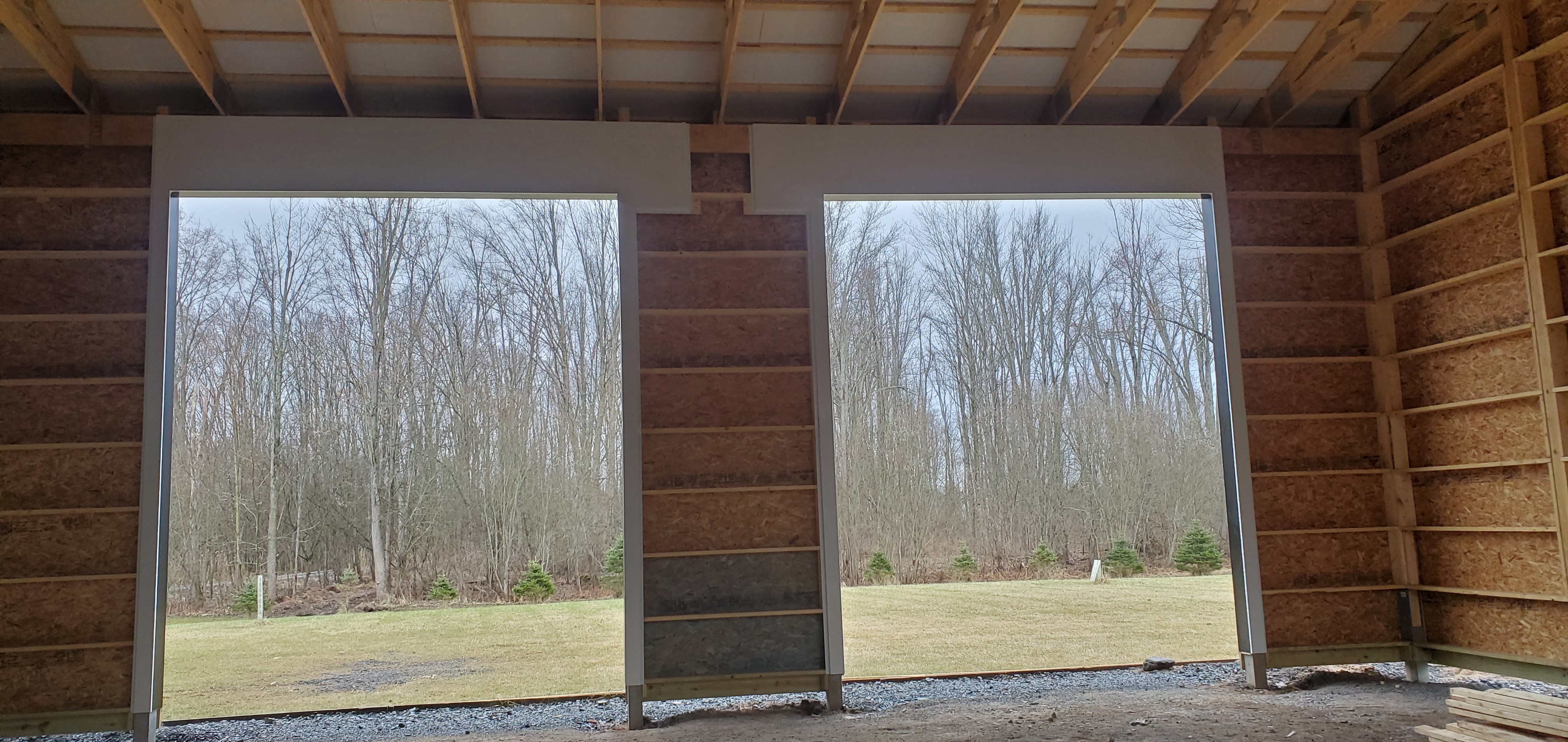

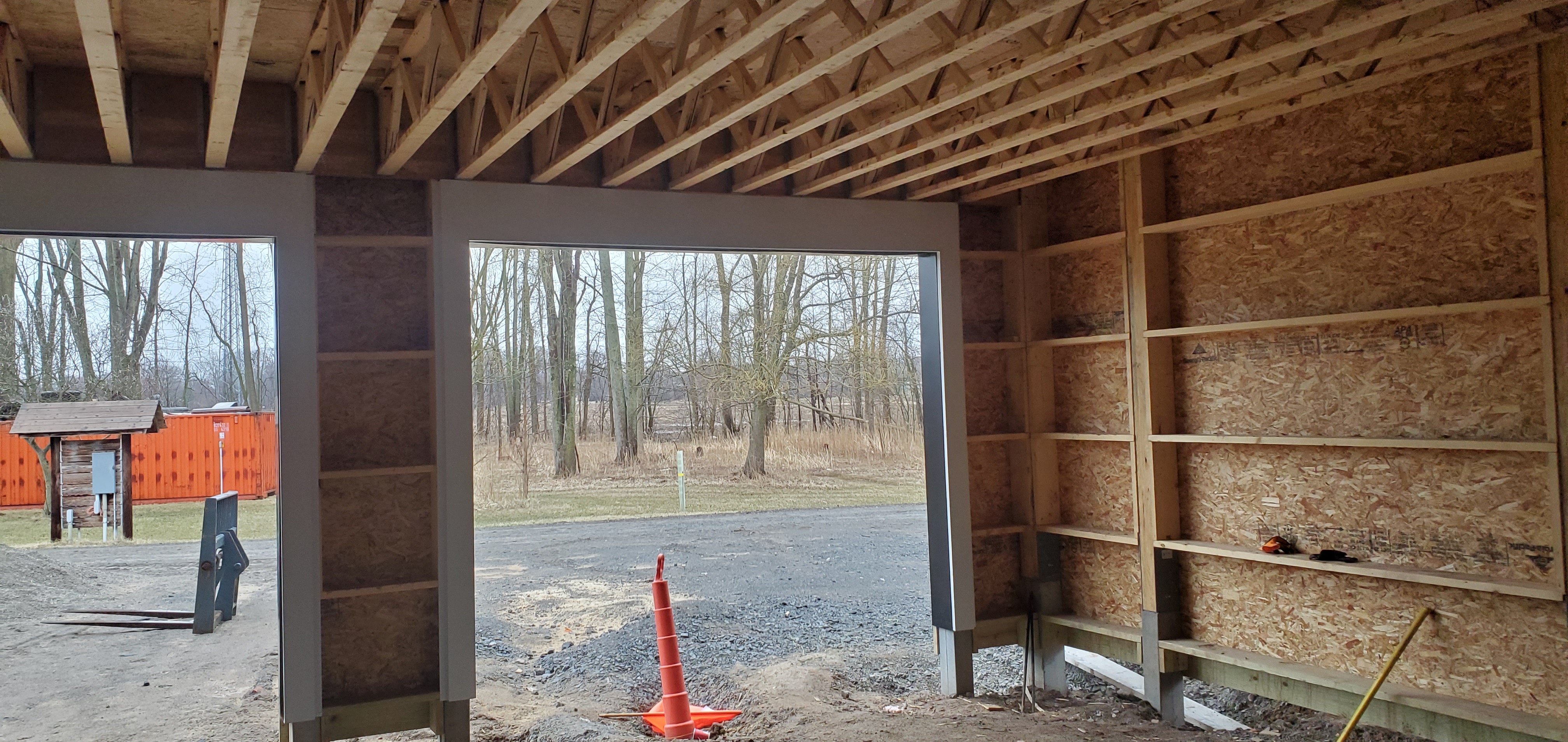

One thing I had the Amish crew do was to trim out the interior openings of the overhead doors with white steel so that I'm not having to remove door tracks, springs & shafts when I want to finish those areas off. OH doors should be installed soon.

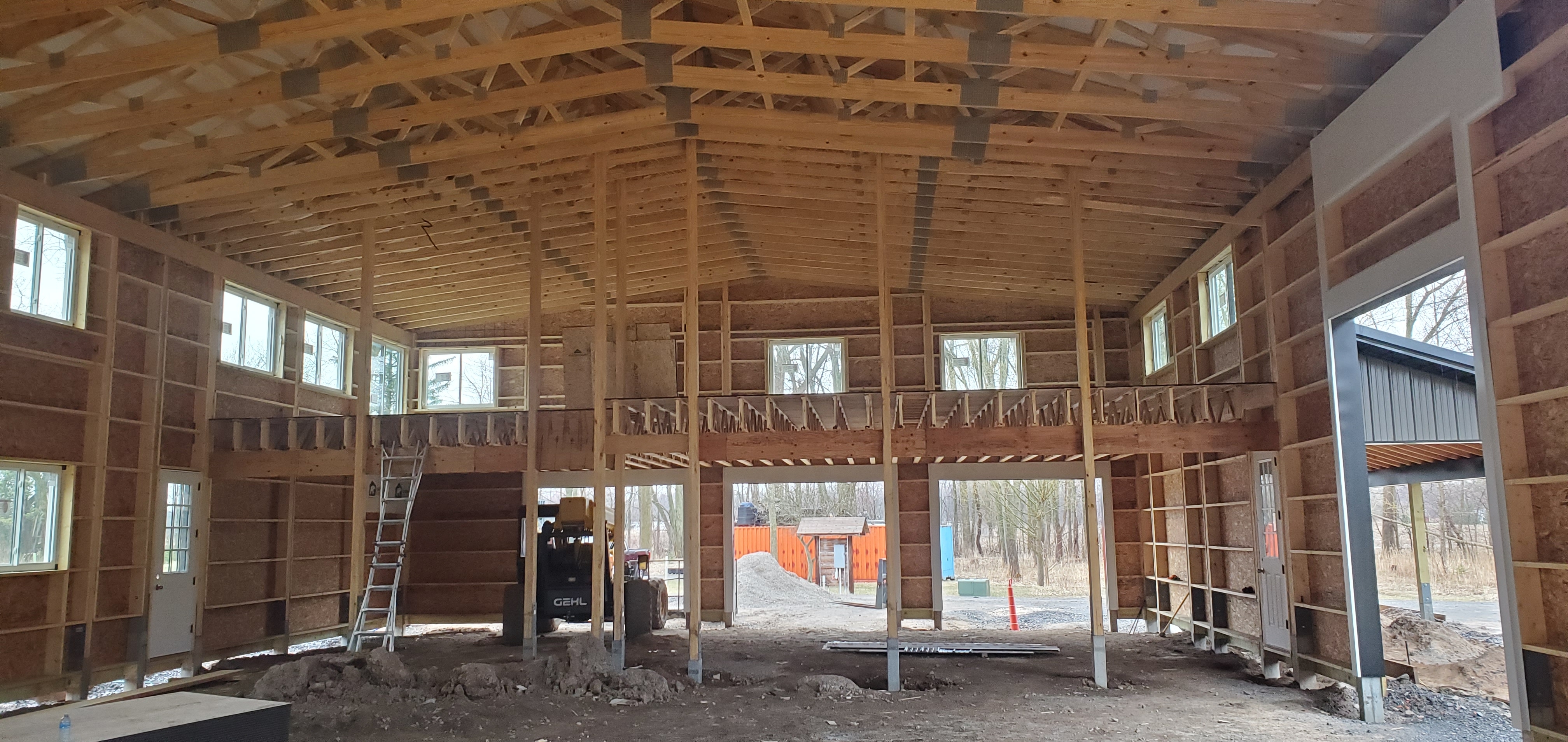

That inside photo sure shows how big it is!!!!!!

ETD66SS indeed this is big!
I forgot the dimensions is this 40 W x 100 L total and the "house" area is 30x40? Can you repost the plan again?
   / Barndominium/Shop or "real" House?
#499
It's 48 x 96 with 18.5ft tall walls.
The living space is about 26 x 48 with a room above the workshop space that is about another 20 x 20. About 1700 sq-ft of total floor heated living space.
