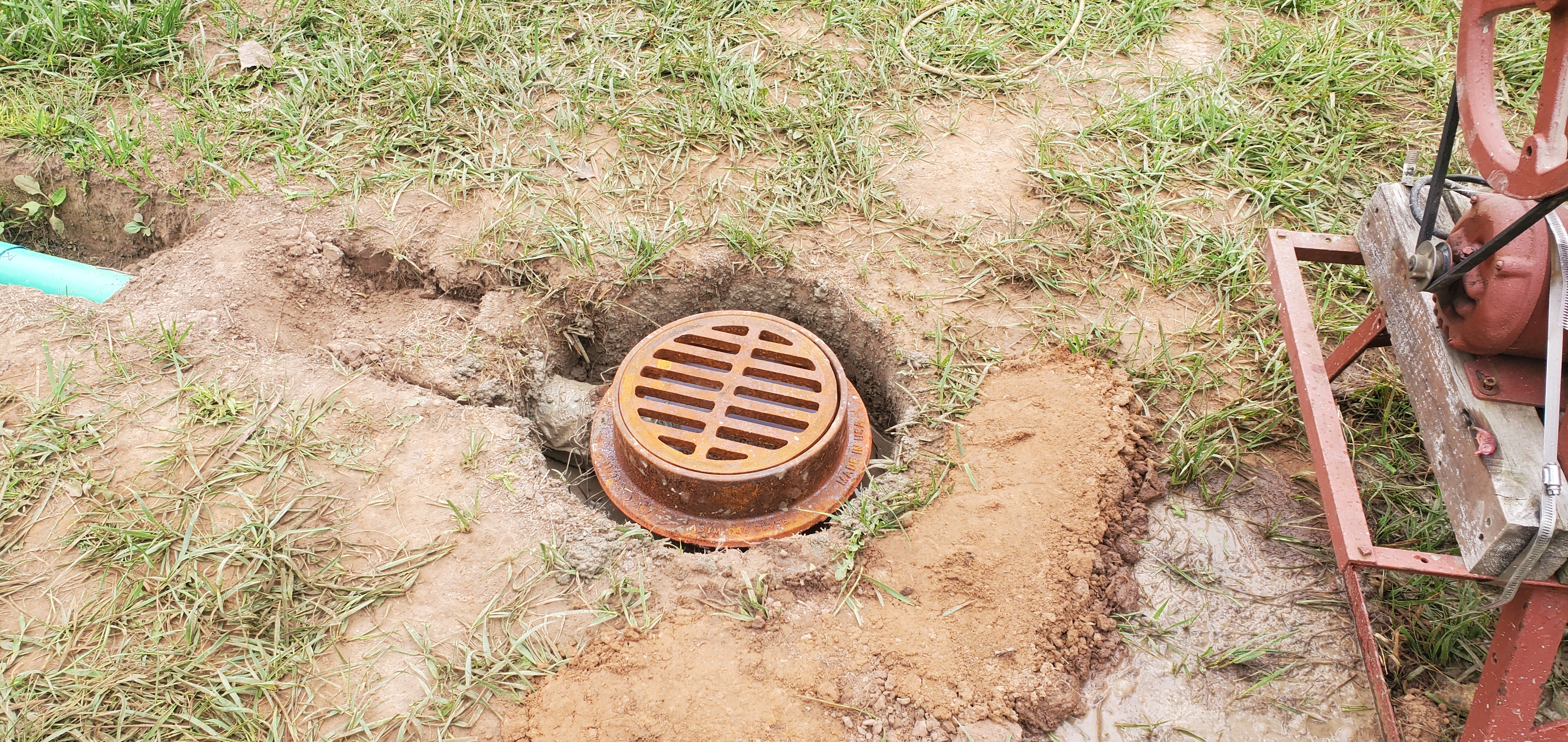

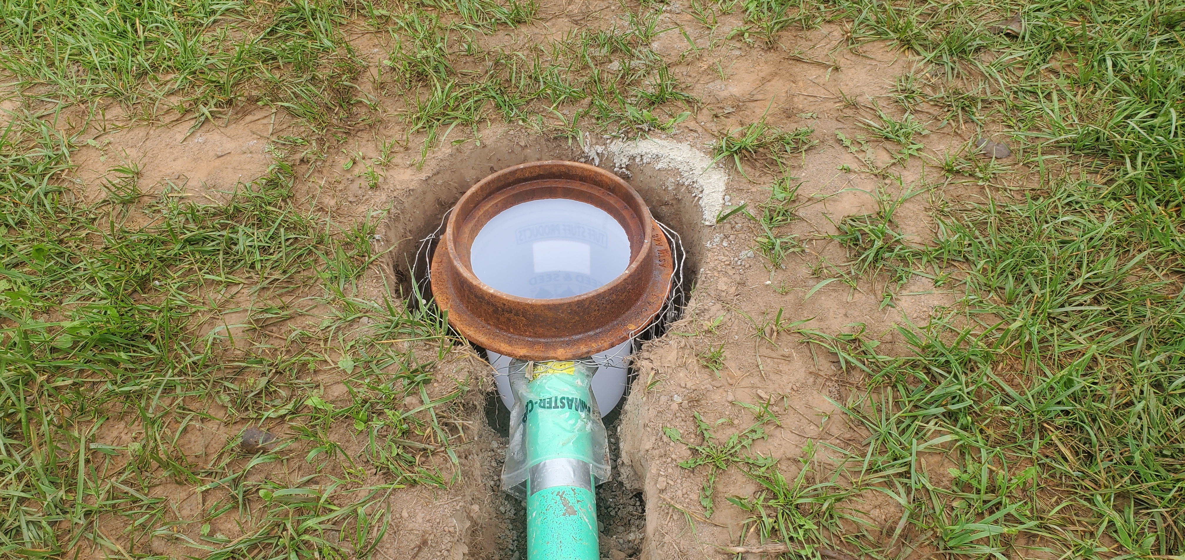

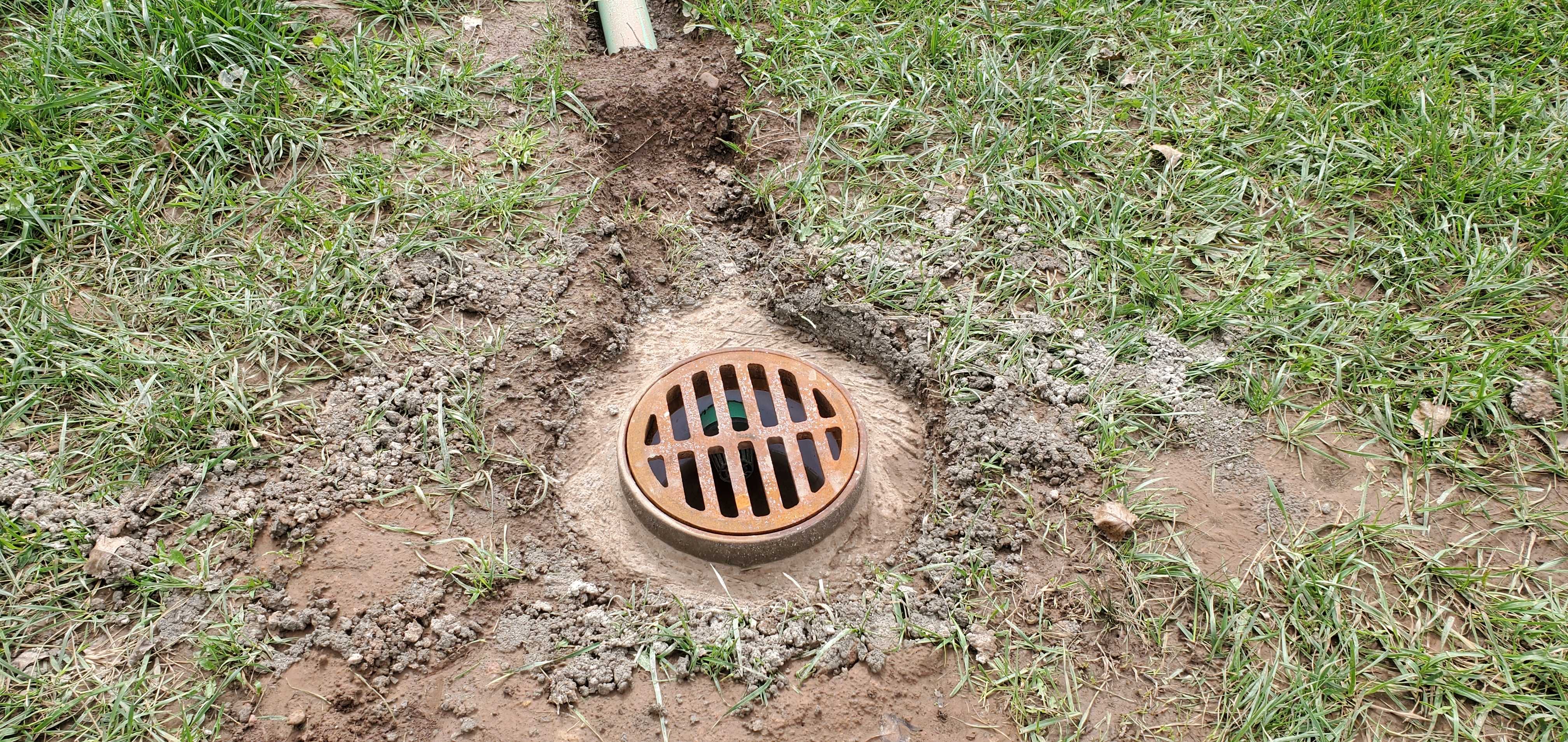

As far as progress, I finished my drainage basin:

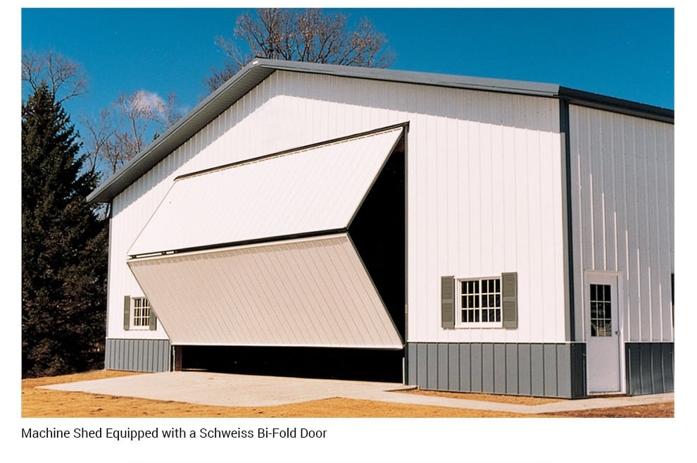

Have you considered the bi-fold type of door?
   / Barndominium/Shop or "real" House?
#477
You mean vertical bi-fold?
Not sure if I like the concept. Would have to think about it more. Can't open the door if say an incapacitated machine is close to the outside of the door.
   / Barndominium/Shop or "real" House? #478
They seem to be popular, also the disabled vehicle would have to be quite close to interfer
