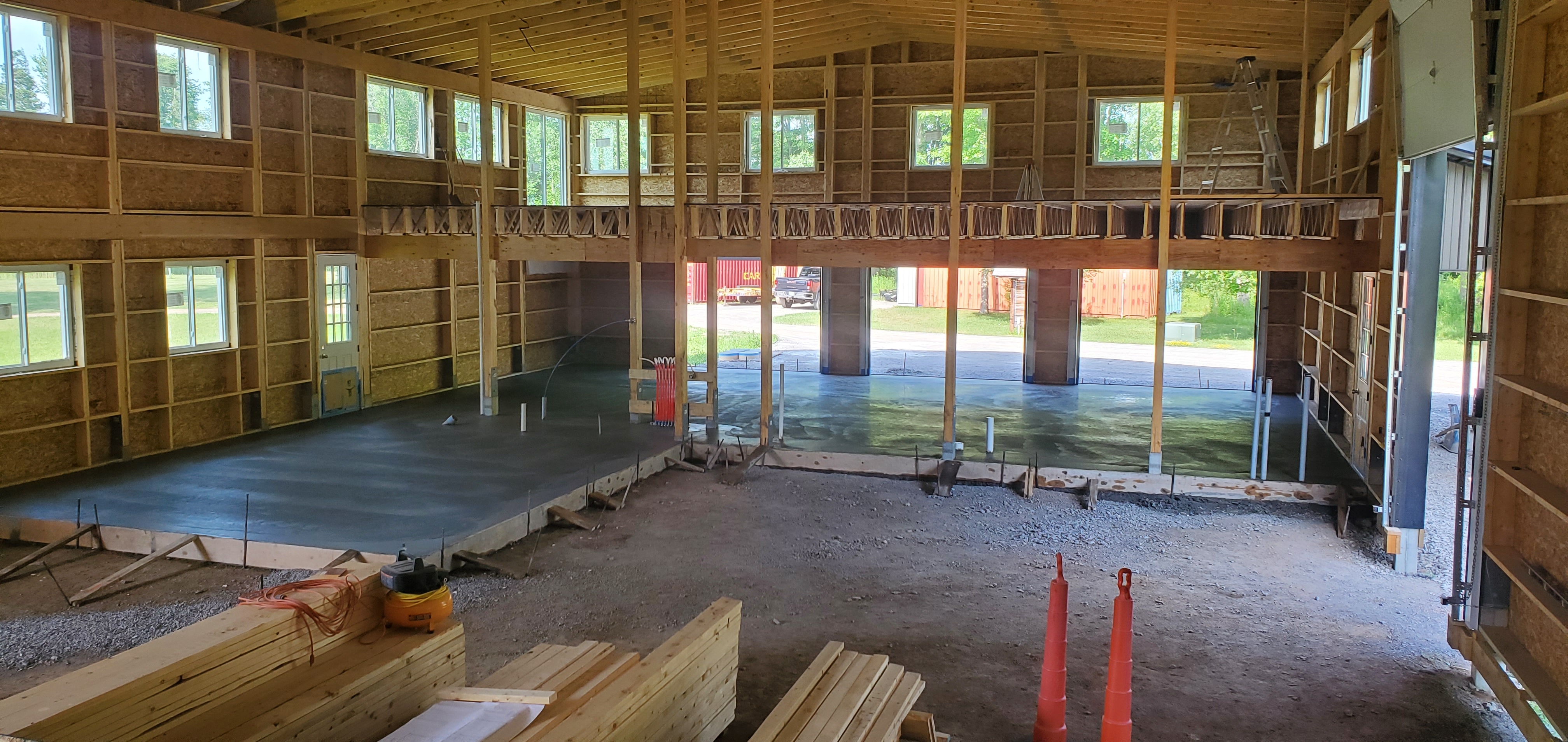

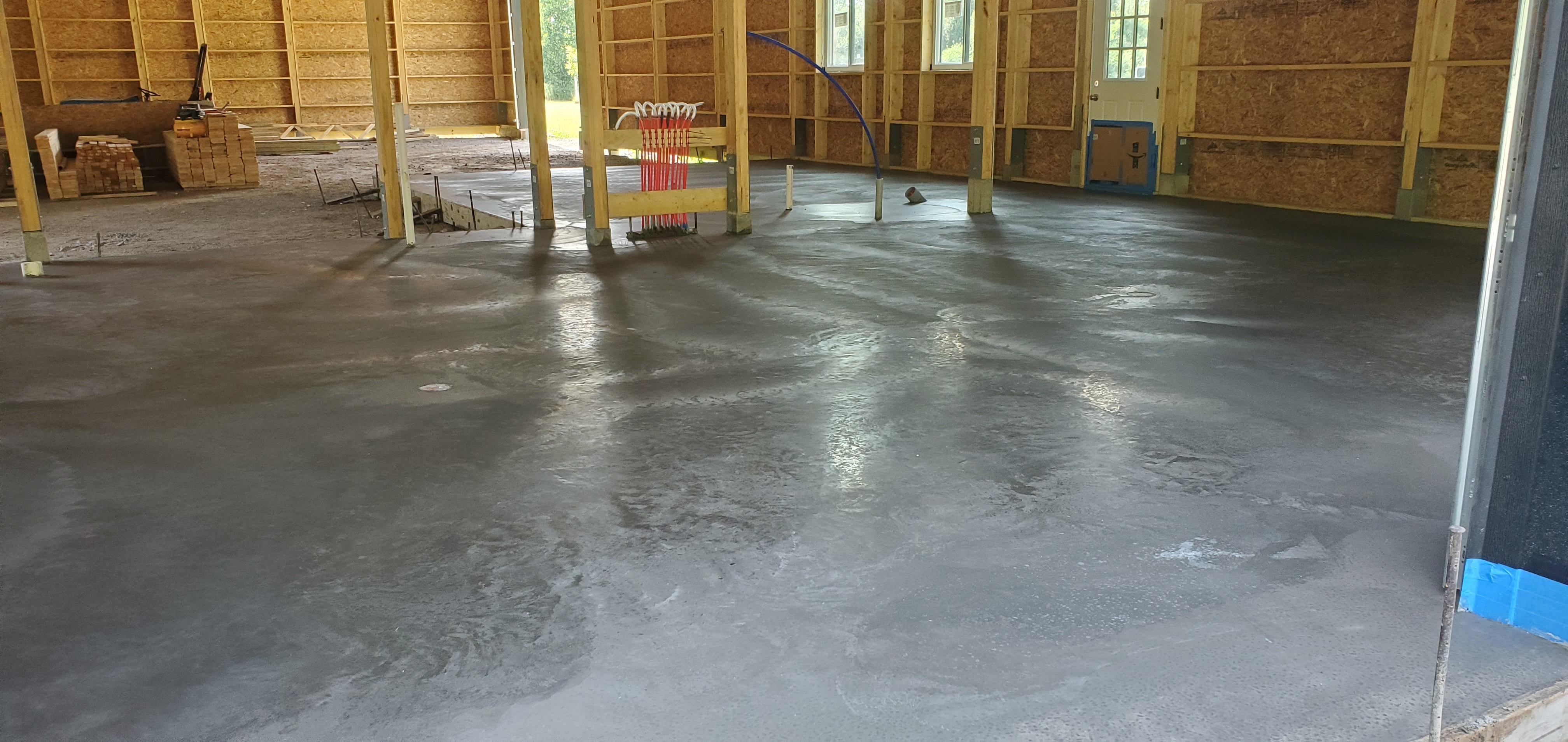

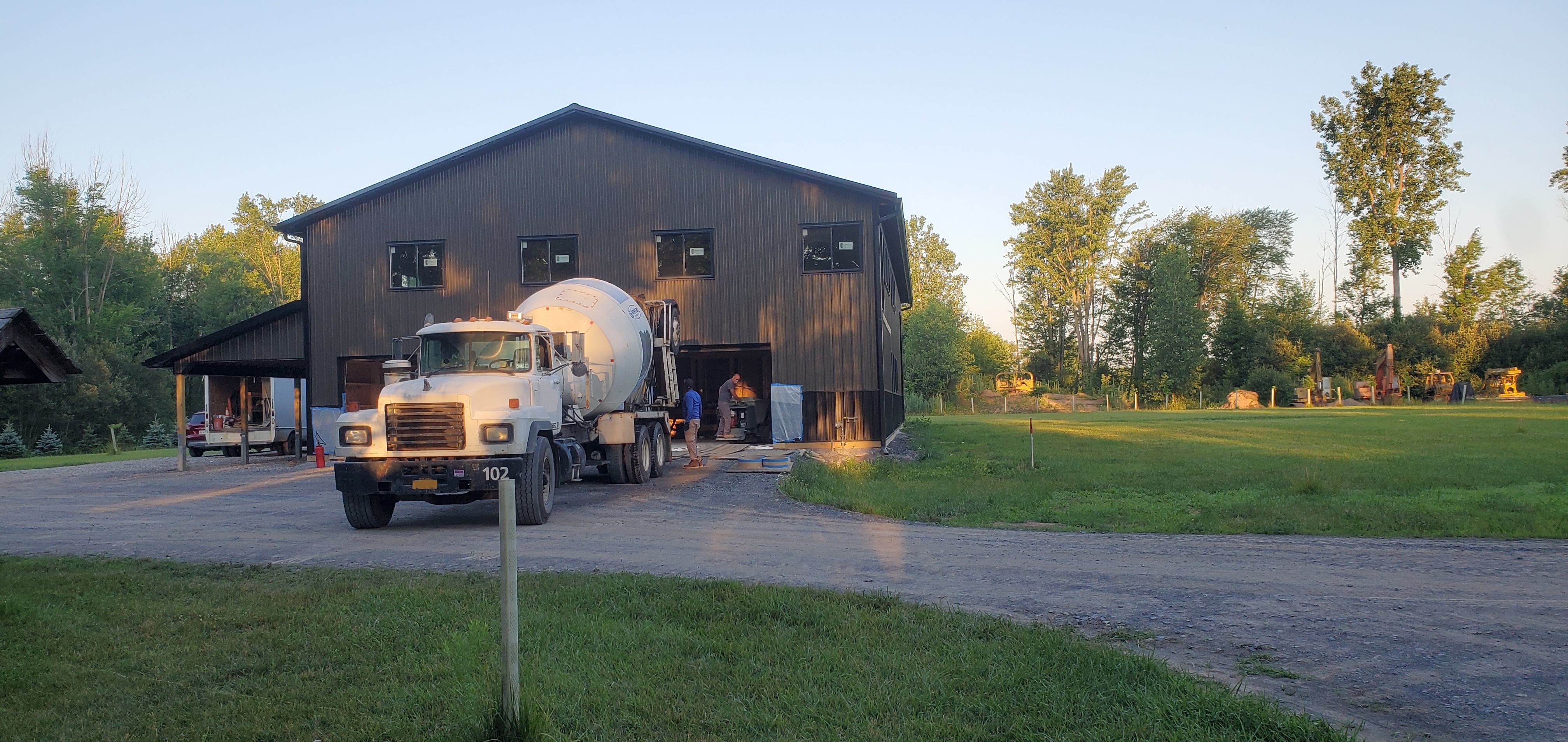

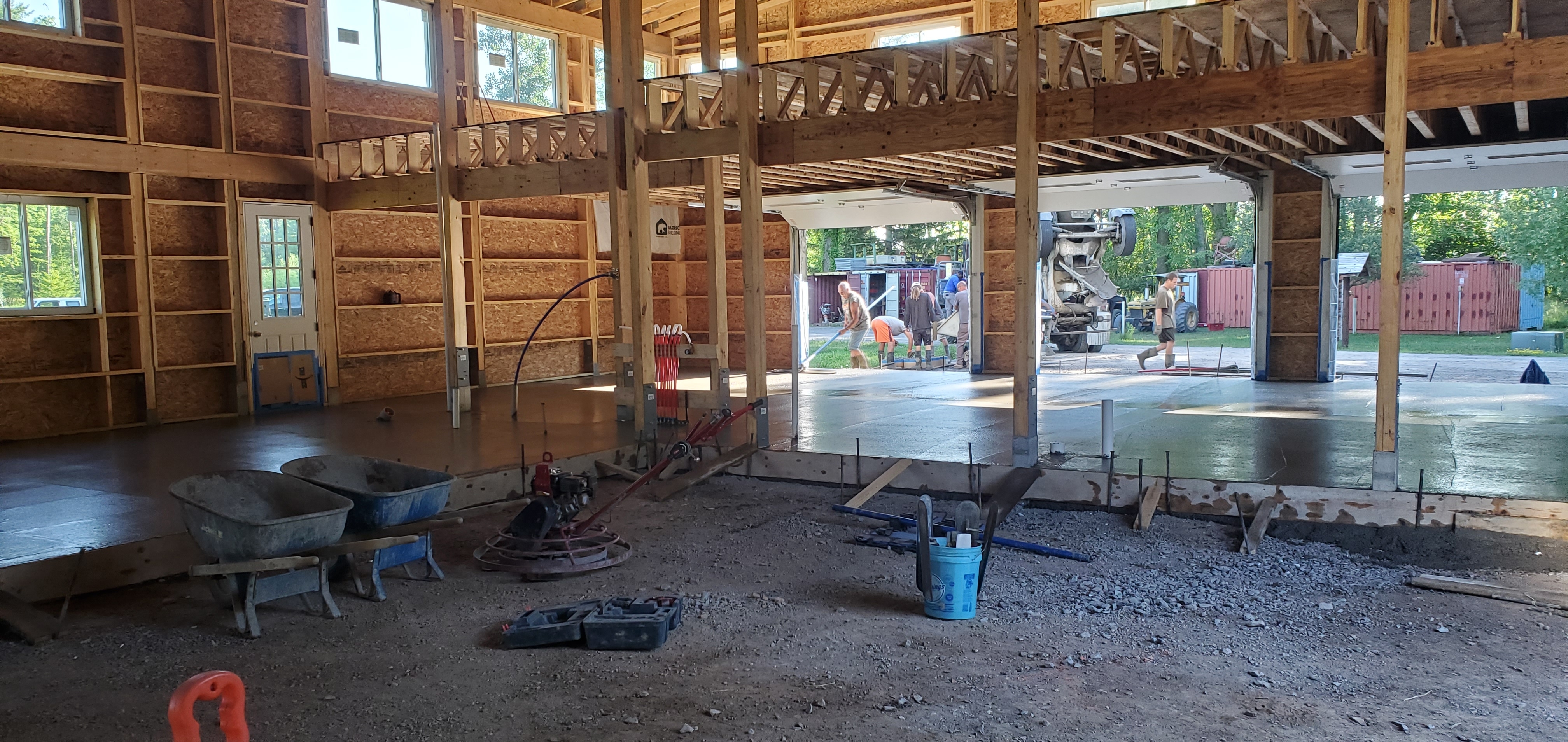

Got the garage/workshop
pad poured yesterday.

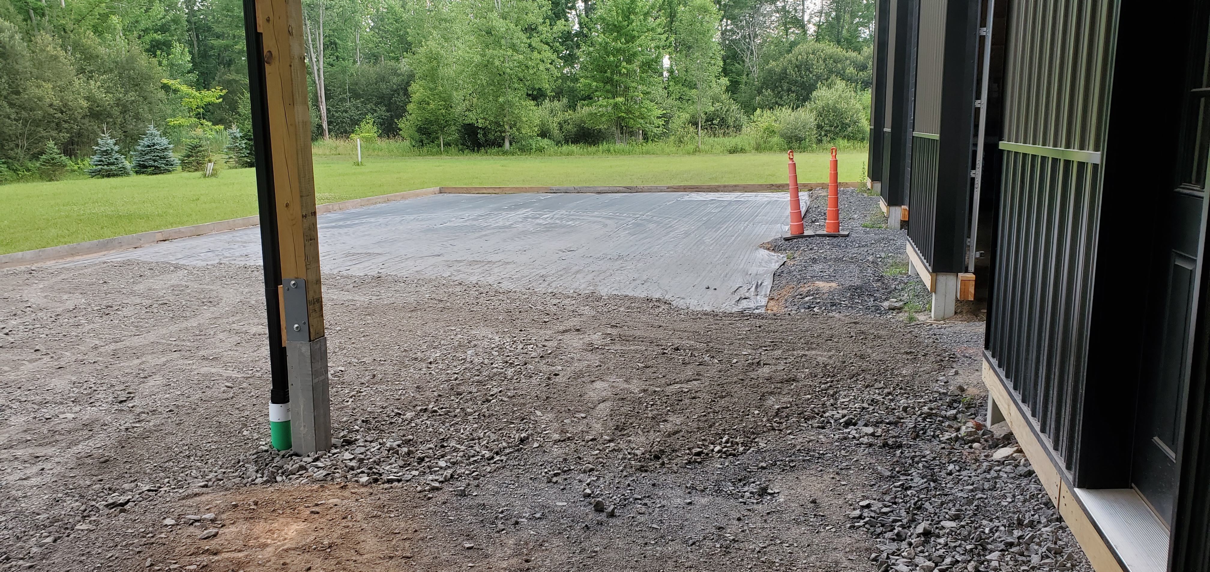

Also finishing off the stone in front of the large OH doors:

Nothing better than concrete!!! How thick is it?
Are you going to use gravel outside the garage doors instead of concrete?
I just noticed that you framed your walls horizontally. Are you going to spray foam for insulation on your walls?
Thanks for the updates, it just keeps looking better every time!!!
The concrete is nominally 4" thick above the nubs of the heat sheet foam. Some areas are 4-1/4" some 4-1/2" as it was not super easy to get the stone perfect. I made sure there were no areas less than 4". The nubs are 7/8" tall, so in the areas where there is no nubs the concrete is that much thicker.
I plan to use either fiberglass insulation or rockwool, no sprayfoam.
   / Barndominium/Shop or "real" House? #600
Are you going to install the insulation yourself? Cutting and fitting it into those cavities is not going to be fun.
