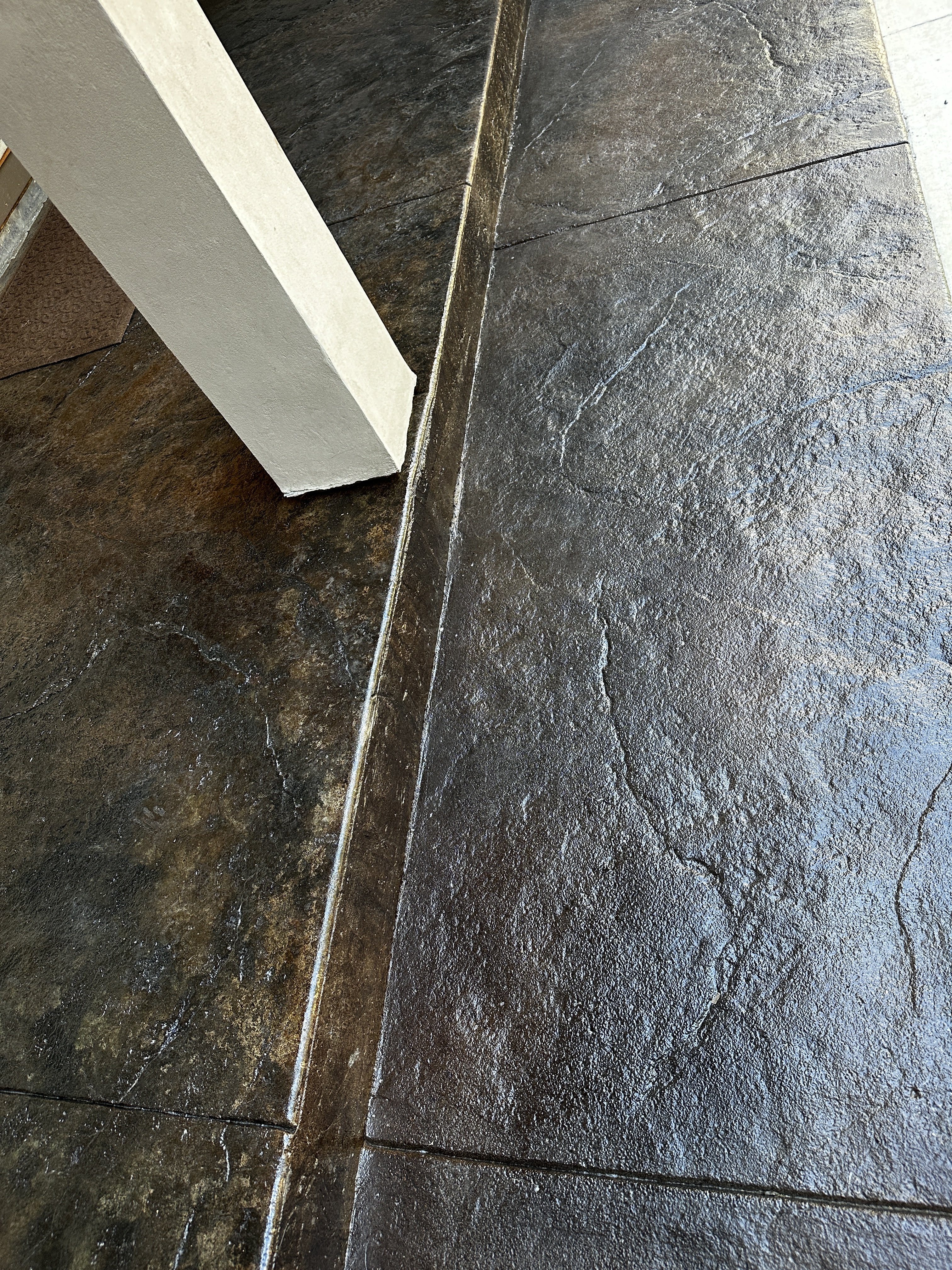

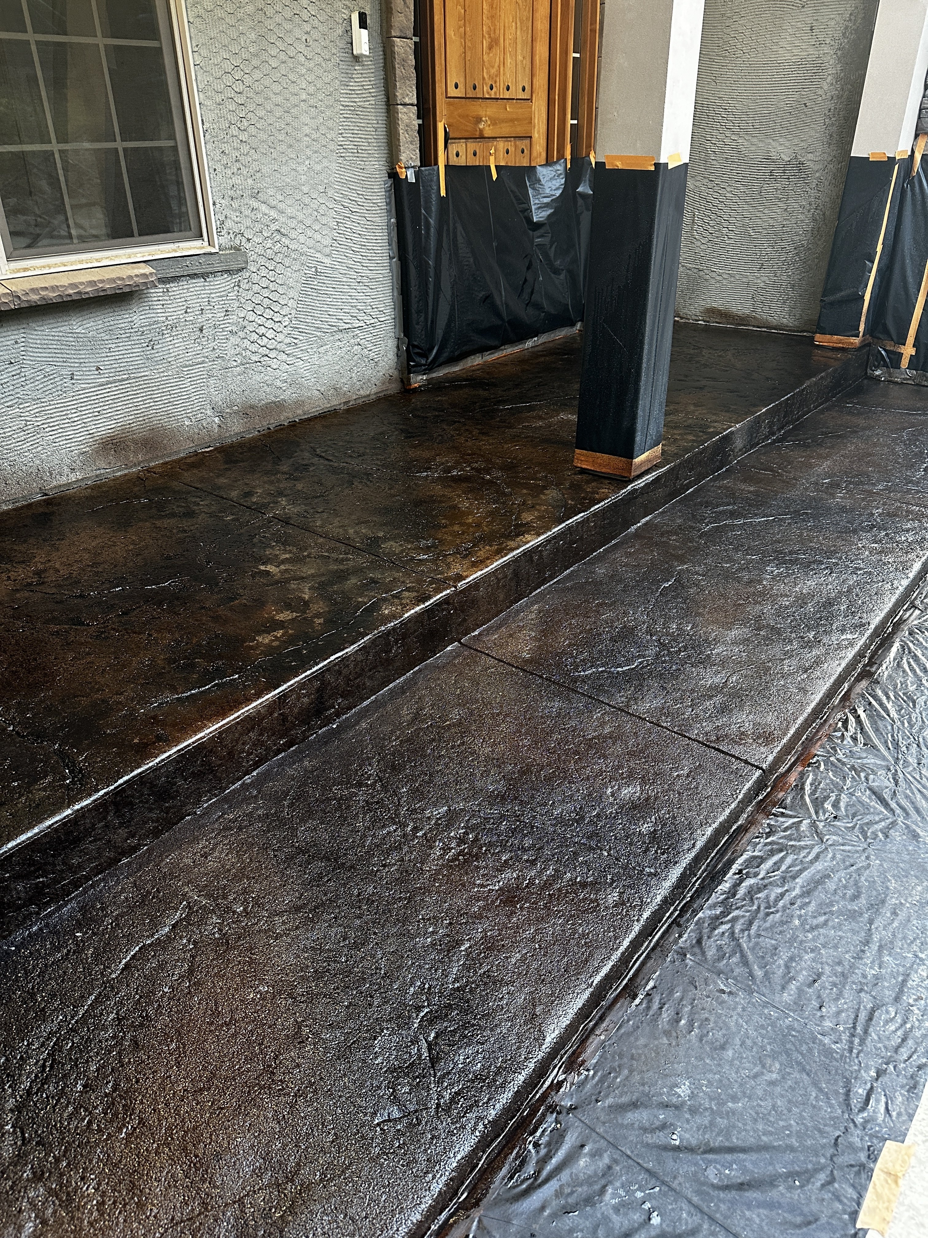

   / Barndominium/Shop or "real" House? #603

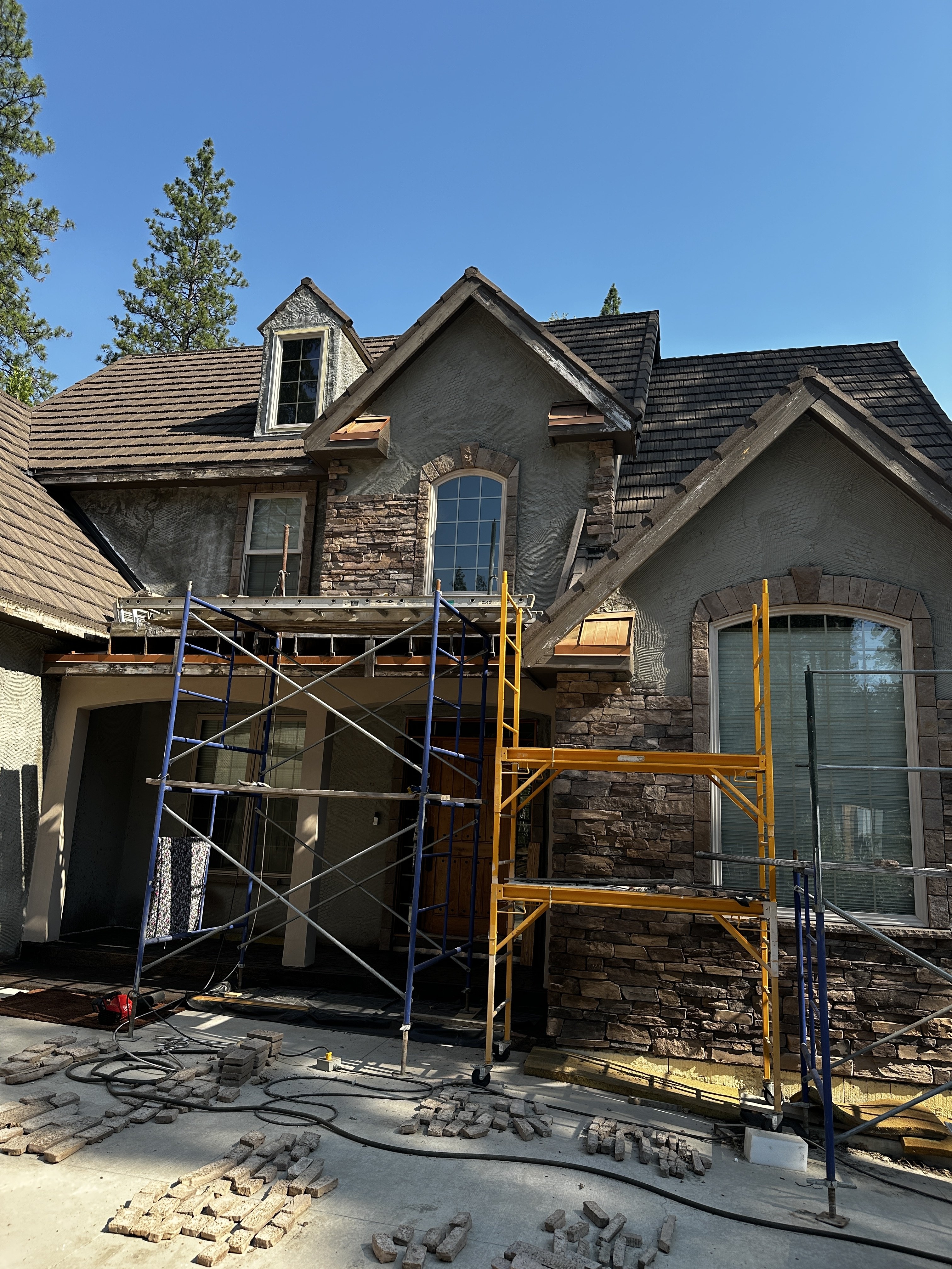

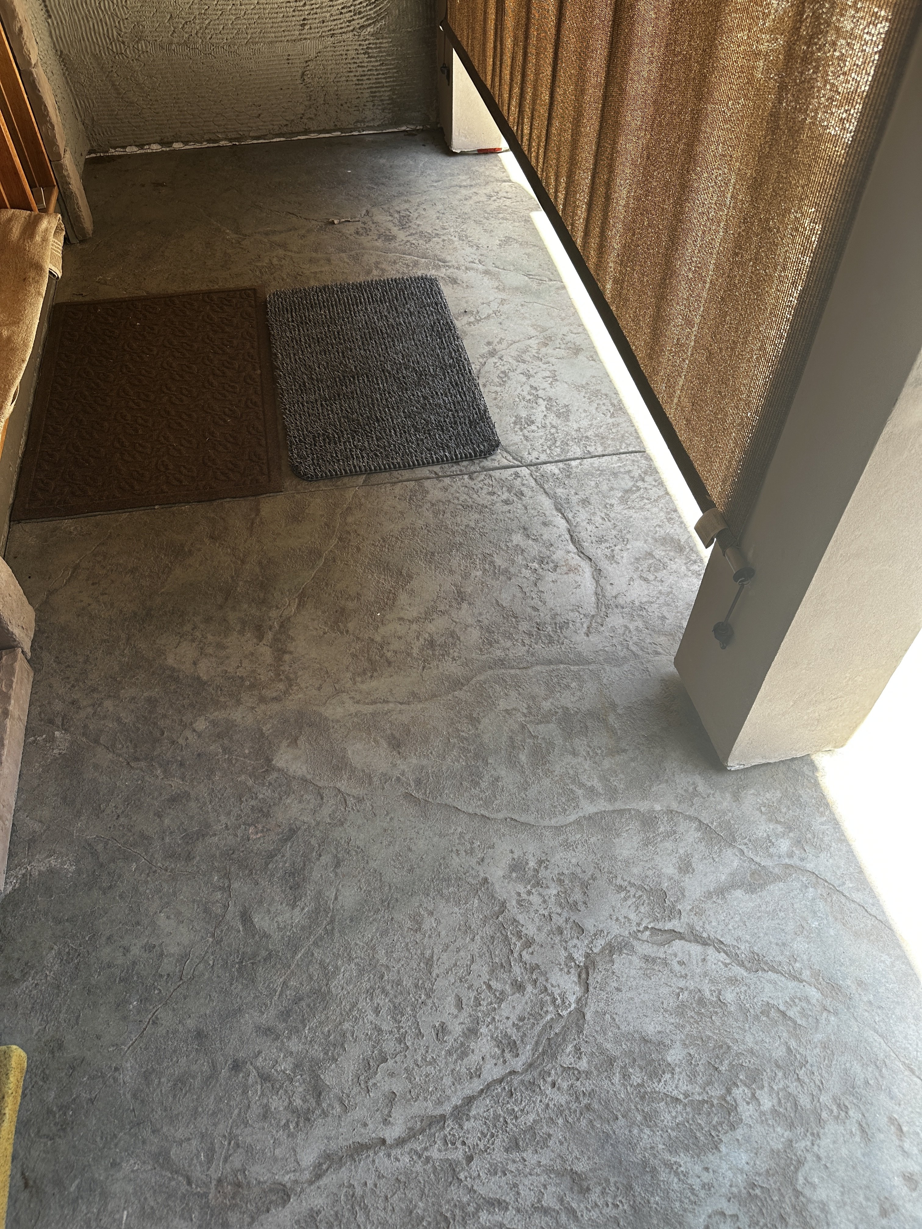

You might also think about some decorative work outside. I stained my porch to go with my stone work and I have more to do.

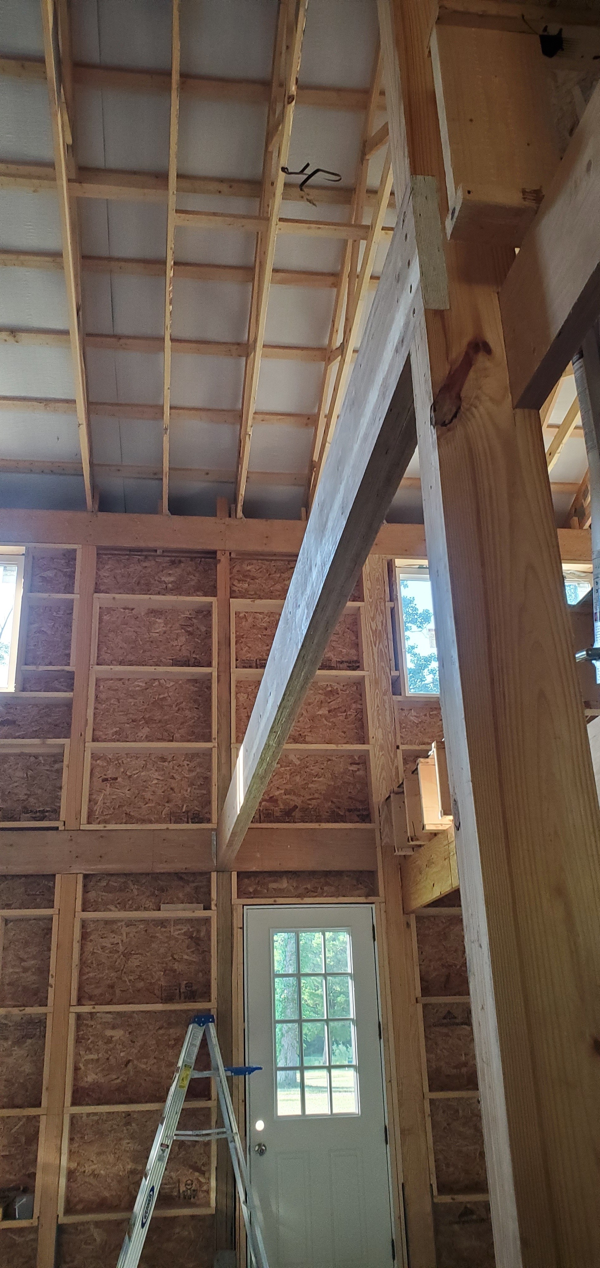

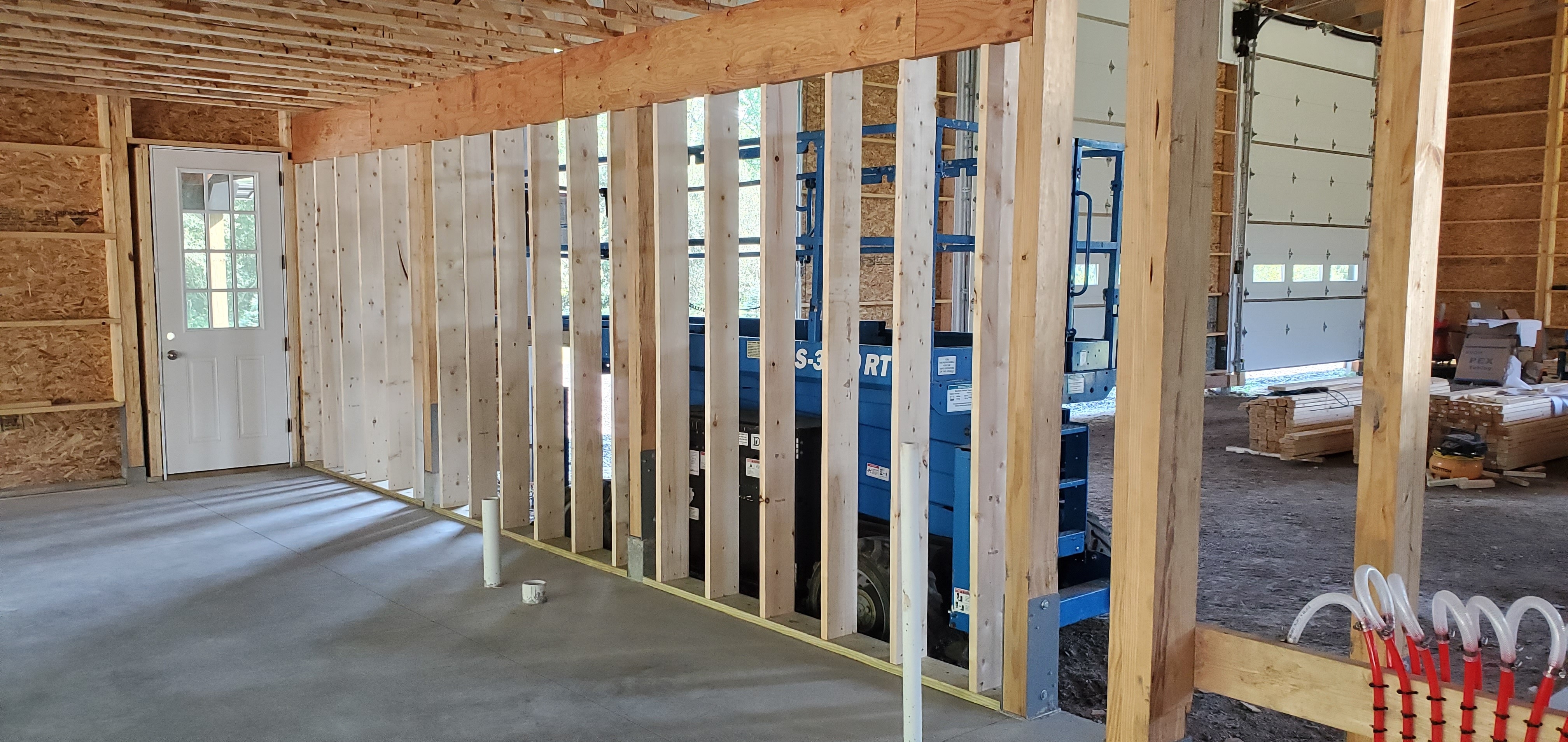

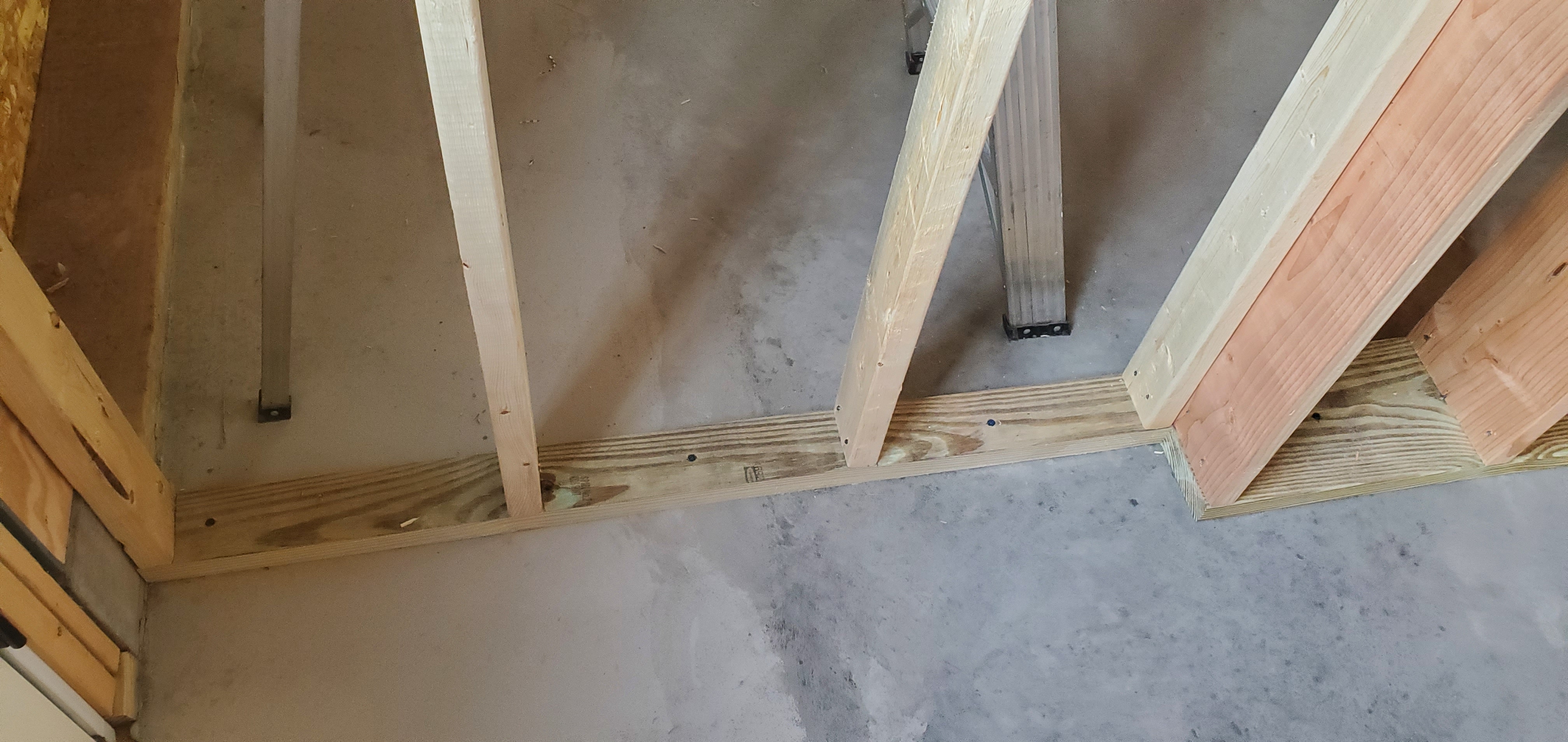

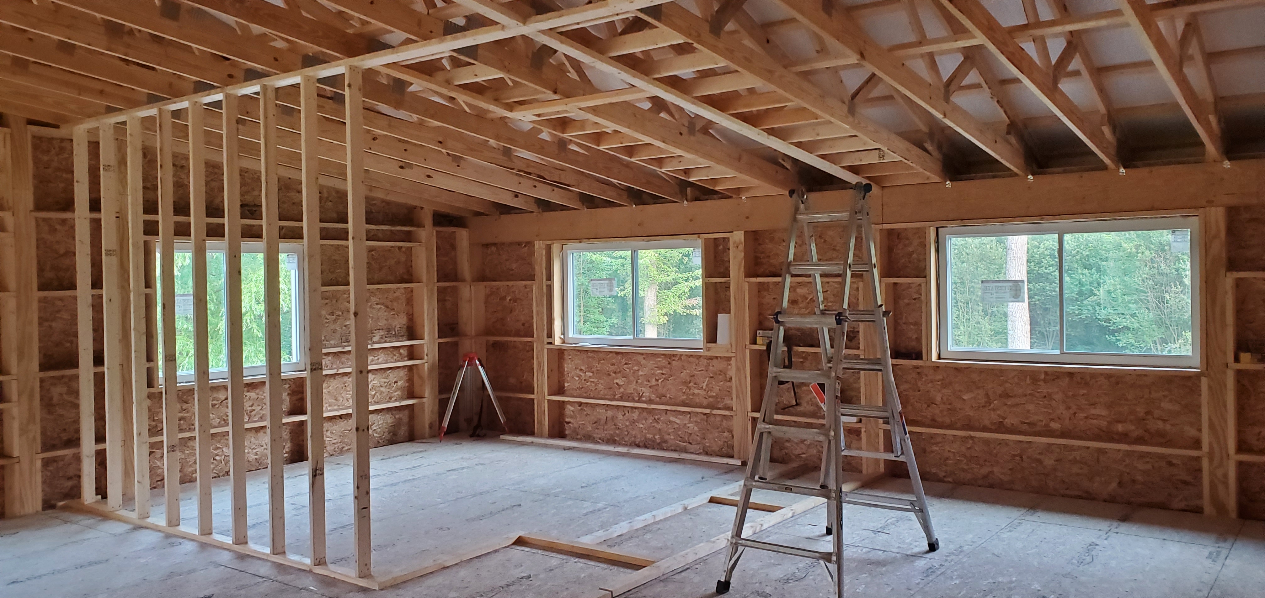

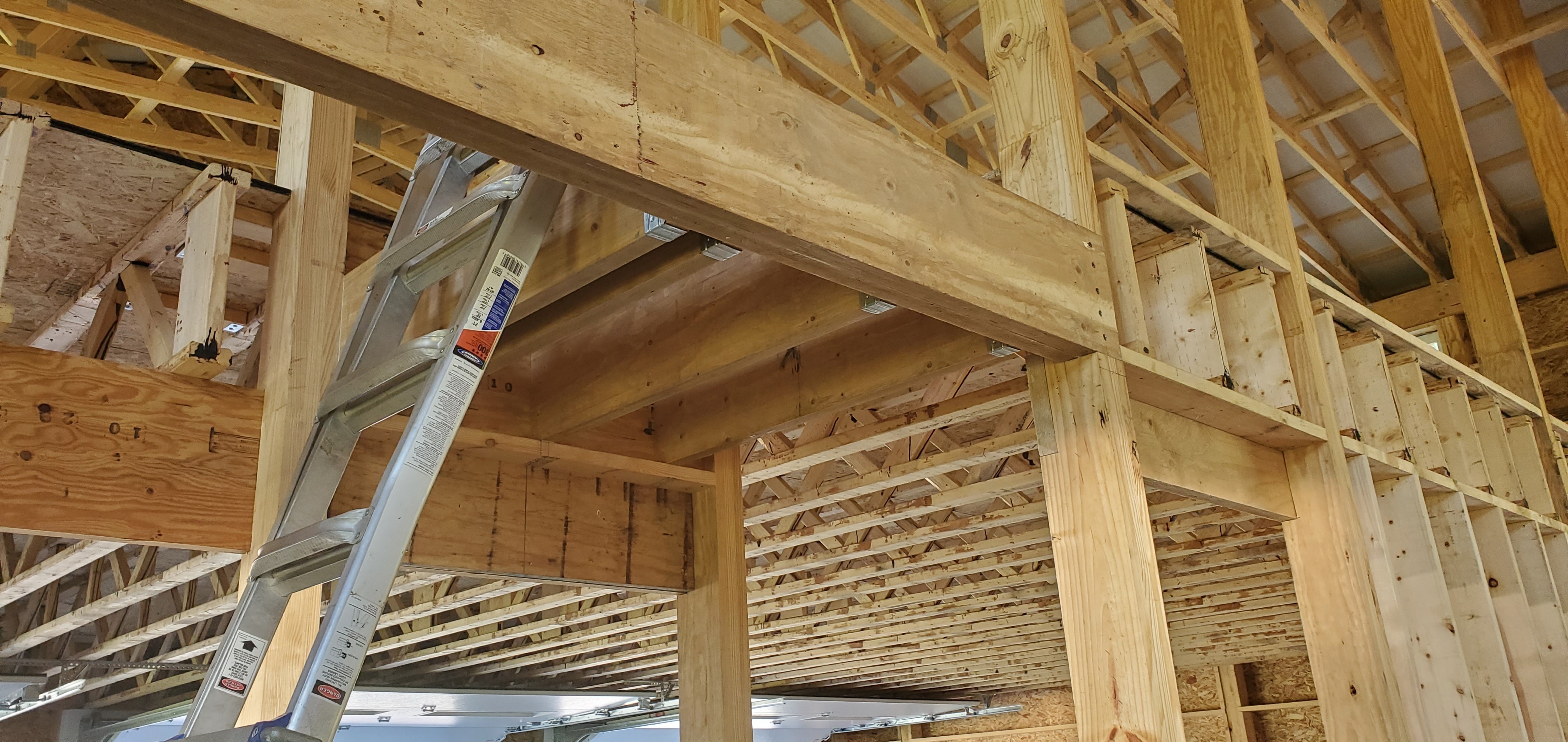

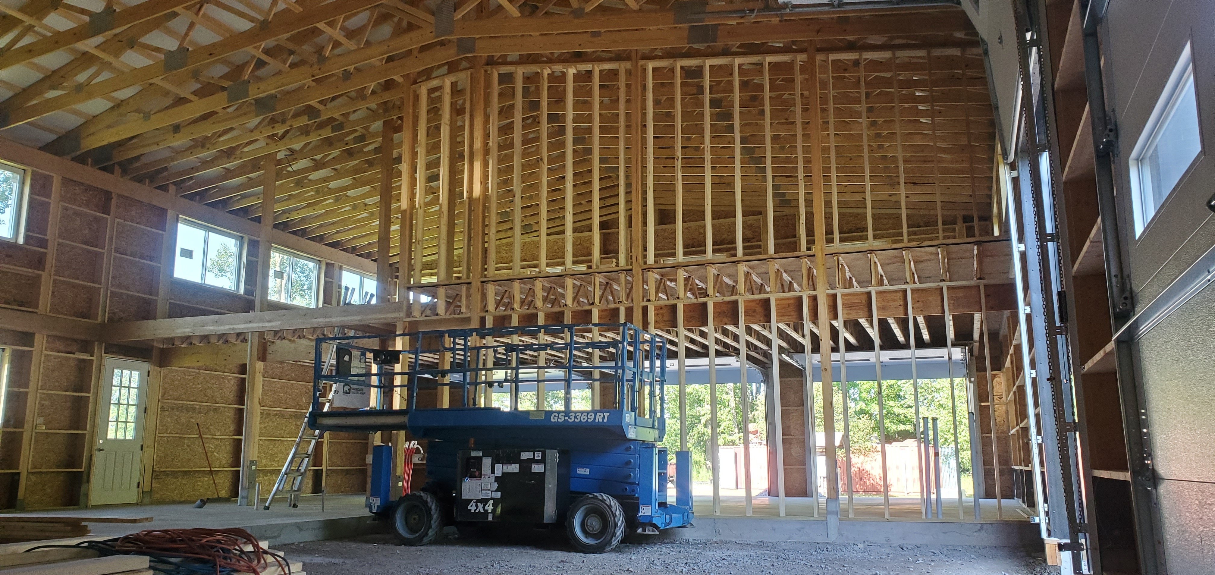

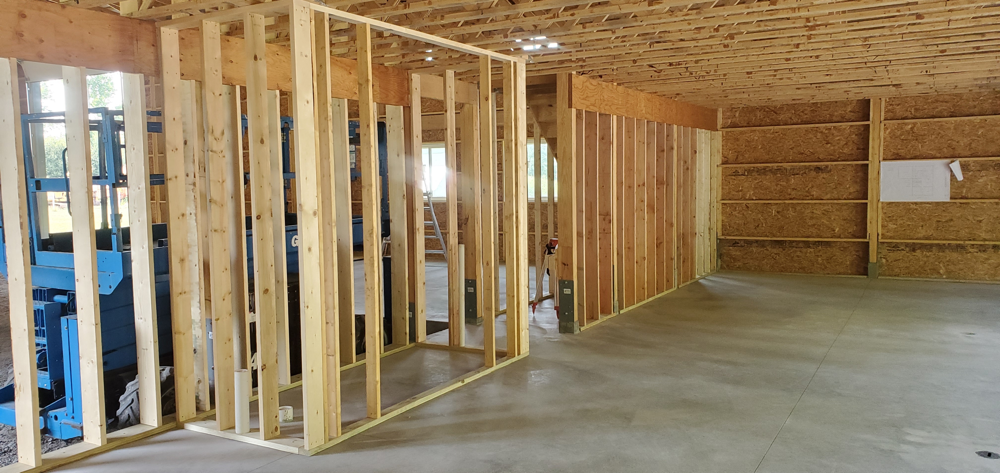

Took a week off work to put up more framing:
Still have to frame all the closets and all door rough openings, as well as the kitchen island for the range-oven.
It goes real slow when working alone, plus with the vaulted ceiling have to measure & cut every board individually.
This Tool really helped with accurately measuring all the framing members.

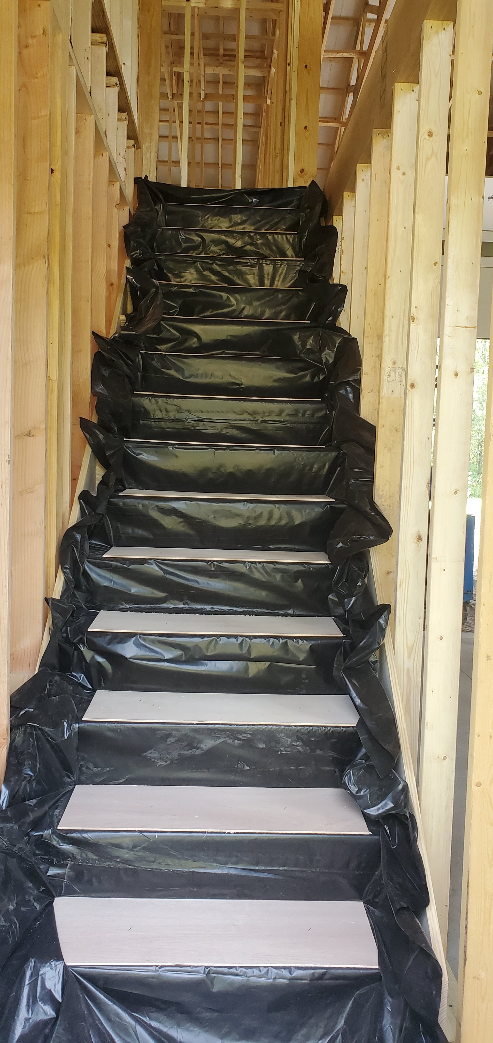

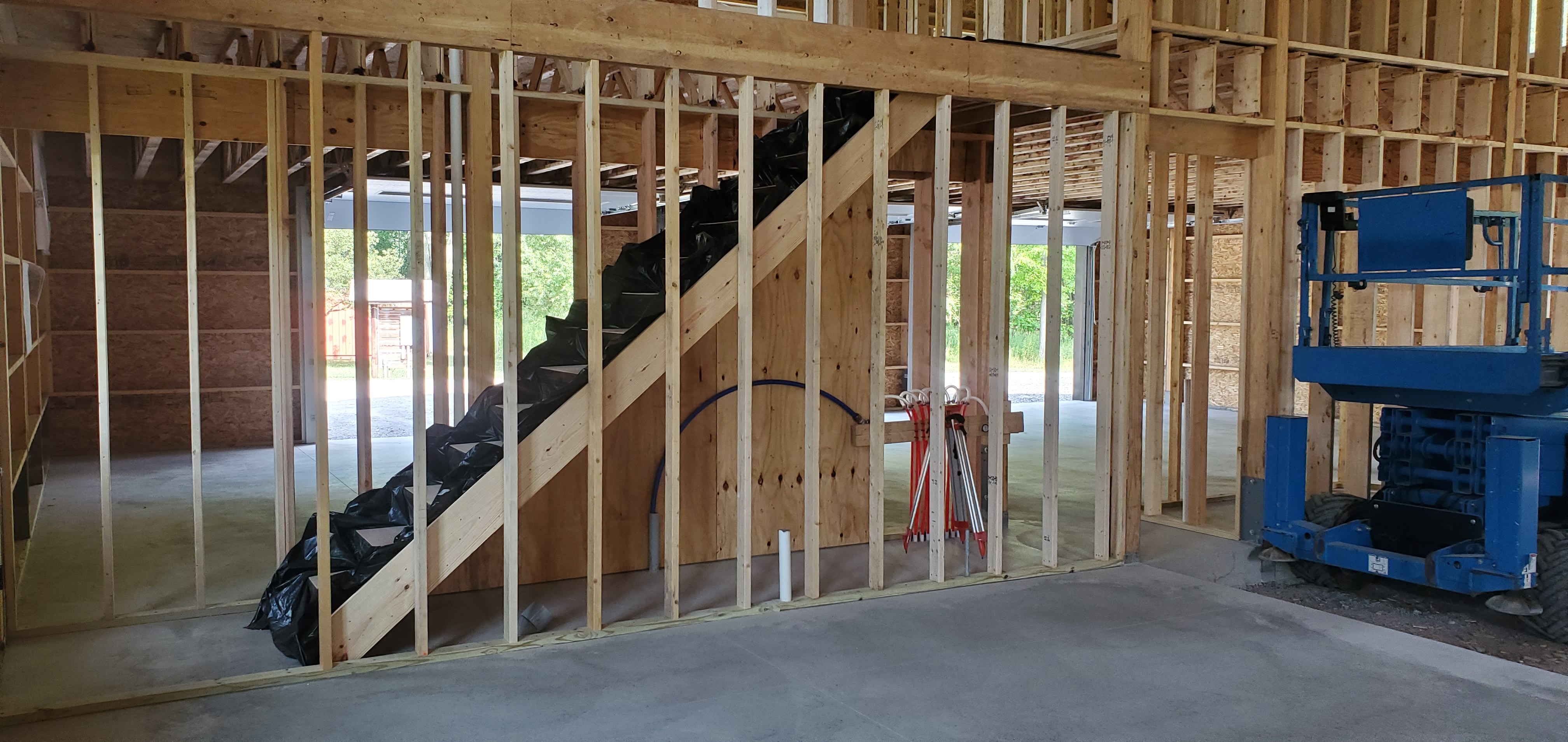

Is that plastic under the stair steps? What does it do?
   / Barndominium/Shop or "real" House? #610
So it's temporary?
