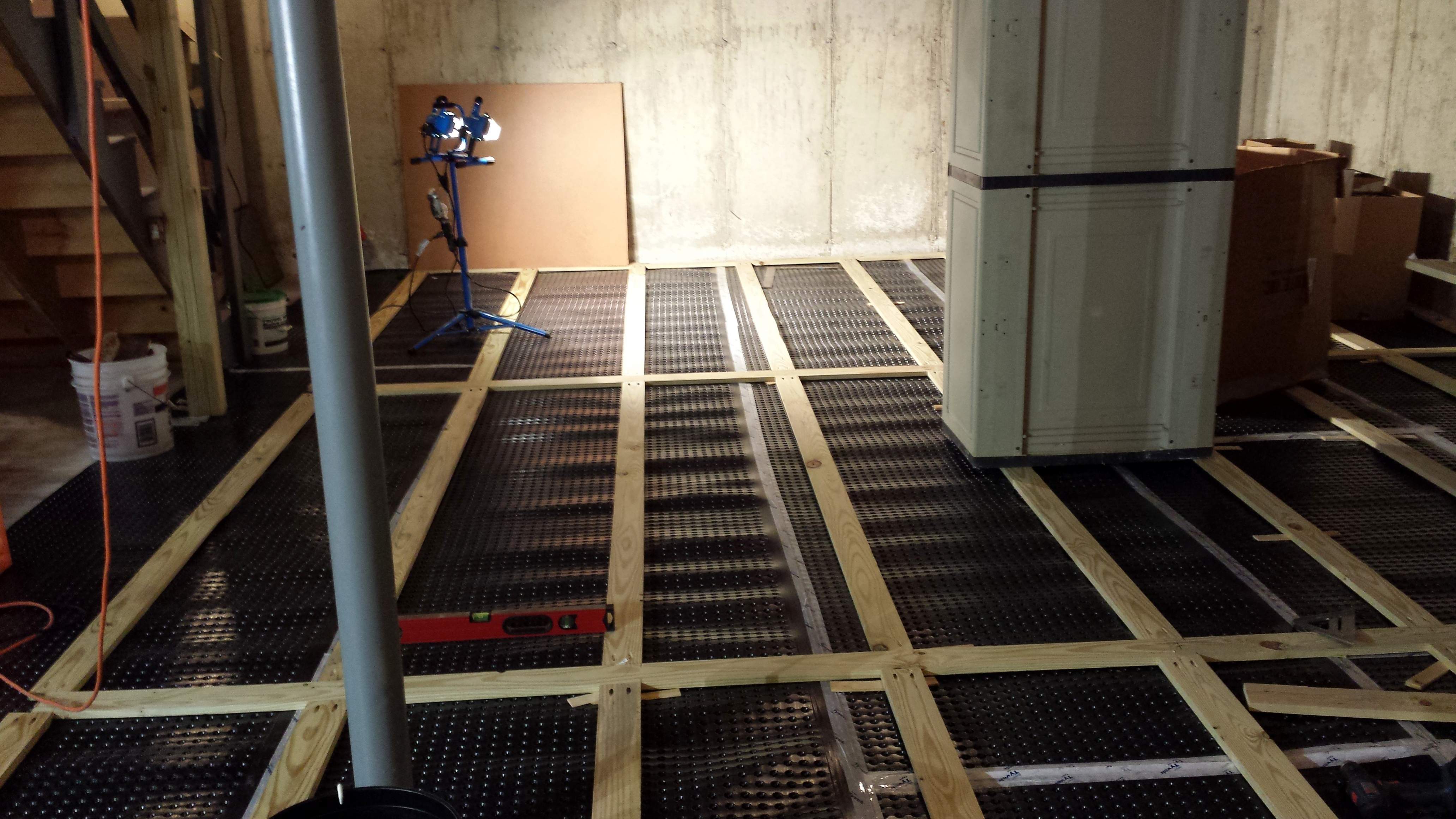

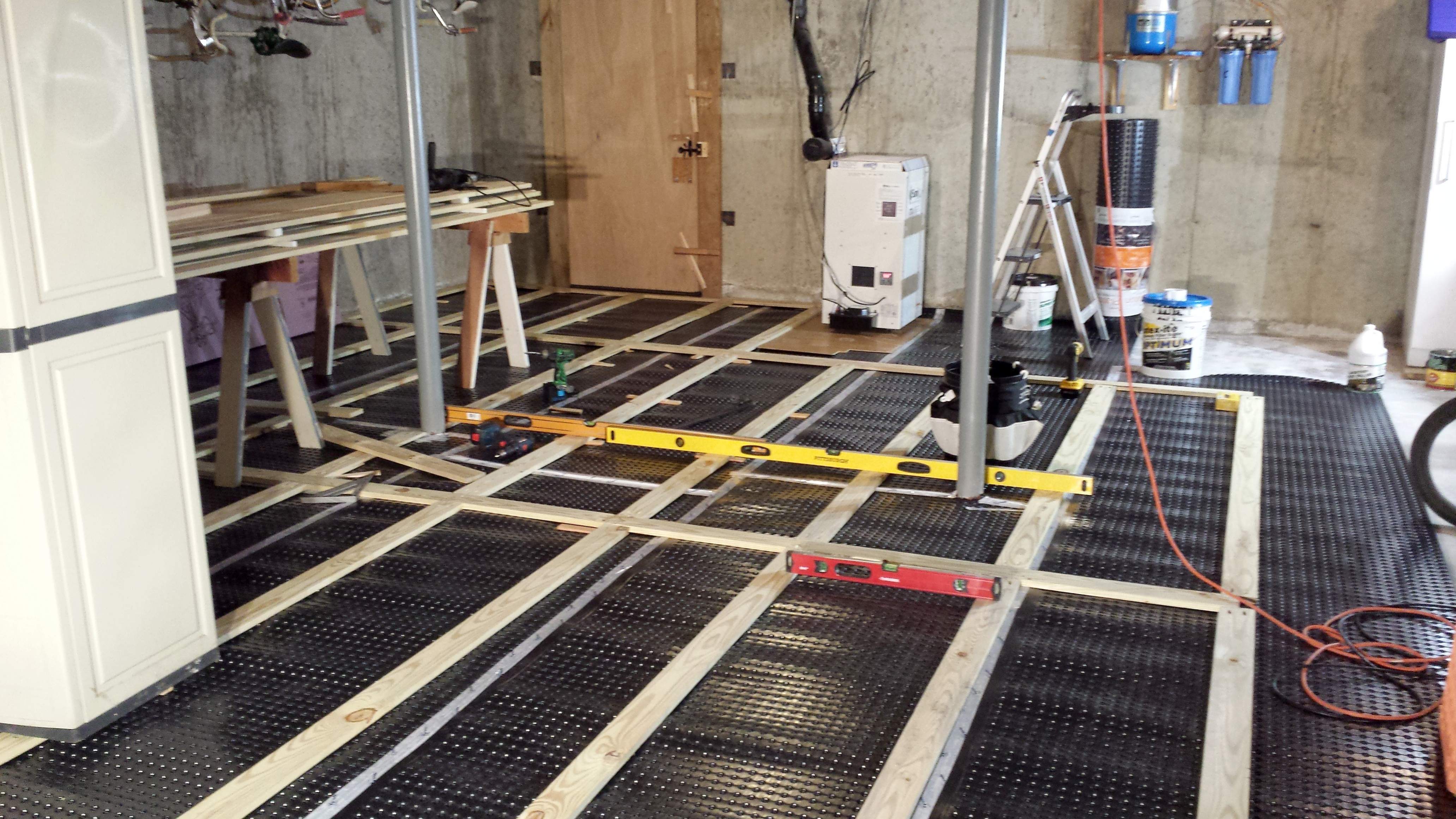

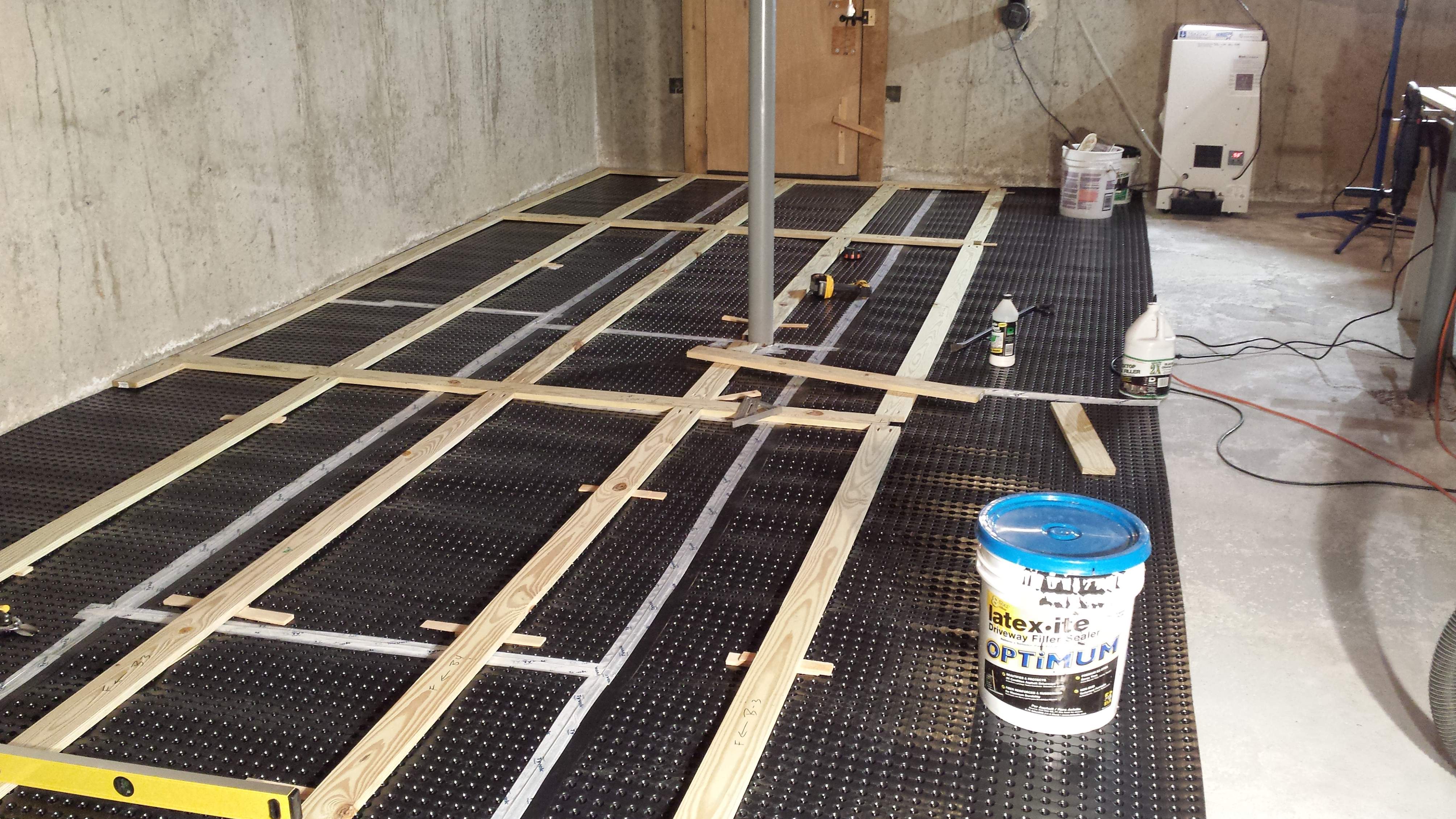

Quick update. Got the Platon earlier this week and started over with that as the underlayment vs plastic. Like most things, it wasn't as easy to put down as the instructions and on-line video showed. Biggest issue is that when you roll it out over 30 feet (in my case), it doesn't roll out straight. Has a slight curve to it so mating one row to the next isn't easy. I had to cut each 30' lenght once or twice and seem it to re-align the mating surfaces. Even then, it doesn't roll out totally flat. And boy, does the black plastic make it seem a lot darker down there versus the gray concrete, but that's temporary until I get the rigid foam and subfloor down.
My other issue is that I don't have room to move everything out of the way so I'm having to work one side, then move boxes, etc., to work the other side. Anyway, I'm feeling much better about using the dimpled Platon vs putting plastic right on the slab.
