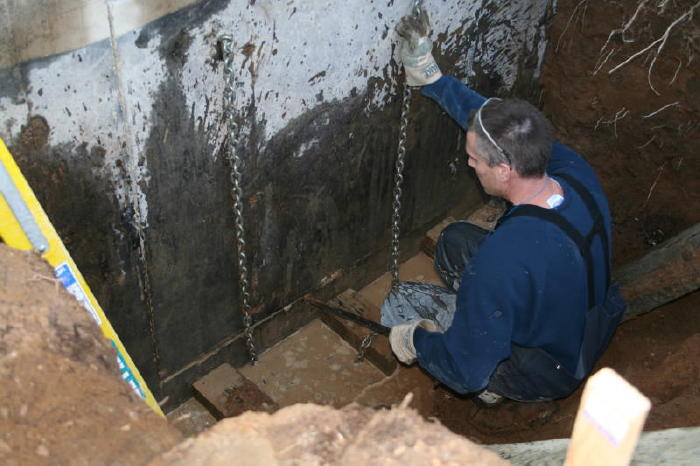

That makes good sense that it couldn't 'tilt' in (or out). And you said you had the ¼" rod in to hold the kerf open too. Missed that first time around.
Good engineering, I must say.

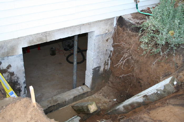

How do you keep the water out of the hole in the ground?

Quite a saw. I can see the advantages over a circular blade, particularly for 8" thick material which you would have had to tackle from both sides with a circular saw.

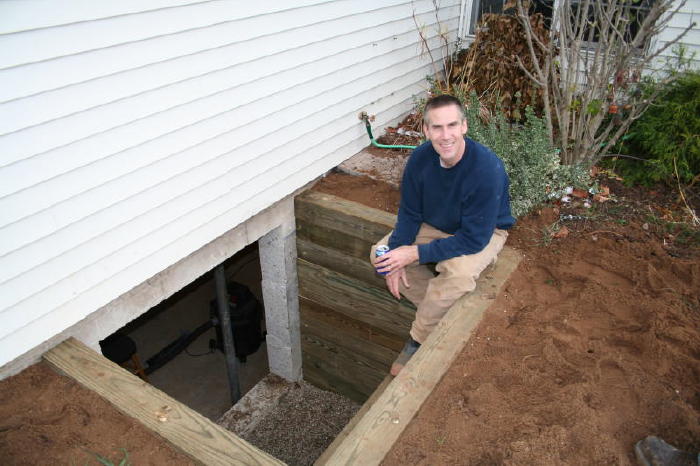

<font color="blue">How do you keep the water out of the hole in the ground?
</font>

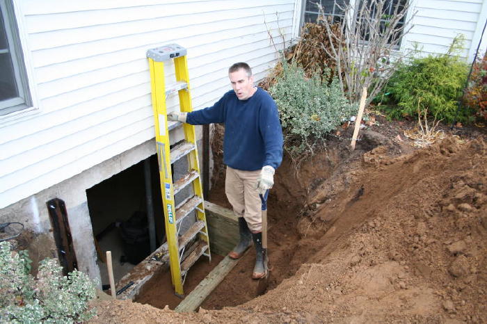

During the cut it got pretty muddy. Used a shop vac a couple of times to get rid of some water. Same on the inside of the basement after the plunge cut.
For rain water and such, that's a good question. We have two similar windows in our basement, installed during construction. Each window well has a drain that connects to the perimeter drain at footing depth.
Mark and I talked about it for his but that meant a whole lot more digging to get down to his perimeter drain. The other consideration is that our soil up here is extremely sandy. Any water that does accumulate will soak down into the soil pretty quickly.

When I was a kid, my father added a basement egress window to our house (so I could move downstairs).
We over-dug the window well by two feet and then filled it back up with rock. This gave quite a bit of capacity to hold water before it runs in the window opening. The water would just slowly soak into the soil.
Also, the grading around the opening was setup to slope away, and a gutter was added to the roof above.

We did over dig this one, but only by about six inches. Put pea gravel in the bottom /forums/images/graemlins/smile.gif

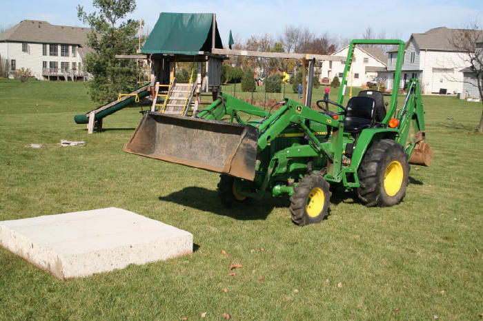

Great project, great use of the tractor, and great pics. Thanks. Sure would have liked to see pics of the tractor pulling that slab out of there. /forums/images/graemlins/smile.gif

<font color="blue"> Sure would have liked to see pics of the tractor pulling that slab out of there </font>
You know, at this point I'm glad there WEREN'T any pics of that. It couldn't have been pretty. I could see from my seat the top edge of my bucket was bowing down pretty good and we did stop to add air to my front tires. They were very close to rolling off the rims. Fortunately, it was all done VERY slowly so I could see what was happening all the time.
Today we calculated the slab to be about 2030 lbs and my loader lift is something like 800 lbs. Of course, I wasn't lifting it straight up, more of a lift and drag move.
