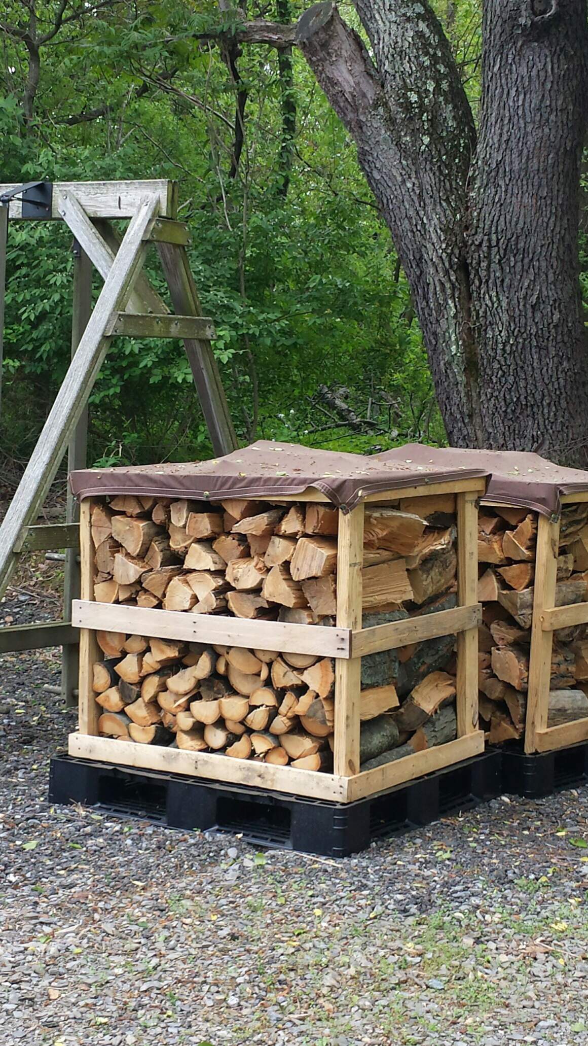

Here is my version.

   / Basic firewood rack. #23
I'm wondering if one side could be notched or otherwise have a section or part or the side removed for access?
The openings all around the tote allow you to reach the wood to raise it up over the top or just pull it through the sides.

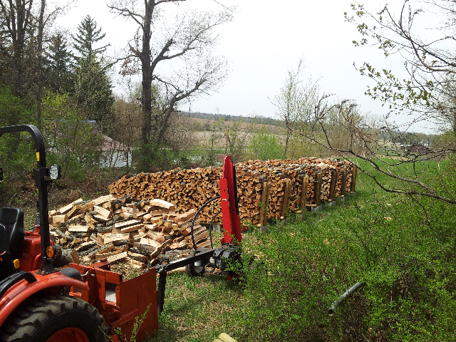

   / Basic firewood rack. #26
I do like them better than using t-posts, or cribbing the ends and they take down and set up nice and easy. And they can easily be made into 8' racks instead. The only downfall is moving from the drying area to the winter use/storage area. But i wouldn't want to try to move a whole pallet with my little kioti anyhow. So i use the trailer and just have to re stack. Another nice thing is the timbers are about the same cost as treated 2x4's in this area and the box stores usually put them on sale every spring. Lowes here just had them at 1.87 a piece so i stocked up.
This is them in use in one of the drying areas.
