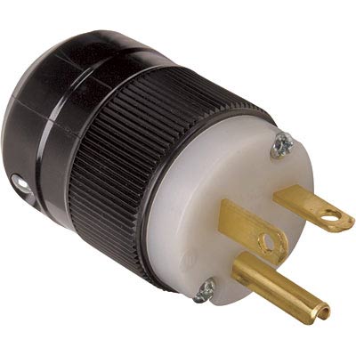

Bath room electrical related question,
Regarding 20 Amp GFI, of course 20A outlets have a T-shaped nuetral slot WHY? I have never ever seen a male cord end with that T-blade. I'm a contractor 28 years, have all kinds of tools, work in churches, schools, hospitals and Govt buildings and have never seen a T-blade corded appliance or tool.
Also since 15A GFI's can be wired thru with 20A isn't it actually rated for or built like a 20A? besides the blade configuration and can they be used on a 20A circuit. I'm sure you couldn't use a 20A GFI on a 15A circuit though.

they make both 15 amp and 20 amp gfci receptacles. for commercial we have to use 20a. for residential, no one seems to care.
the t-shaped receptacle fits a plug as shown in attached picture. a true 20 amp, 110 volt plug has one terminal at a 90 degree angle to the other.
Yeah, I said t-blade, that was wrong, I've seen those at supply house, just never on a cord.

the t shapes 20 amp recepticle is set to accept either the regular blade OR this 20 amp blade. thus the t shapes.
