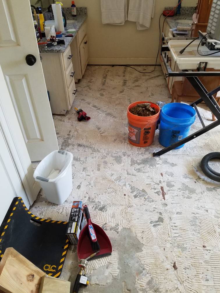

Eddie Walker, would you use self leveling compound over this or just tile over it?
I think you have done ALOT of remodels and tiling, figured you would know the best way.
I have used the self leveling compound once. Its expensive for what you get and kinda a pain, but it did exactly what I needed. 20190224_094510.jpeg
   / Bathroom Re-model concrete foundation #33
I have used the self leveling compound once. Its expensive for what you get and kinda a pain, but it did exactly what I needed.View attachment 593663
I would scrape and/or grind it all off. For a big area like yours, renting a floor grinder would get 90 percent of it off in a few hours. Then the areas around the cabinets would have to be done by a smaller grinder, or chisel end on a SDS rotary hammer.

Thanks, I figured you would know.

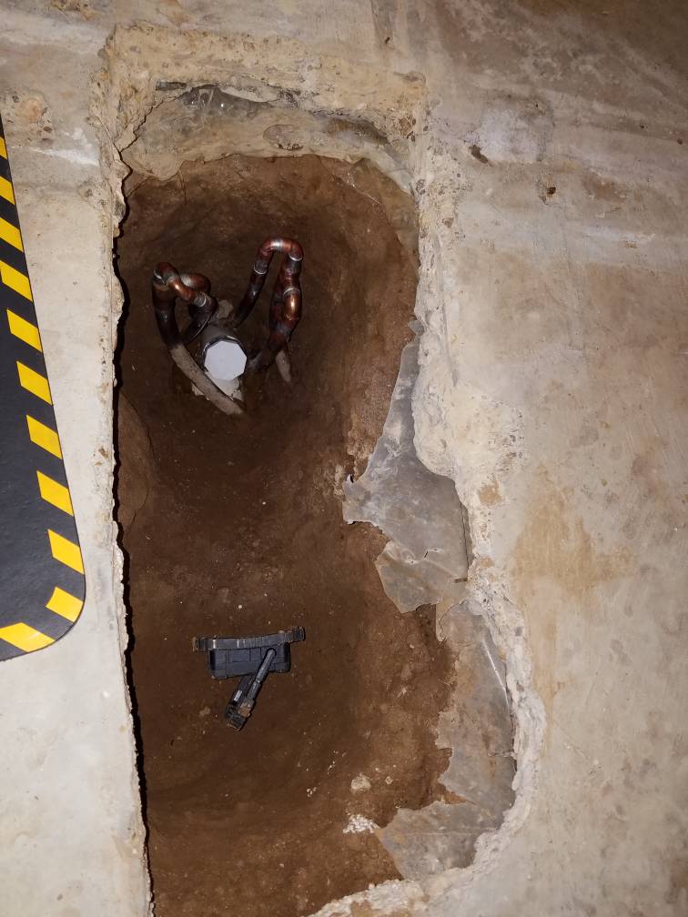

This is what's left of the shower I removed. Plugged the drain/vent off where it teed off. Shortened the copper pipes below grade.
Been framing, wiring, sheetrocking and painting.
