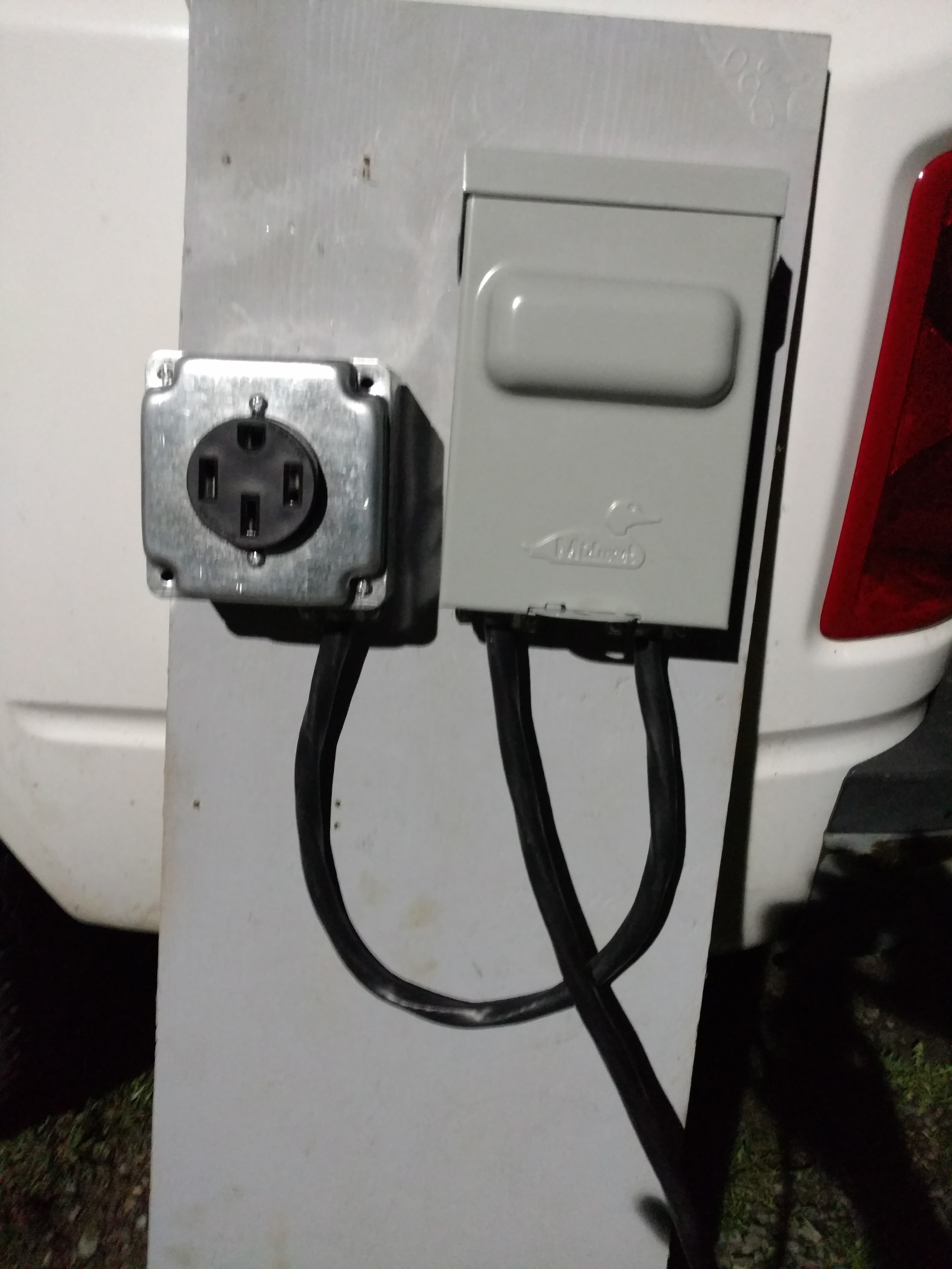

Our Mustart 40 amp 220 volt cable for the Nissan Leaf built in battery charger came in Friday. Since the location where I am keeping the charger is not its final home I used this board laying around and lagged the boxes to it to make a move to another location go faster. Now the 6.6 kw charger gets triggers. The 120 volt factory charger takes 20+ hours. I went with 8 gauge wire just because 40 amp is the trend for newer EV's.

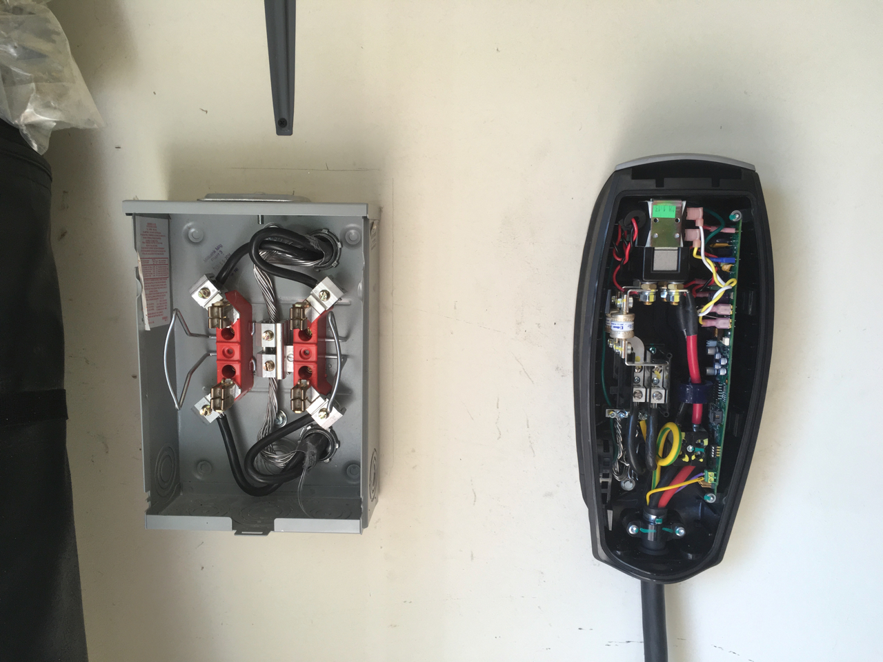

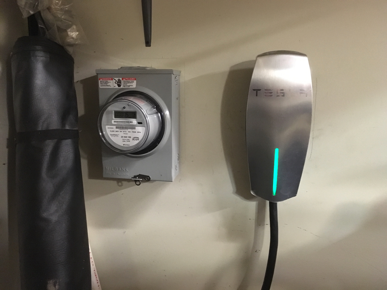

A meter box is about $35 at Lowes and digital meter $25 on eBay:

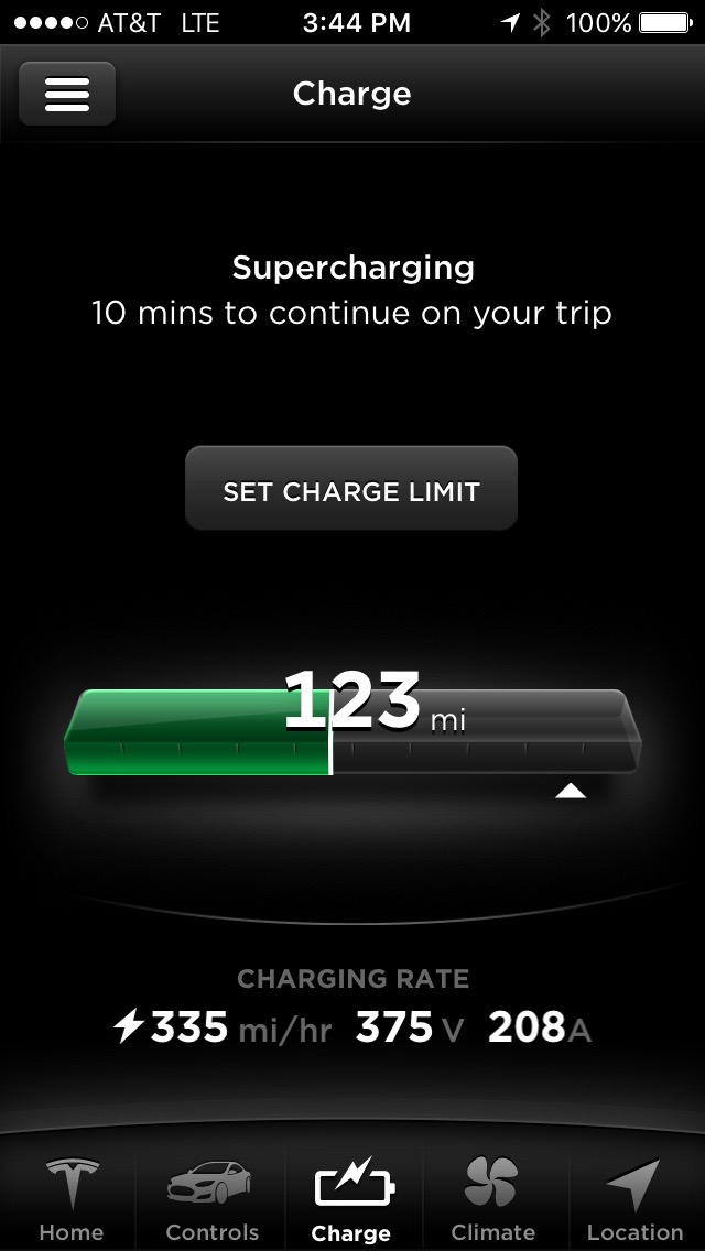

Tesla app at a Supercharger:
